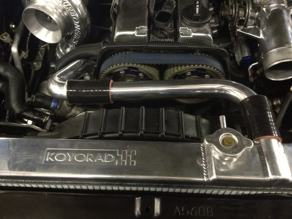

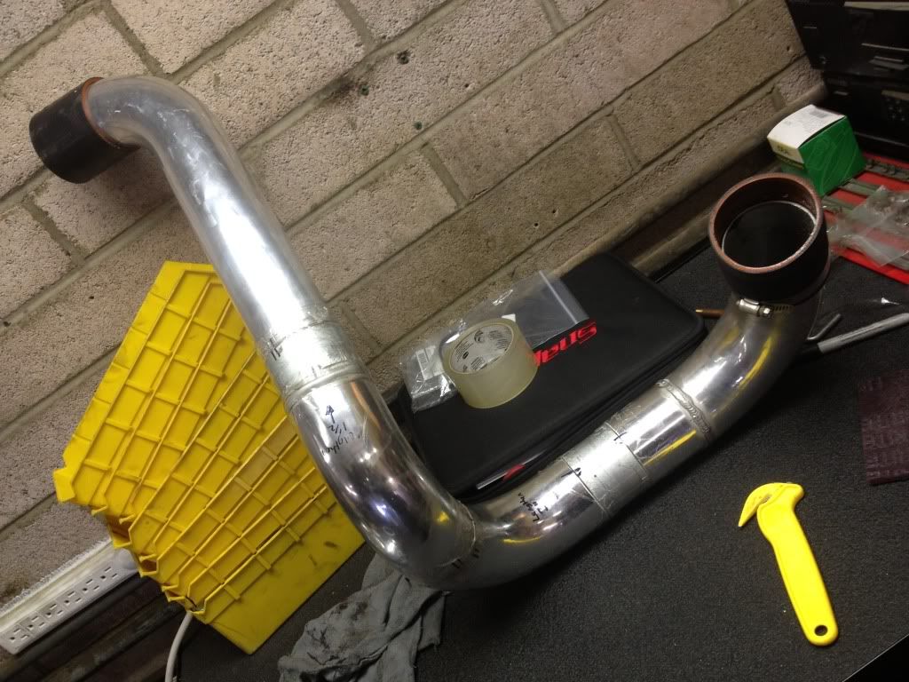

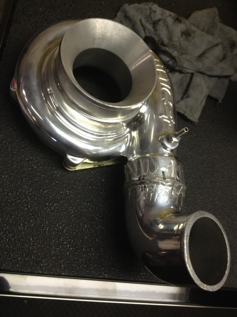

Have fixed some things, modded IC piping for power steering and AC. Also made it 1 piece piping to limit couplers.
Rotated the elbow on compressor housing to get fitment better as well as off the exhaust manifold.
Cut down supplied elbow for the upper radiator pipe. And polished to match.

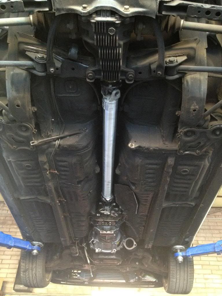

Little things happening, working on the fuel lines and my 4" exhaust should be made soon, I got my one piece aluminum drive shaft, it turned out great and uses larger knuckles from a chevy iirc.
