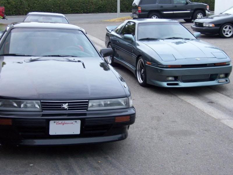

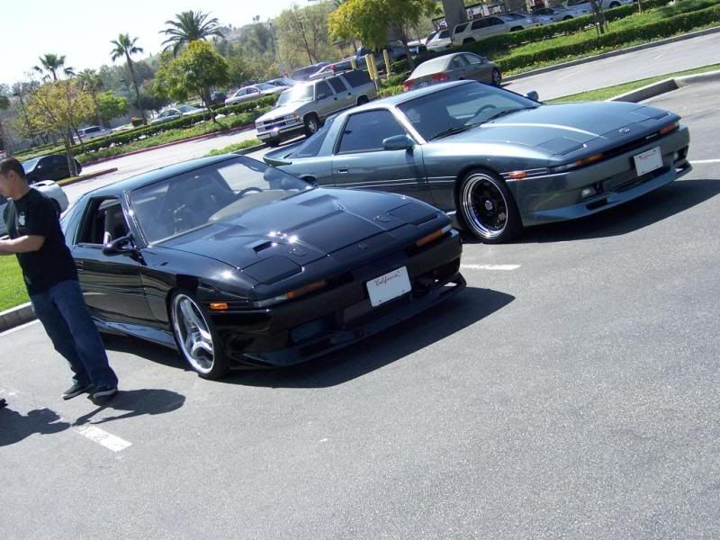

SuprA70's Supra is just that:

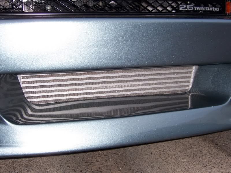

Along with a modified front air passage:

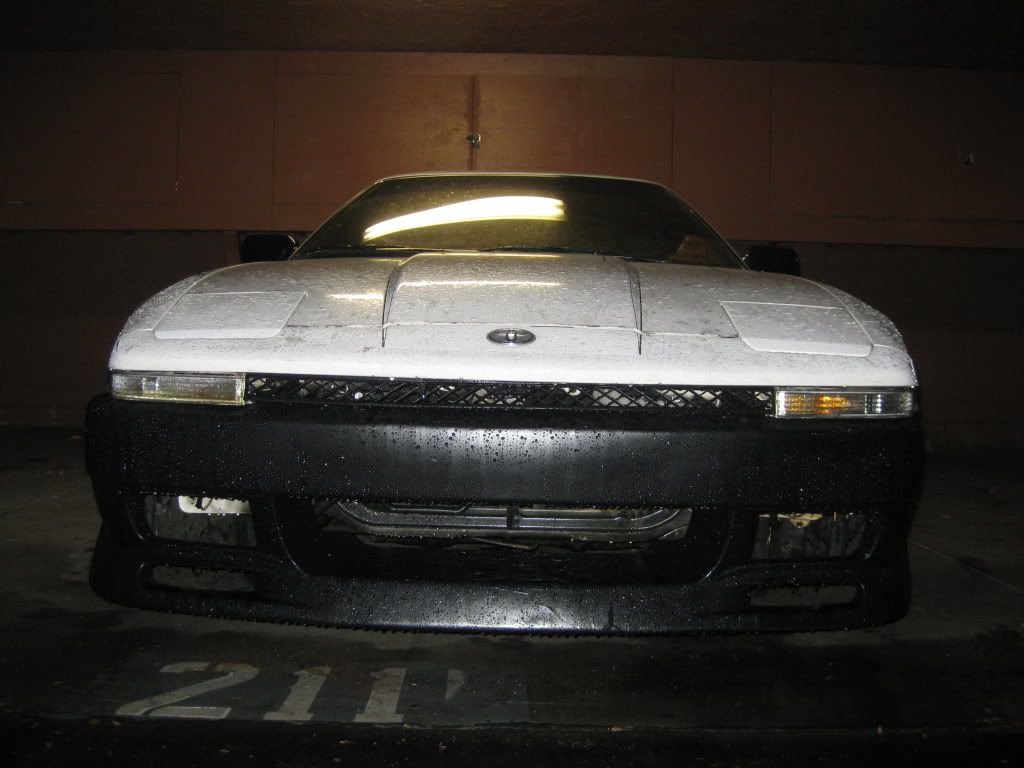

here's my updated pre89 front end pics... since i smashed my bomex pre89 dual hole lip, i have decided to cheap out until i get my greddy bumper. so here we have my $4 home depot lip reinforced with a steel strip to give it some rigidity.
Dude tell me exactly what you bought and how you mounted it. I think that looks better then your 2 hole easily.

Two options: weatherstripping or garden bed/lawn liner (I think that's what it's called.) The weatherstripping is more rubber like material where as the garden bed liner is a tough rigid plastic.
Use STRONG double sided tape and stick it to a metal strip that can be bent to the desired shape. Fold the top edge of your lip in to make a flat mounting surface, and secure it using the same hardware as your stock lip, including metal strips. That's how I did mine.
I think that rather than bolting his lip up to the stock lip location, viper92086 appears to have stuck it on there with something similar to the STRONG double sided tape that I referred to above. This works too, but raises the lip up above the stock mounting location. This looks fine on darker colored cars, IMO, but messes up the lines on lighter or brightly colored cars. It looks great on his with the black skirts.

I used the 3m gray double side tape. this stuff is insanely strong and im sure it will pull off my paint once i take it off. i'm using it to hold on my rear visor and i messed up when i was putting on one of my brackets and i couldnt get it back off. Like gotboosted said, i doubt something like this would look good if you dont have sideskirts to match or if your car is too light colored. but if you dont have a lip you really have nothing to loose. The stuff i used is called cove base. you can find it in the flooring section of homedepot. its that stuff you find along the floor and wall of commercial buildings.
BTW there is a guide floating around here with someone else who had done it and made a frame behind his cove base lip and thats what i followed. altho i used a wider metal strip to create this frame.
