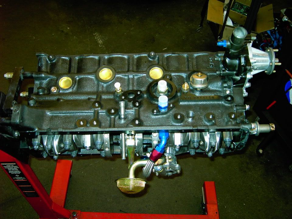

Stroker custom crank, adds 6.5mm stroke, on 327SBC 6" Pauter rods with 2" journals, ROSS pistons and everything is coated.
Oil system is custom, has AN10 sized fitting from the pump, to the main galley, uses Canton full flow filter, and Autoguard bypass filter.. 3 quart Accusump in the hatch area... and Rx7 oil cooler with thermostat..

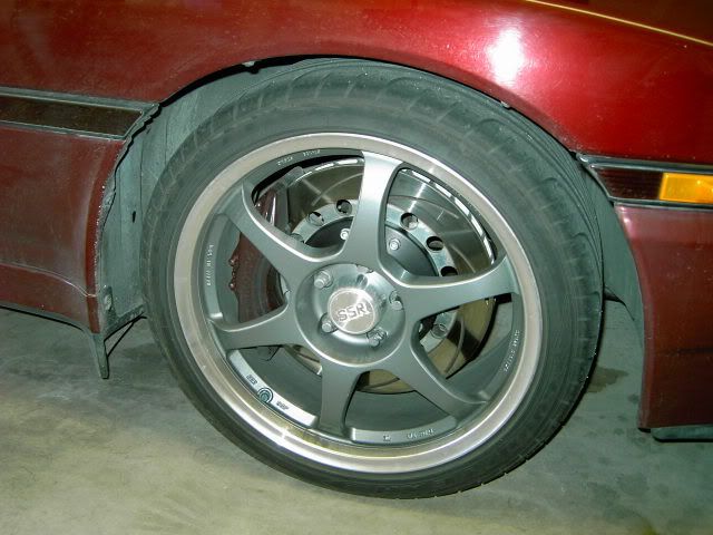

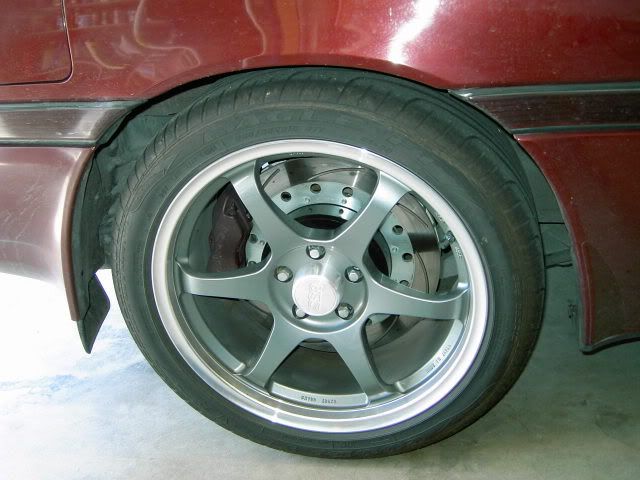

Brakes are completly custom.. 14" rotors front and back, 6 and 4 piston calipers as well.. (Only fully functioning parking brake hats I know of in this country.. and only full setup I know of in this country that PB sold here.. Only three in the world that I know of.. anyone else have the full kit? :))
Wheels are SSR Comp's in Anthracite.. only ones on a Mk3 that I know of.. Got them because they are light, and fit over the BBK.. Tires are GSD3's.. best tires I've used yet.
Here are a few photos. :) I really need to get this dang thing going again, or just sell it. ;)

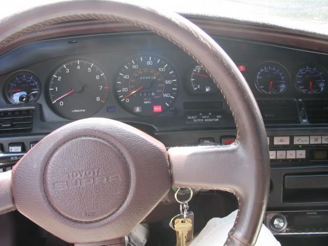

Yeaaah you did! I used to have some rare pieces such as an original TRD hatch sunshade. Only real custom, i.e. can't be bought, thing at the moment on my new supra is the gauge cluster. Prosport gauges, bezels painted semi gloss black(along with the cluster bezel), holes drilled for the push buttons and finished with rubber surrounds. Also painted the stock needles red to match. Wish I had the time/space/talent to weld up a few custom pieces...

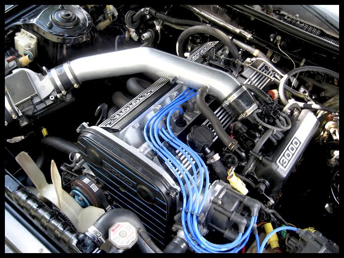

6MGE engine; was never available in the US, utilizes a 7MGE crank pulley and has the very rare TRUST header

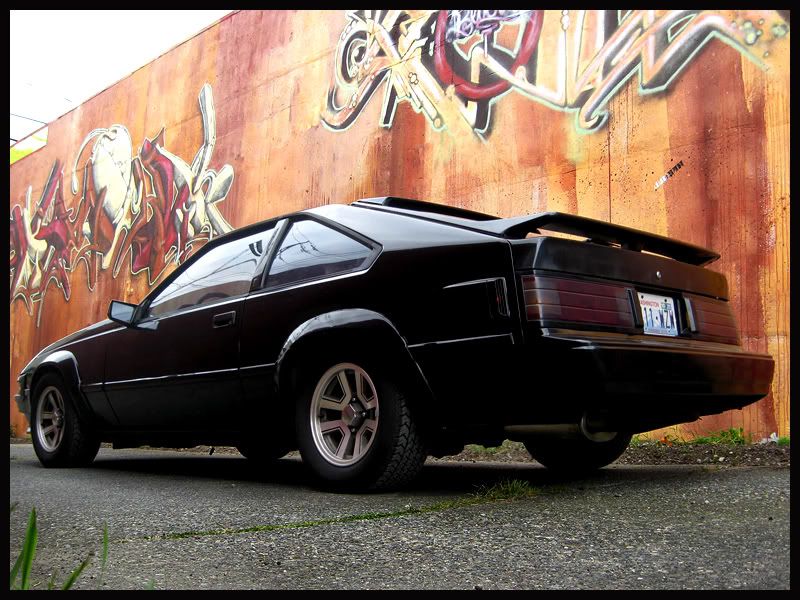

Custom made clear turn signals, tinted nose badge & a 3.0 TwinCam badge from a MZ12 Soarer
Tinted tail lights, JDM rear marker vents and tinted B pillar badges
