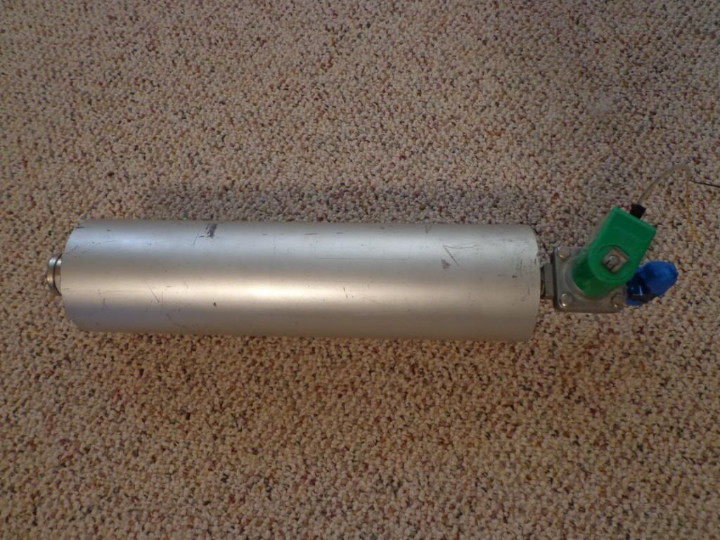

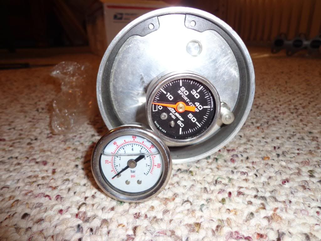

This is actually IJ.'s old Accusump, so yes. 3 quarts, electronic pressure solenoid, and I guess he rebuilt it a bit before selling it. Didnt even know it was his when I bought it. No matter how confident I am as a 7M owner, it certainly wont hurt!

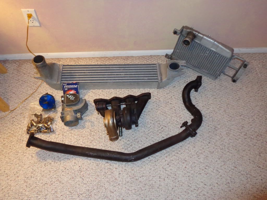

I'm actually reconsidering waiting on the ITBs/FFIM. I might just make a sheet metal intake, then research the CFD it really should have later.

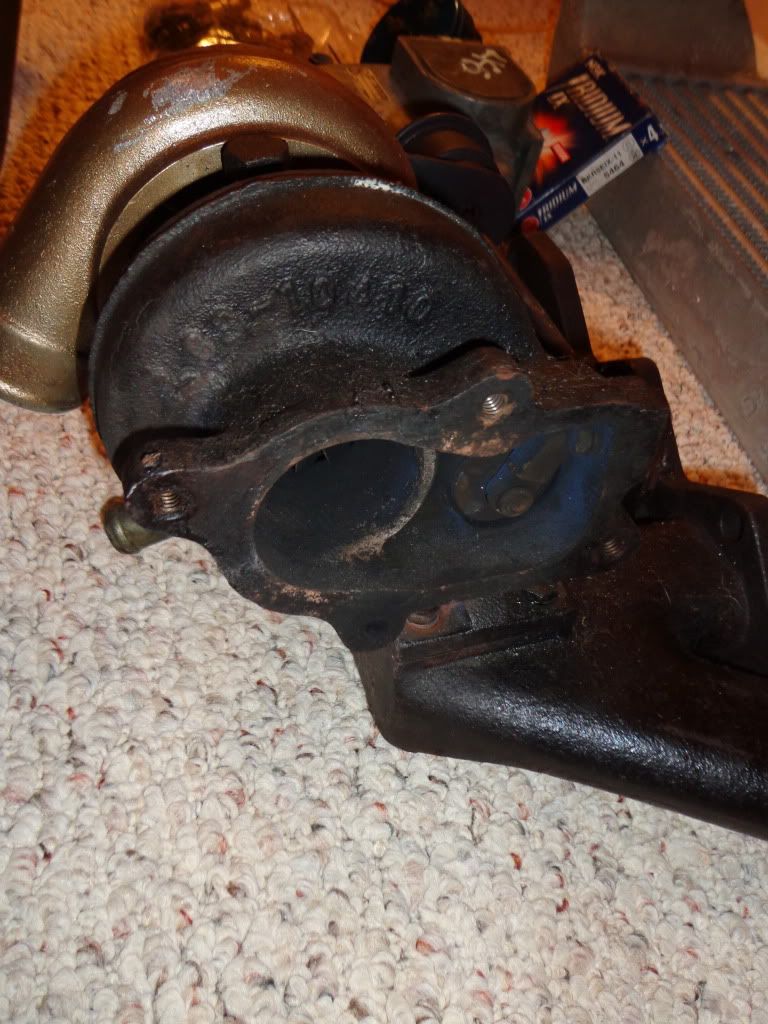

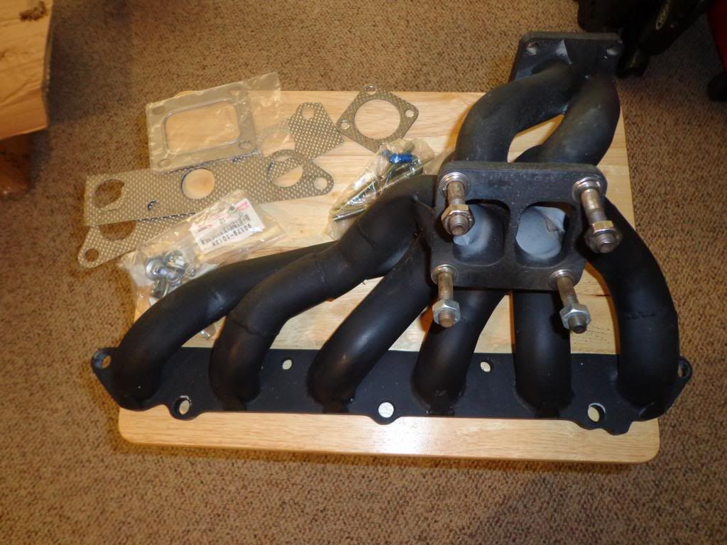

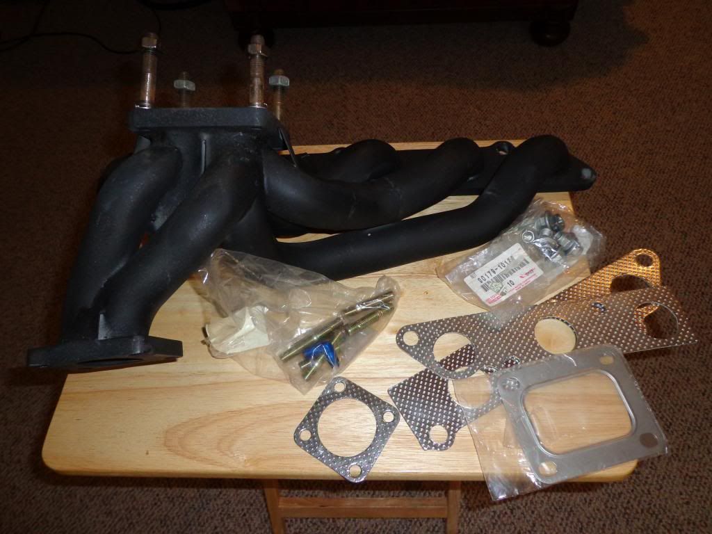

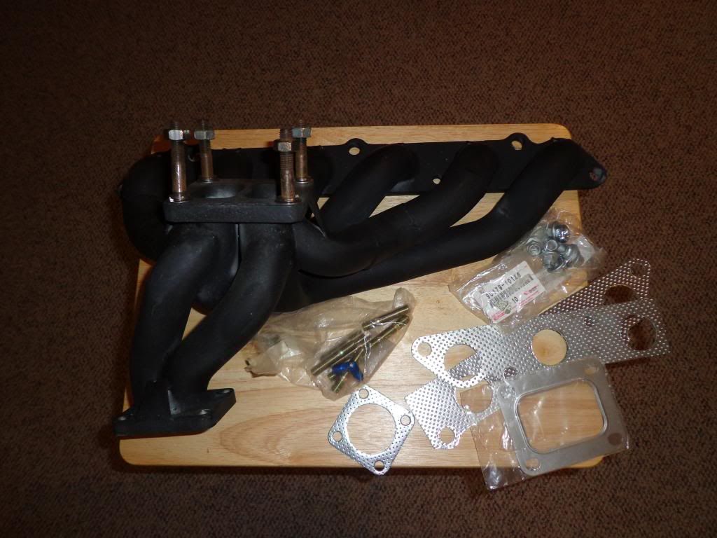

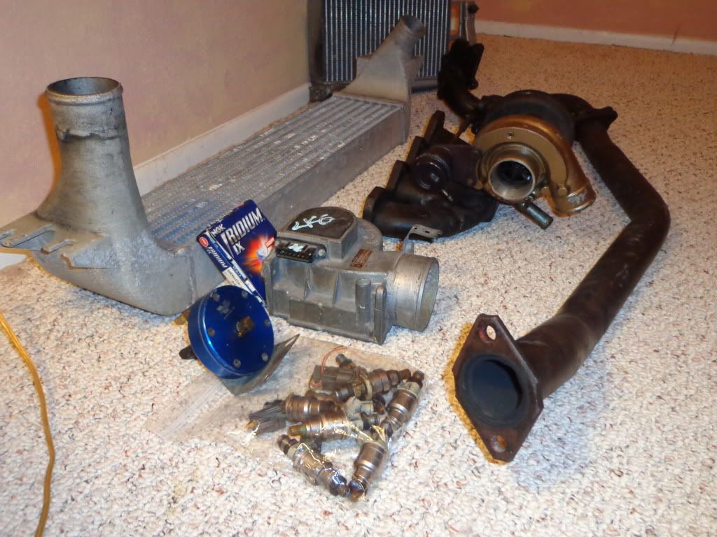

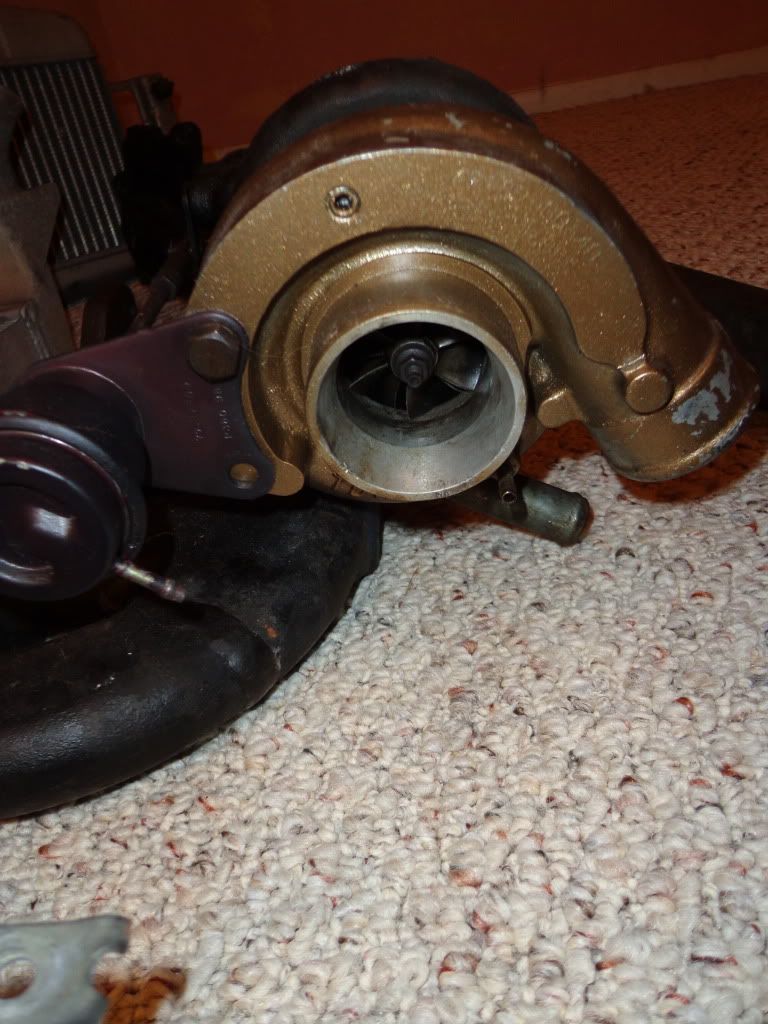

In the mean time, I got a killer deal on all of this:
I know for sure I wont be using this wastegate flange. Hopefully I'll get it to fit with an adapter. Originally I planned on cutting off the flange, but I'm not so sure thats the best idea

I love it too! I'm just hoping it fits fine without modding it. It looks even better in person than in pics, really a solid design.
