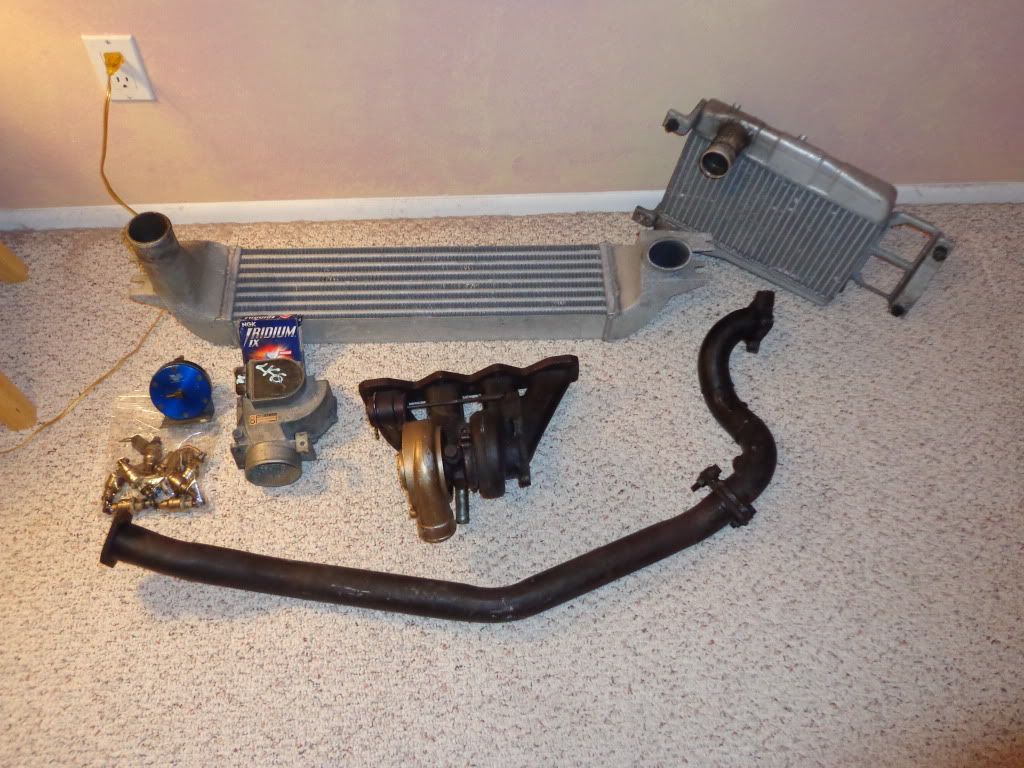

Oh, and a slight delay in getting the Supra back on the road, since I picked this up for my Miata -_-
well, isn't that just CUTE!?!?! lol, sry I found it hilarious how dinky that turbo kit looks... I have no doubt it will do the trick, I'm just easily amused, and sleep deprived ATM :rofl:
definitely will be keeping tabs on your build though.... quite intriguing :naughty:

It's absolutely cute! I dont think it could make as much power as a stock 7M on that setup. I need to sell off the MAF, manifold, downpipe, and turbo since I cant use those anymore. Dont know that I'll use the FPR either, doesnt make sense to.
Anyways, I've always just wanted to get the car running, but at this point I think it's going to be pretty far away and a huge "kind of a big deal" build..
