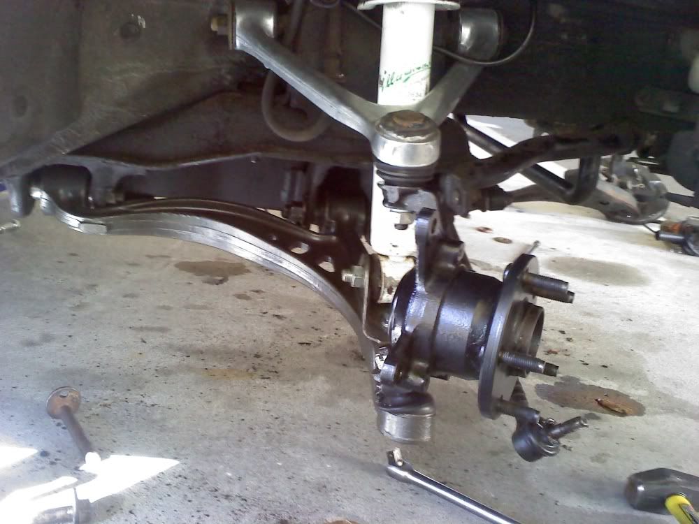

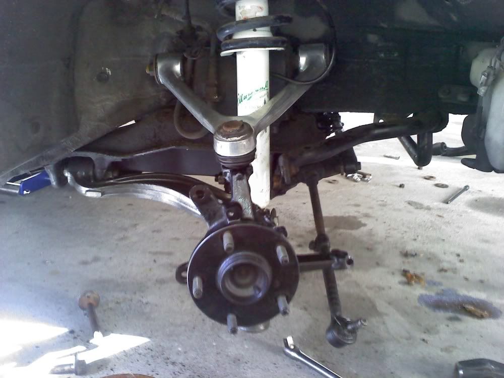

yes, there is a castor issue. 80% of it can be fixed by flipping the UCA's... left to right, right to left. The picture below shows the end result of doing that.
So how can it be fixed? Custom UCA's is the only way. I will be making a set that will adjust castor (side to side) as well as camber.
Another picture.
Another issue is the tie rods, stock ones are too long, causing a massive toe problem. Whats the fix? shorter Toyota tie rods... havent located a set yet, but I am sure I can find one that works perfect.
Custom bushings? The SC bushings/metal dowel that the camber bolts go through are shorter. I will be making custom bushings that are the right size so there is no slop.

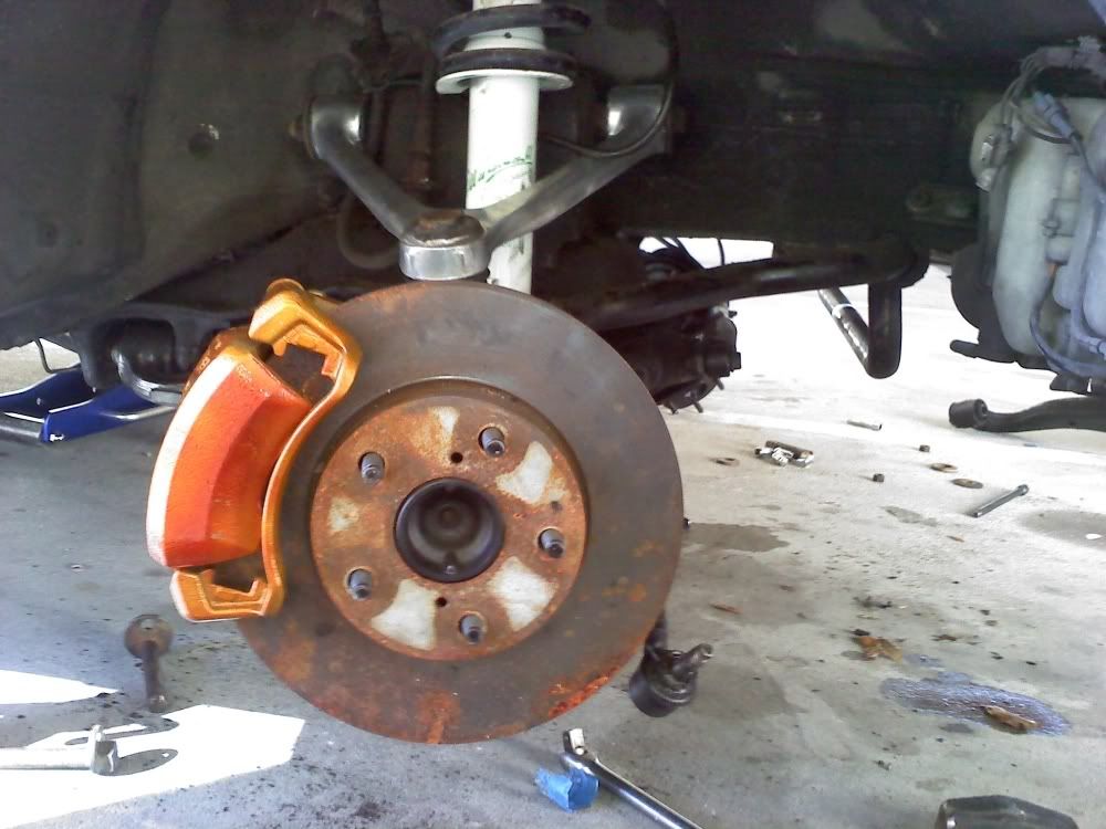

BRAKES! This is the best part IMO.... 2 piston SC brakes is an upgrade as is... but... you can now add MK4 TT Brakes or 95 +LS400 Brakes, which both are 4 piston!
Picture of some bright orange SC400 calipers on the MK3

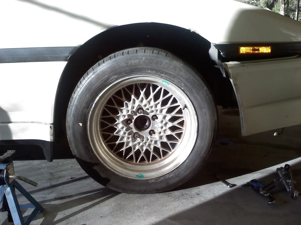

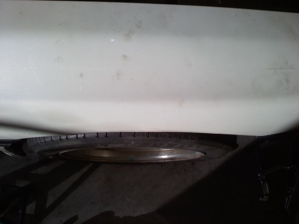

The SC spindles allow the wheel to sit about 15-25mm inwards (sunken). So this is good for people who want to add a 25mm spacer to clear BBK's (me) or people who want a MORE aggressive front wheel... well now you have the chance.
This is a pic with positive camber... I didnt mess with any of the camber bolts. Hard to tell in the pic, but they are sunken in.

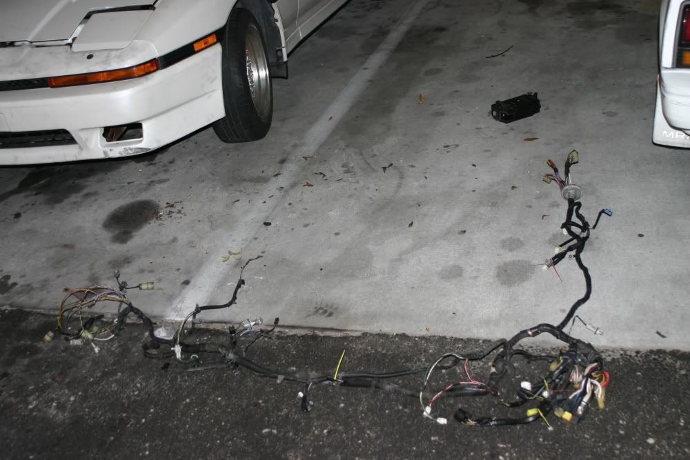

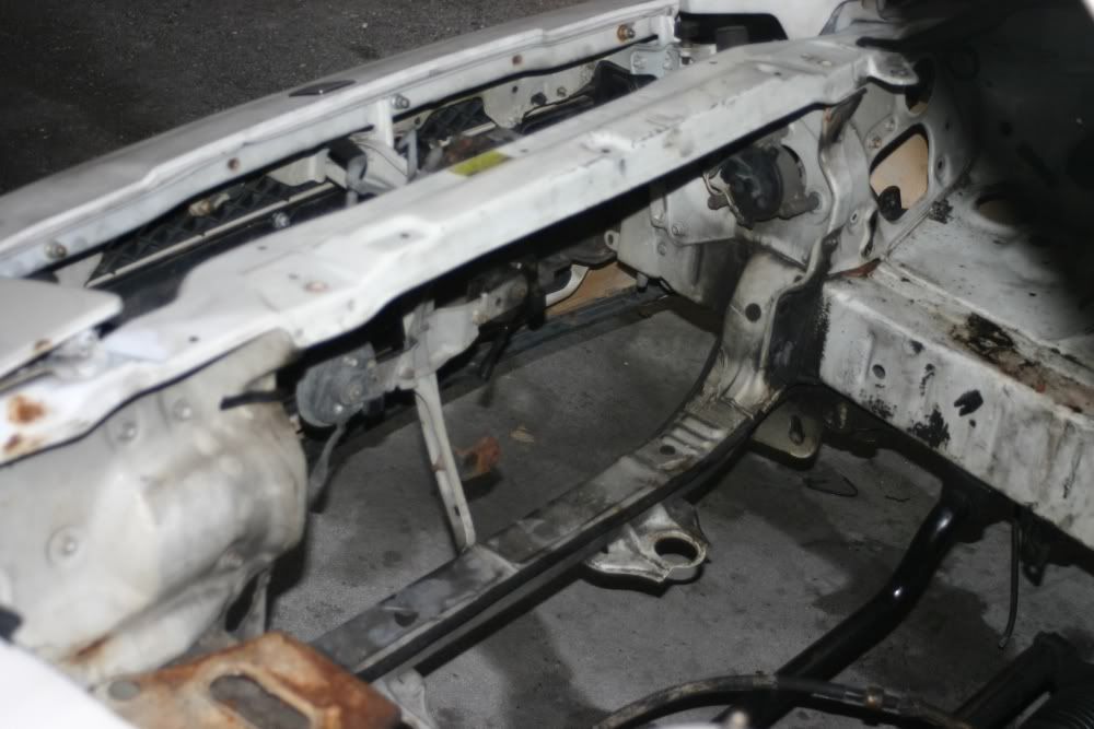

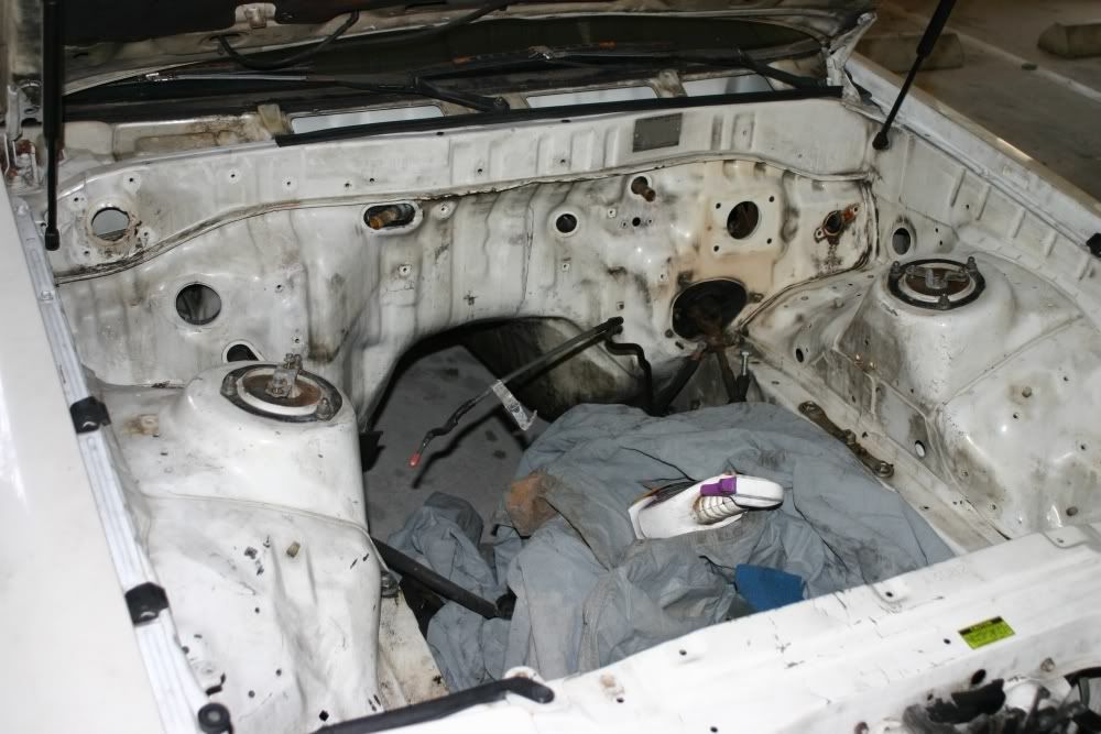

Pulled MOST of the body harness so I can paint... Any suggestions to take off the wiper motor?
RedPhoenix
Kill it with fire!
Sep 23, 2009
222
Tampa, FL
Yea that thing is seized. Its been soaking in PB Blaster for 2 days now, all that it results in is bending and tearing the firewall.

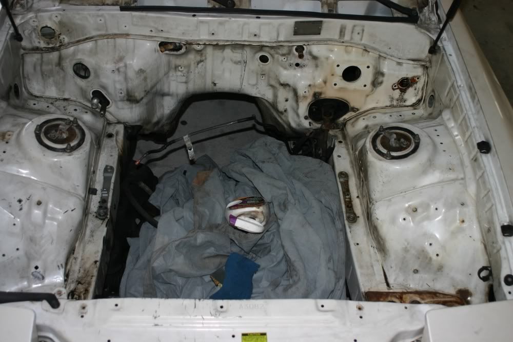

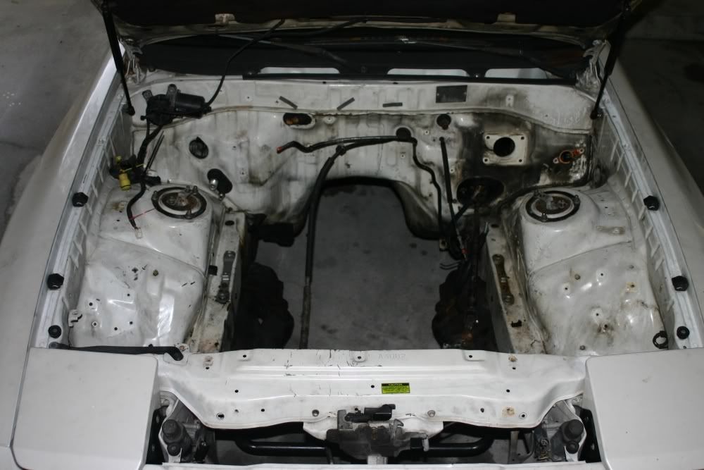

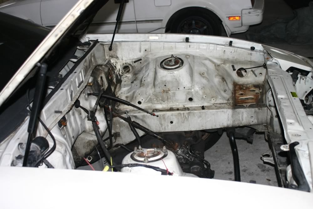

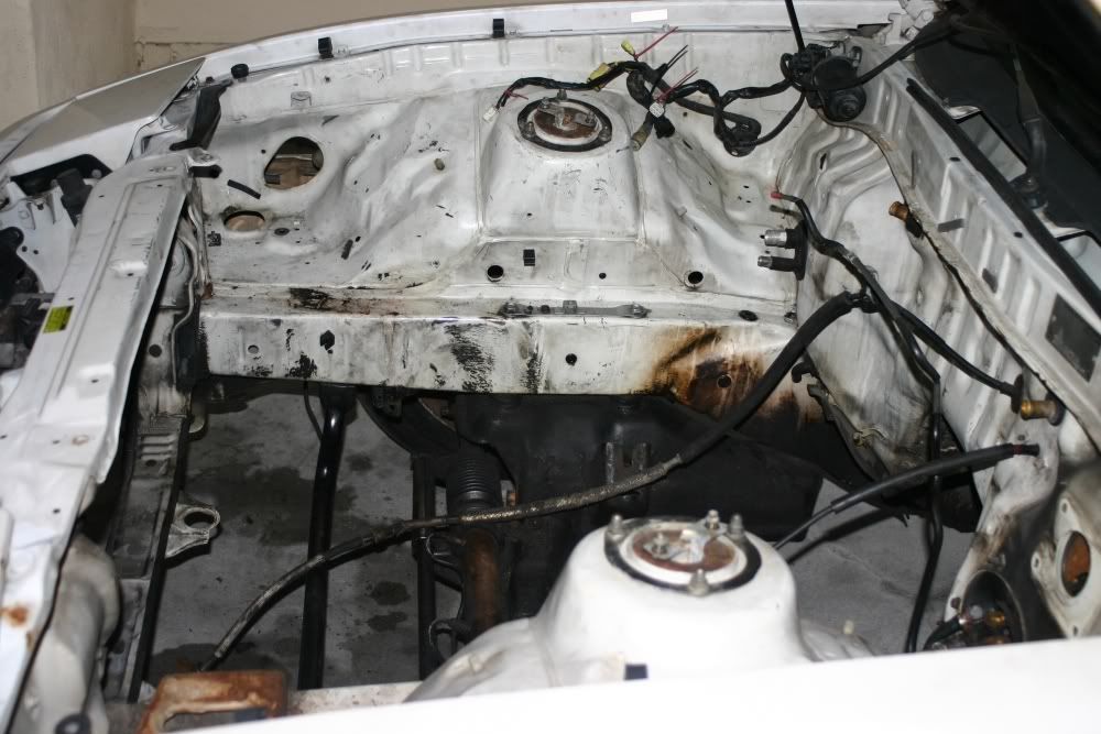

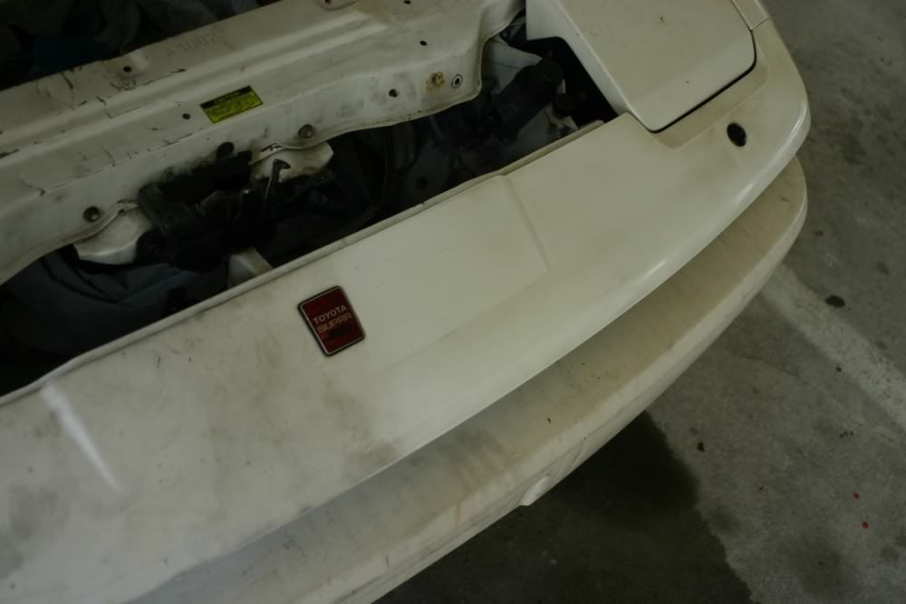

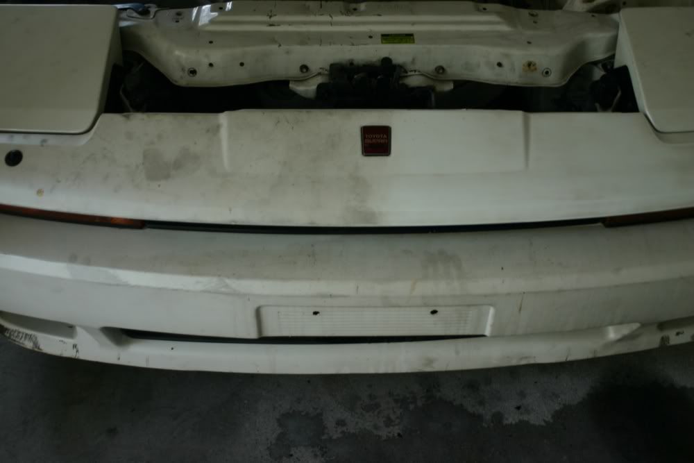

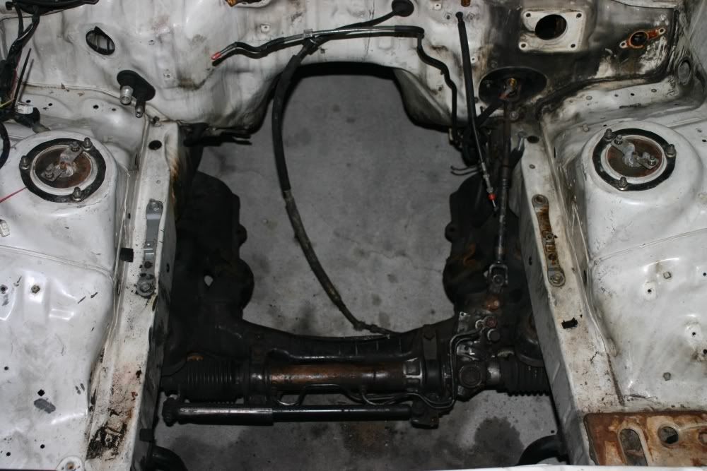

Little update. More stuff removed... started to degrease the engine but it was late and I didnt finish. Also for fun, I started to wet sand the front bumper to see if there was anything good under the ruined clear coat.... and something was there!

honestabe;1509876 said:
Keep at it man, you have a lot of work to do. Are you going to repaint the engine bay or just clean it?
Yeah full repaint, the engine bay is trashed paint wise... and the previous owner had an open DP blowing all over the frame rail.
Im thinking gloss black with PPG paint...
honestabe
Happy as hell :D
Jan 15, 2006
3,713
Mount Vernon, WA, USA
Are you going to fill in/weld shut all the unused holes and redo the seams where the goop was applied? It'd look really nice if you did.

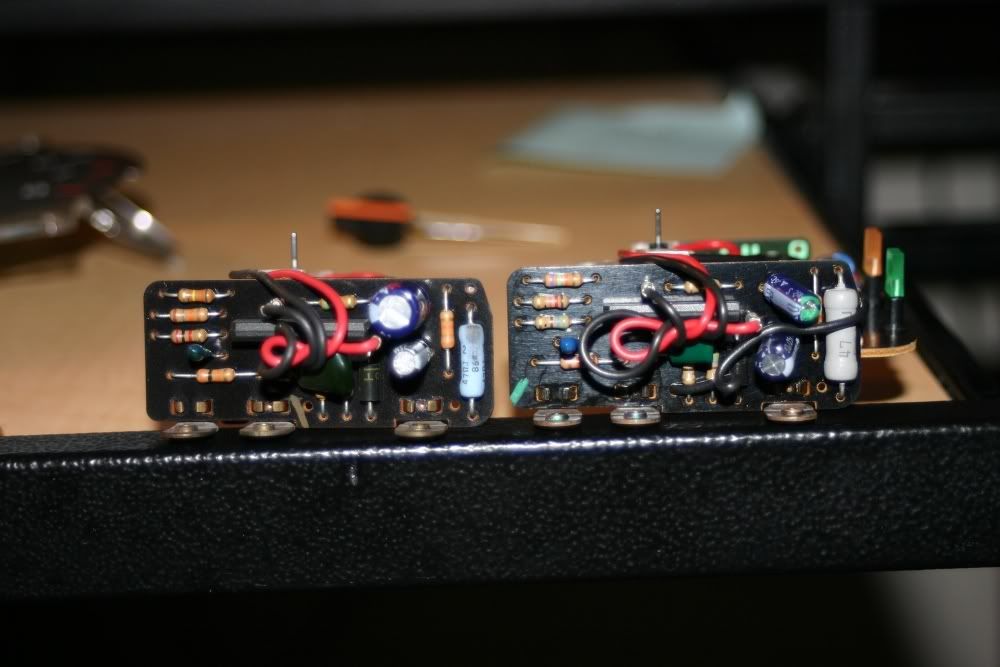

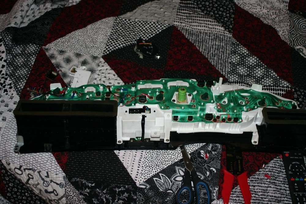

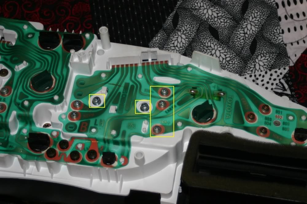

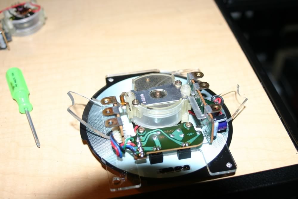

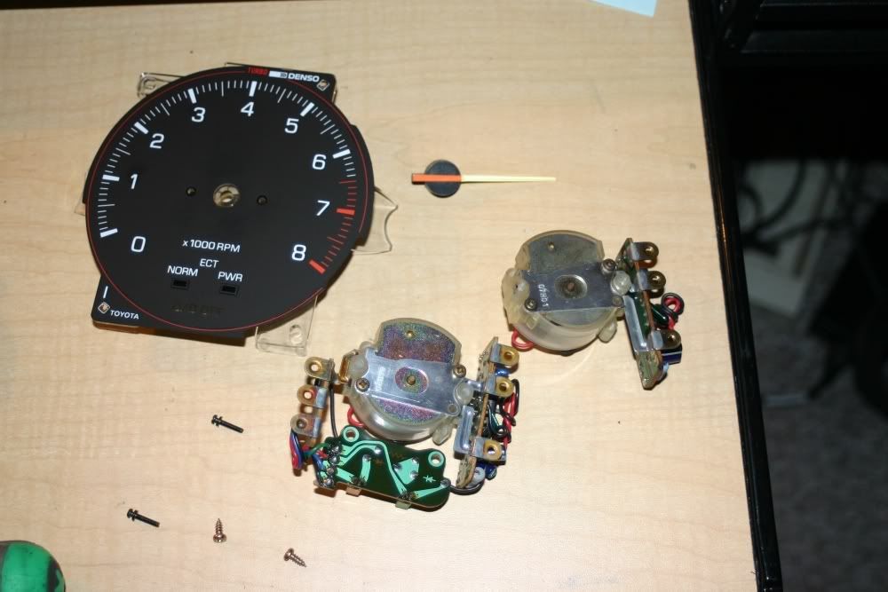

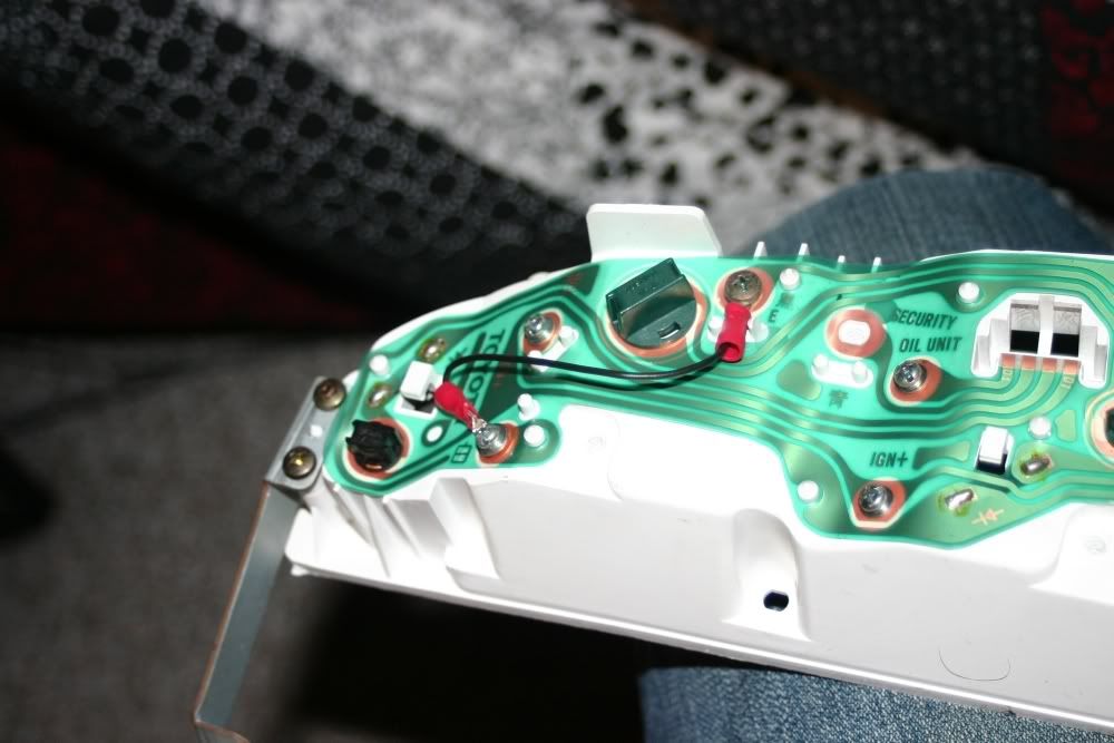

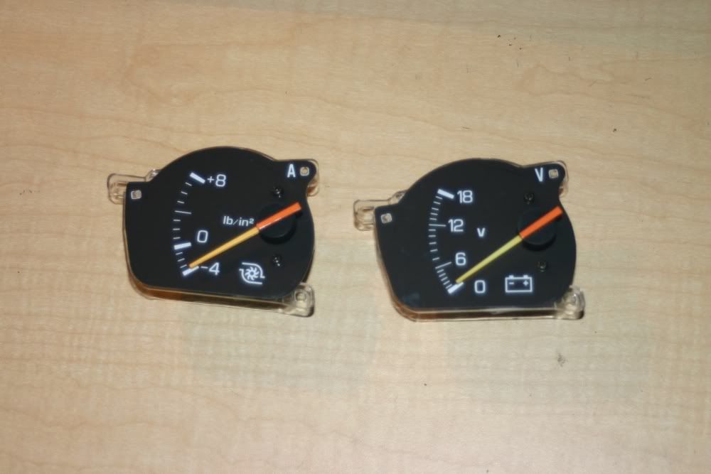

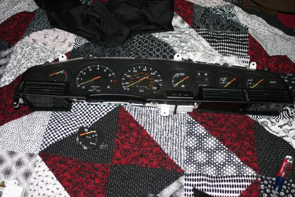

A big thing that people don't do with these swaps is get the tach working correctly. I used a 4th gen Celica tach motor and modded it into the Supra cluster. Also changed the boost to a volt meter. Everything should work now on this cluster.
4 cyl Celica Motor on the right
Just some resistors
Celica Motor drafted on.
Had to do this to make the Volt Meter work
Done...
Done...
