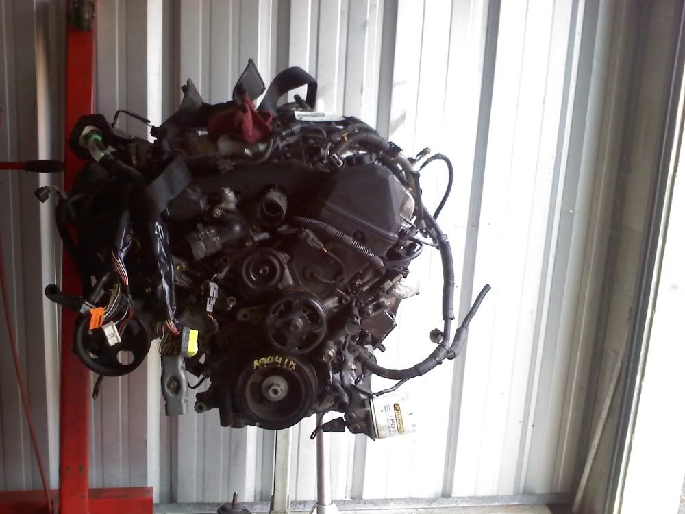

I got mine at AllPro... its listed on Car-Part.com... when I went there they tried to say it was a mistake and all this garbage, although I talked to them 2 times prior and they said $99 was fine... After complaining for a bit, I got it for the price I expected and not the $350 they tried to get me for.

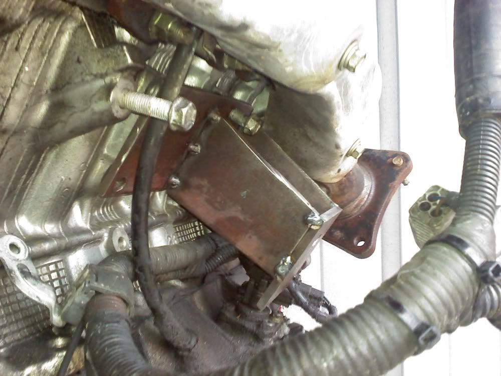

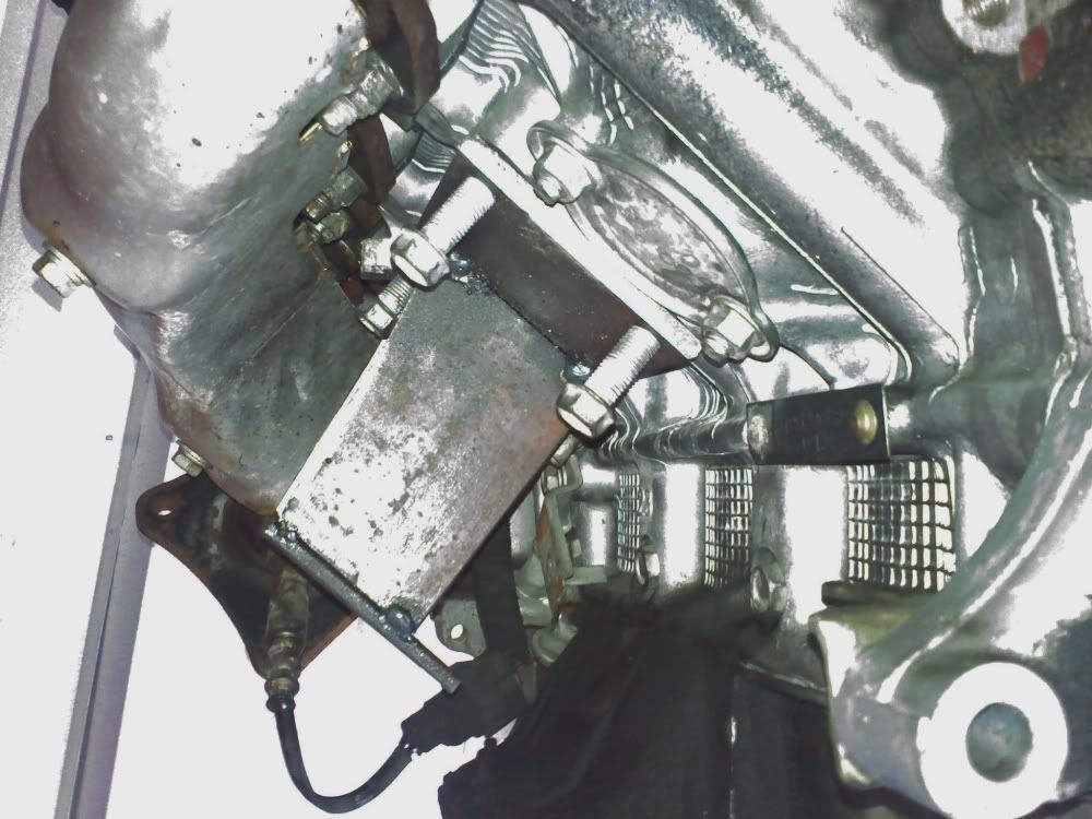

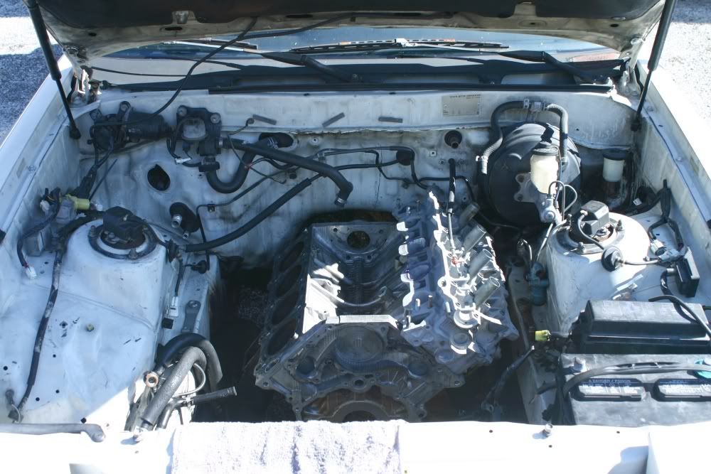

Tacked welded some solid mounts. Hope they work. I was weary about solid mounts, but I rode in a 1jz MK3 with solid mounts and it was pretty smooth... I figure since the 1uzfe is smoother, it should be fine. May have to make some small adjustments on the lip where it sits on the frame, but no big deal.

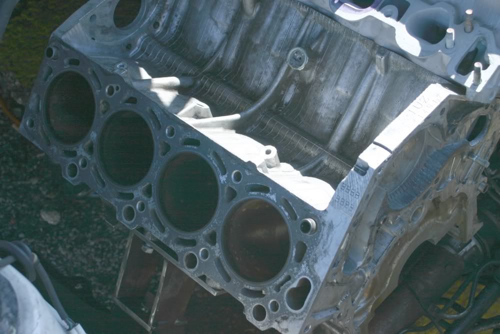

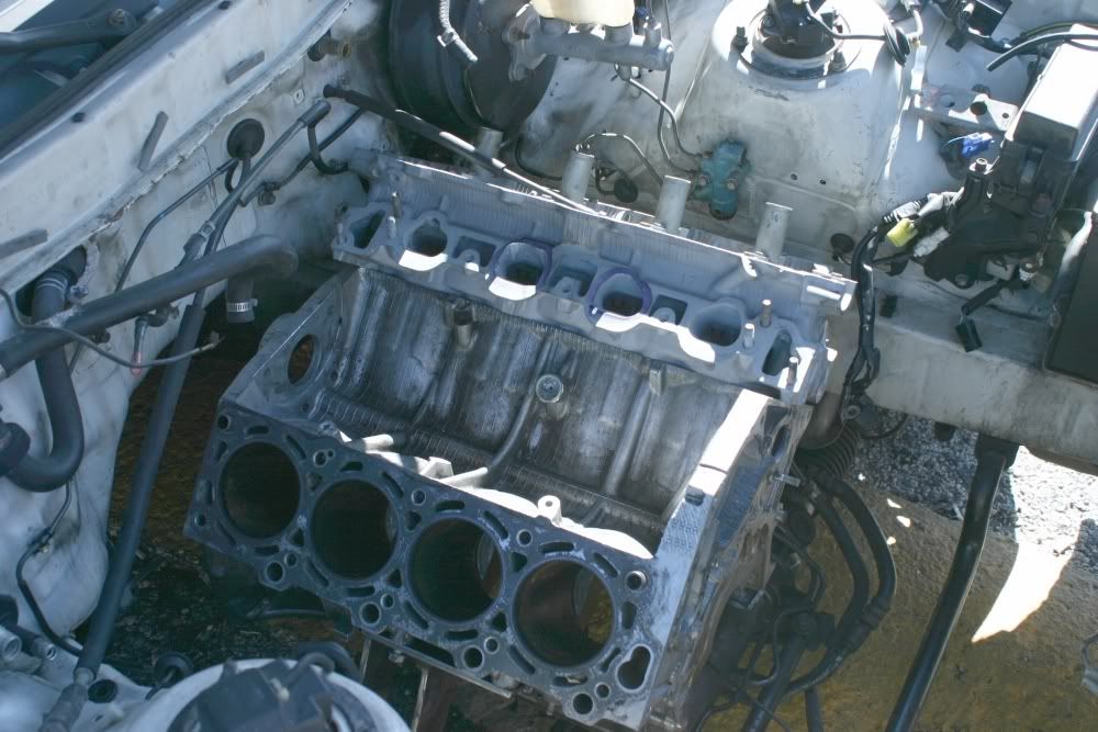

Test fit. Fit decent, gotta modify the plate that bolts to the frame.. its close and would work, but I can make it fit a lot better with a little re-engineering.
However..... Dummy block fits great!

Those mounts look suspiciously like my design ;) lol. The ride is smooth from idle to redline. Anyone who wants the CAD drawings for the solid mounts, they're on my build site. If you don't like solid mounts, then removing ~2" from them will allow the stock 7MGTE rubber isolator to be used.
Thanks for the heads up on the build thread Matt. Subscribed!
