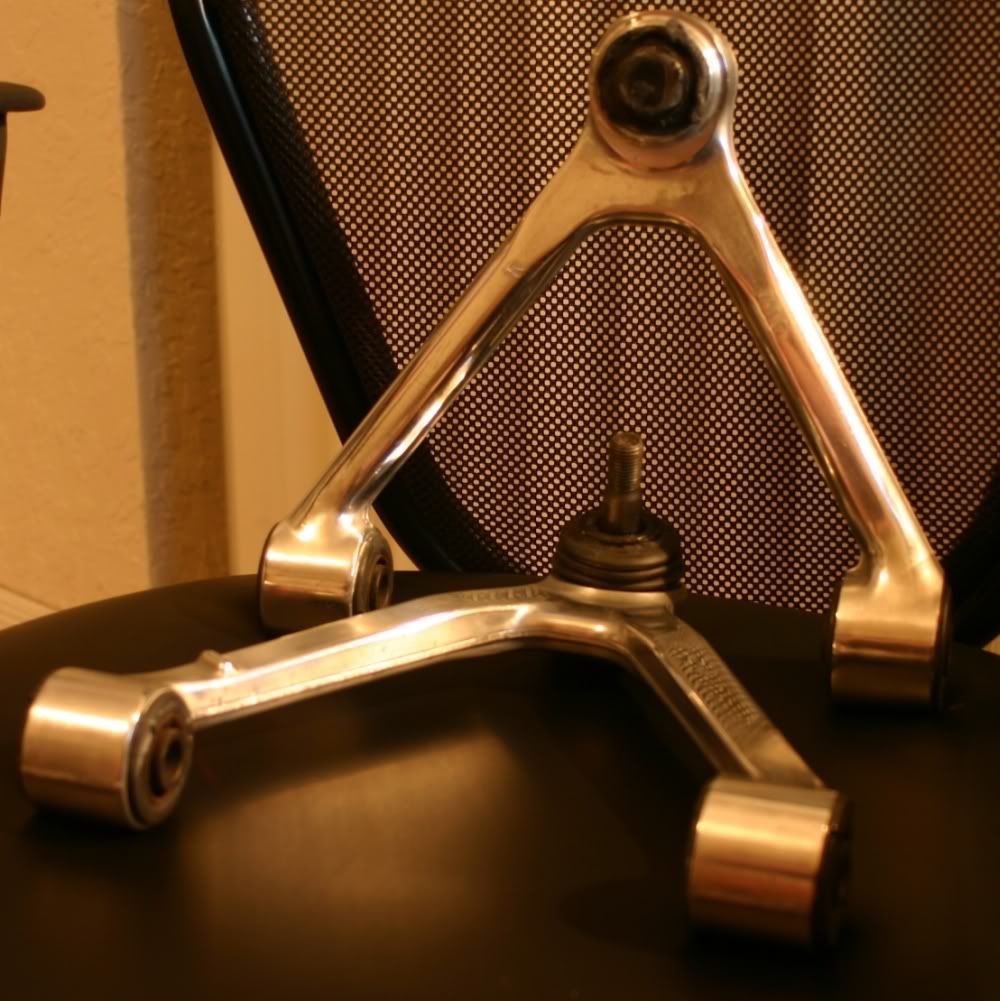

The sand blaster failed. I wire wheeled what I could on the spindles and LCA's, but I really need to get in the nooks and crannies with a smaller wire wheel or a sand blaster that works.
I did polish the UCA's. Nothing special, 200, 400, 1000, Metal Polish, but I think it gives it a more finished look. I need to clear coat them still. Pics dont do it justice. Wait until its outside.
Trying to make the bushings this weekend... also trying to work on the SC too... Hopefully it gets done though, I would love for a rolling chassis again!
