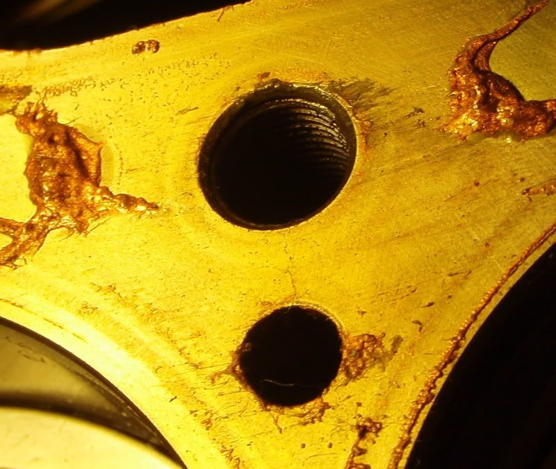

survyor2;1060802 said:
That one. I left it full size so you could see it (break out those reading glasses gramps!).
62
DOH :(
At a guess I'd say that's what cracked it.
You get a buildup of crap in the bottom 1/3 that the bolts don't reach but the studs do.
Also looks like the block wasn't deburred after decking so that can contribute as well.

IJ.;1068738 said:
DOH :(
ah i see. So for sure too late for this block?

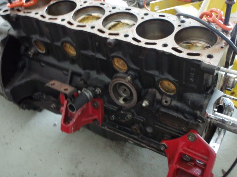

I did have this block "cleaned" by the machine shop. I can't be more detailed than that. I then put about 3000 miles on it with the bolts. Then I switched to studs and put on 500 more miles with the studs.
I need a list of stuff to do when I take it to the machine shop. Previously, i had it bored, decked, cleaned and 2 freeze plugs replaced.
62
Again personally I wouldn't risk it at that HP level, these motors move around a hell of a lot at high output.
Lower power with the holes washed with thinners and sealed with loctite you'd get away with it no probs.
I tend to be a bit conservative though so it's really up to you.
I did find a block locally. Its the older block though. If it has no cracks, would you feel comfortable running 550hp?
