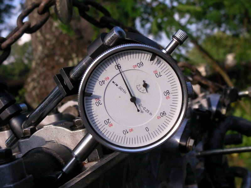

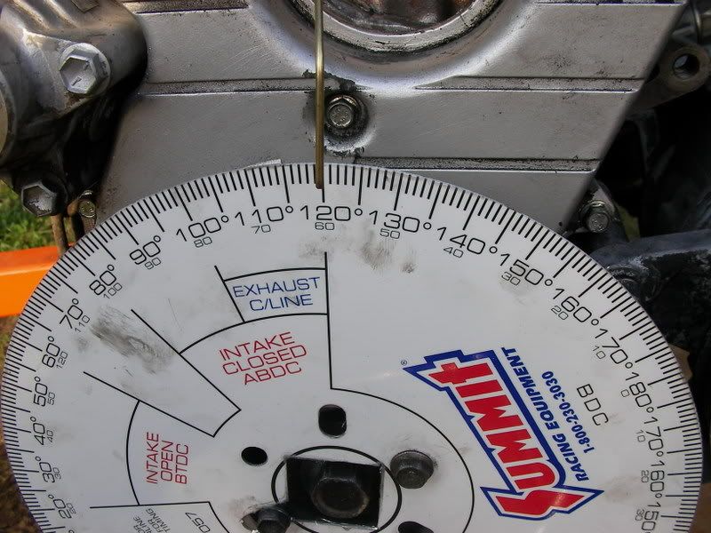

Well, I couldnt figure out how to degree the dam'd cams. I watched the video six or seven times, and he's missing something. He shows himself turning the wheel about a half a turn, and then it shows he's only turned it seven degrees which is bs. Everytime I tried it, I had to turn my wheel 120degrees to get the fifty thousands of lift I wanted. Frome there I was lost. I googled, researched and prayed and nothing helped, so I've got the cams set at zero. If anyone wants to call me and help out, I'm more than willing to listen. 205-243-0622. Until then, I'll just have to leave them where they are.

I finally got the cams degreed today with some help from Brian. It was very easy to do once I got the exhaust cam on the exhaust side and the intake cam on the intake side...........:icon_redf
The intake cam has a big "E" stamped into it, and I thought it meant exhaust, but it wasn't until I noticed the cam sensors on the wrong cam that I new I had messed up. Luckily I found it before I hid it under my newly polished valve covers.

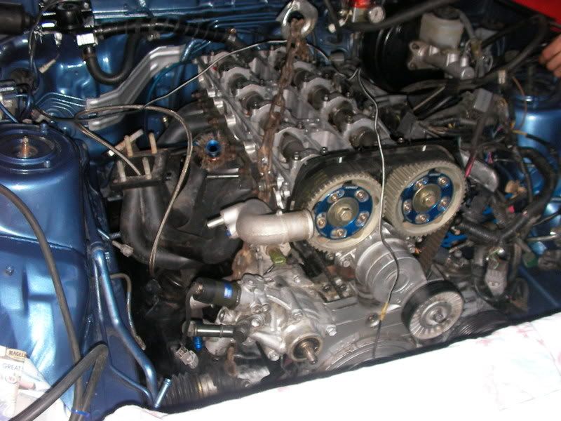

I got the cams degreed and I also got the motor in the engine bay without scratching up my new paint job. Unfortunately my cams seem weird to me. They ended up with the exhaust retarded to 10degrees, and the intake retarded to five degrees. I don't know what to say other than I checked them twice before I quit, and that's exactly what I came up with. I know last time my exhaust was retarded to 8degrees, and my intake was advanced four degrees, and that was adjusting them on the dyno. Here's a picture of the engine in, but I've still got a lot to do.
