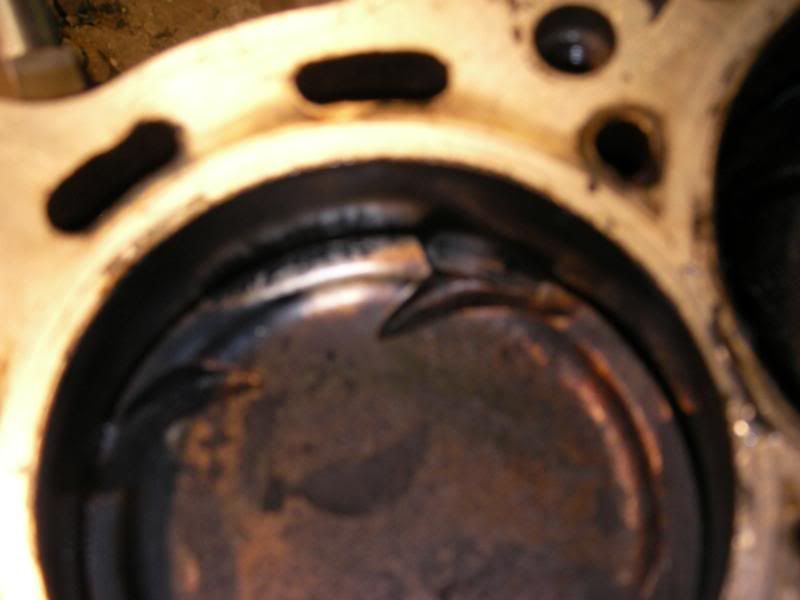

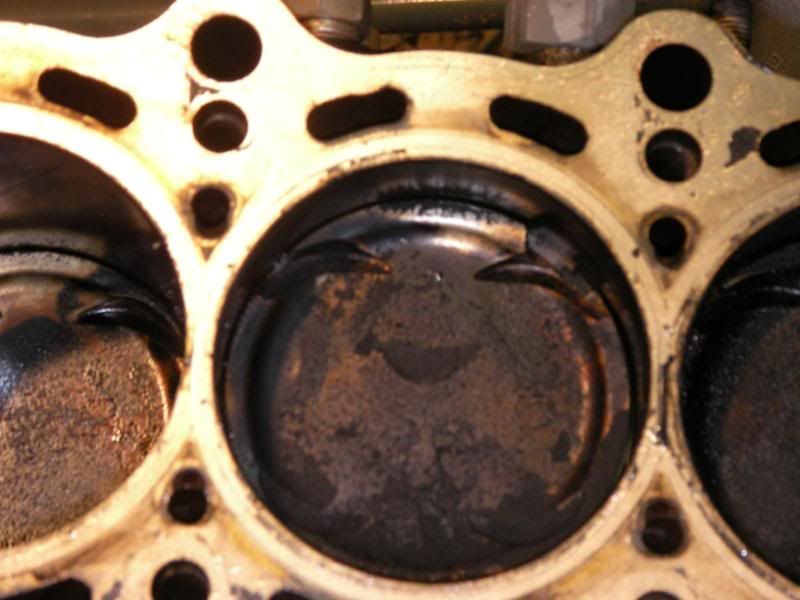

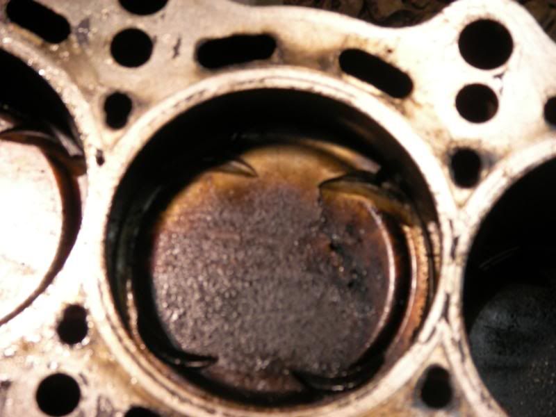

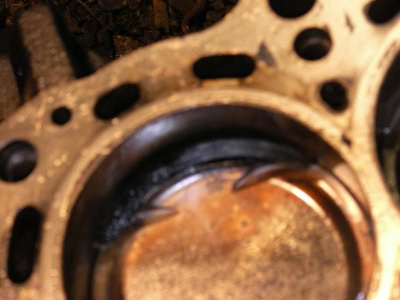

I thought the same thing Aaron, but wouldn't the valves have at least a scratch on them or be bent if it hit hard enough to break the edges off of the pistons. I still feel like I should have went with a thicker head gasket, but there's about four or five people on here that insisted on a stock 1jz head gasket. I won't use the stock one this time when I get it rebuilt. It seems if you take some off of the block and head, you should add it back in with the hg.
I'm just wondering if piston slap could have did this damage. I measured the bores last night and they ranged from 3.382-3.390, but I don't know how accurate the mics are I bought from O'Reily's. I also don't know the exact size of the +.020 pistons are. I've sent CP an email requesting that info and what their recommended allowance is so I"m waiting to hear back from them before I take this to the machine shop. I want to have all my numbers at hand when I go confront them. If it's my fault then I'll buy another set of pistons, but if they put the ford and chevrolet clearance in there then it's their fault.

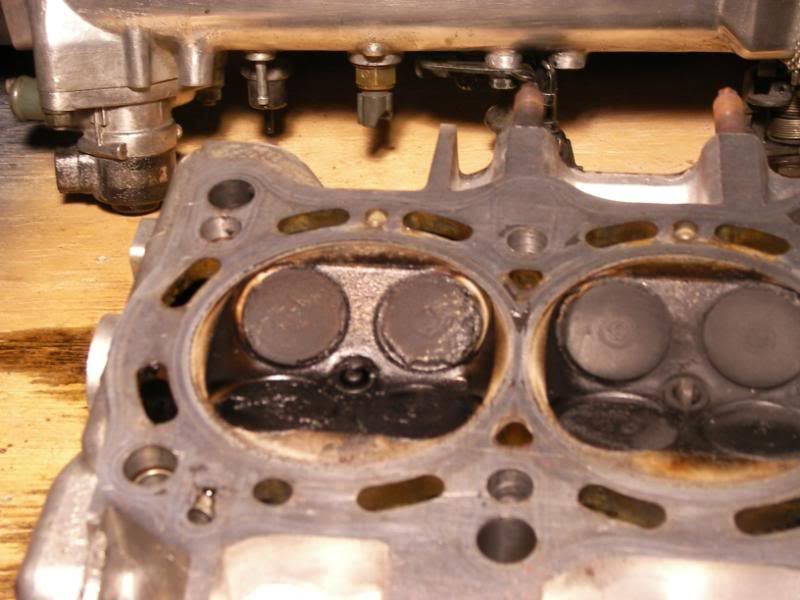

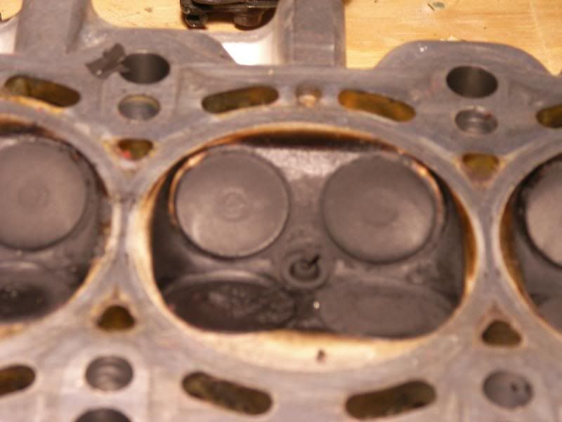

I'll go get pictures now.
55

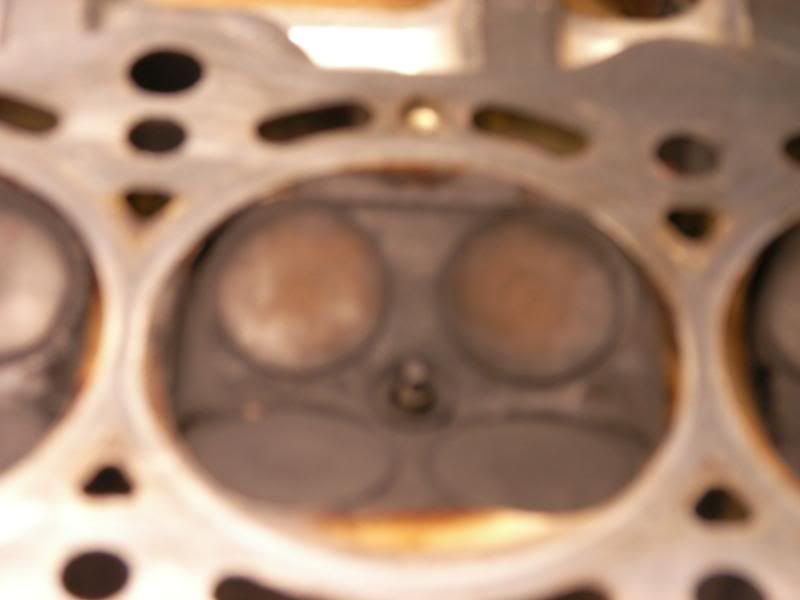

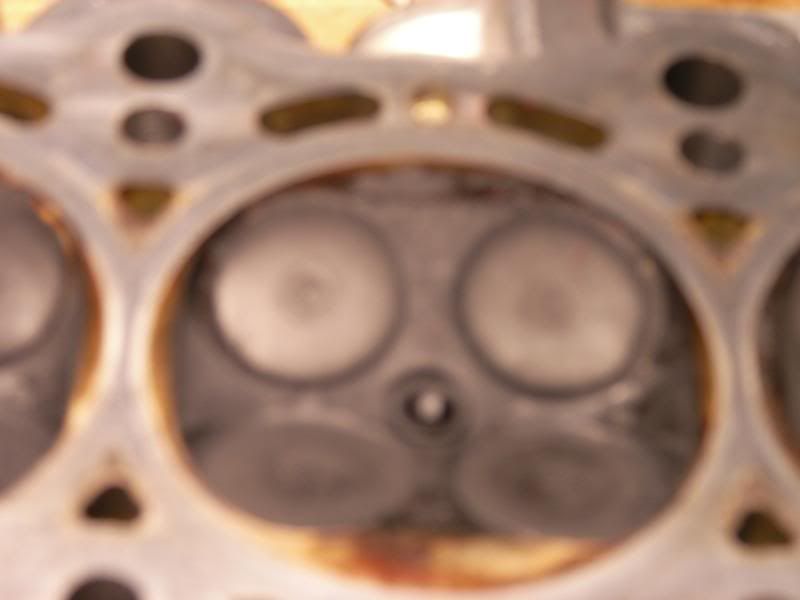

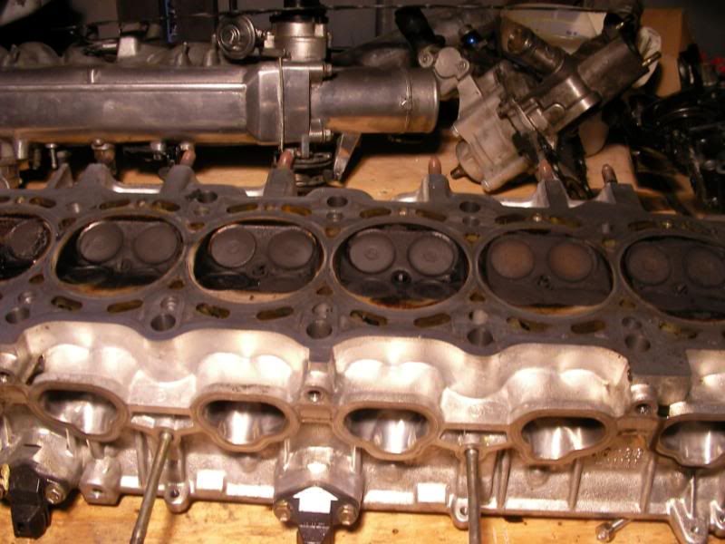

This is number six. You can see all the carbon buildup on it.
55

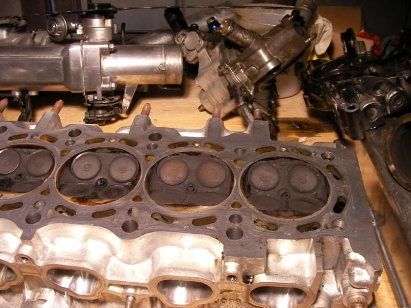

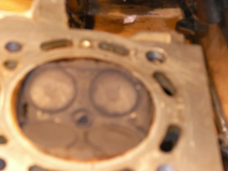

I know some of them are blurry, but I was trying to show every cylinder and the last storm we had destroyed my dark room. Sorry........:rolleyes:

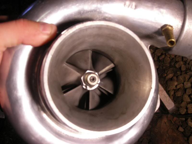

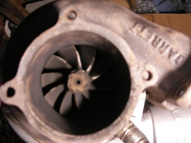

Heres two pictures of the turbo and no fins were harmed during the destruction of this 2jz............:biglaugh:

Did it ever go lean on you? Man, you are having a heck of time on this Jay. I applaud you for sticking with it. I know it is very easy for an Alabama boy to go the way of the small block chevy in tuff times like these :)

Looks like valves hitting pistons - did you measure the deck height on the pistons and compare it with the 1j?
63
Really hard to tell from those pics but I edited them to get a better look..
Looks like it's a fuel supply issue and/or there was a lash issue in #6.
Bit of a chicken and egg thing, did it torch the valve because it was off the seat or did it torch is through being lean?
Having driven it all the way home makes it hard to tell because of all the Oil coating the piston and chamber, I'd have been able to tell more seeing the plug right after it fell over.
55
I leaned it out after it started smoking ridiculously. I ran it all the way home at about 15.5 - 1. I never got into boost though.
