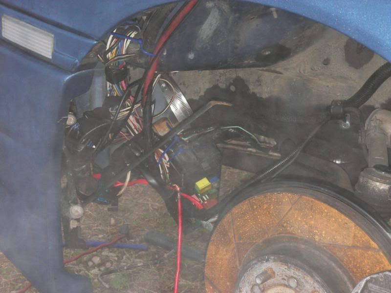

Did you re-locate the main fuse block into the wheel well?

Mr. Ronius, I relocated the fuse box a while back before I swapped in the 2j block, so I know the wiring problem doesn't involve that.

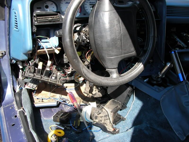

UPDATE
Tim found the problem. The headlight retractor box was plugged into by the wrong wiring harness. There are two harnessess that look identical. One goes to the rear lights and it was plugged into the hrb. We reversed them and all is good in this world................::w00t::
Here are two pictures of the car as it sits. I feel good about getting it all back together and actually getting to drive it tonight, but only time will tell, I'm taking it one step at a time, I dont' want to put the horse before the cart, I'm not putting all of my eggs into one basket, it's easier said than done, yada yada yada.

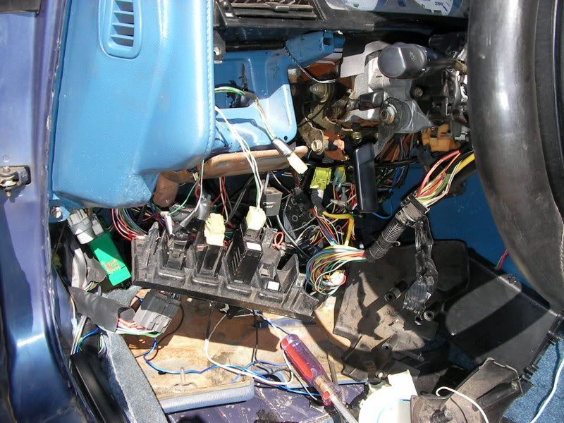

The little green box on the left is where the malfunction was and the grey harness under it. They were reversed. They have the exact same plug ins so it was an easy mistake to make. Unfortunately for me, it's cost me about two days of breaking in time with the motor. I'll have to make up for it by driving it more tonight if given the option.
