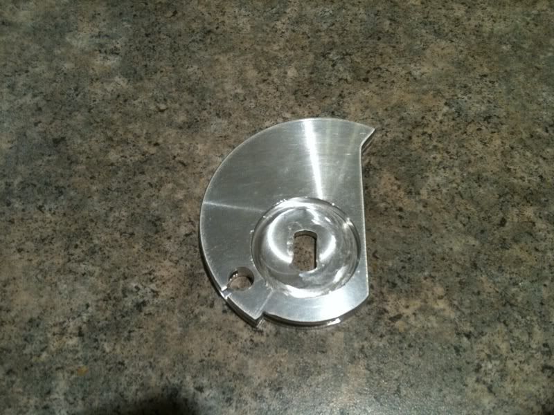

I also finally got the throttle lever made - only a week too late. Here it is.
aaron_arthur
Jul 30, 2008
51
London
All I can say is WOW! Amazing build. I can say im very jealous of the adapter flange and FFIM set up. I am currently trying to figure out something like that which gives the stock look but more efficient. Very well done.
