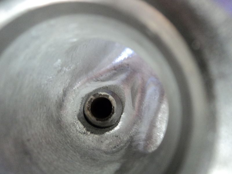

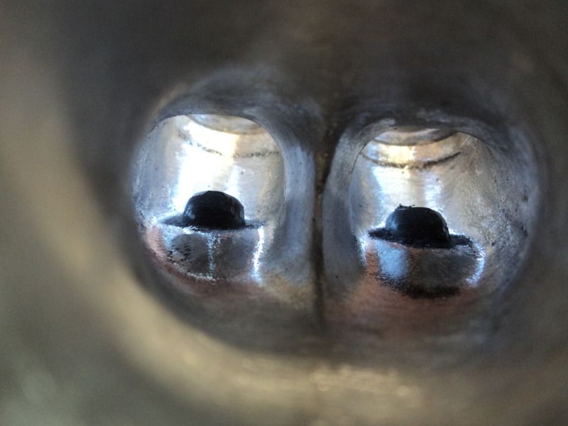

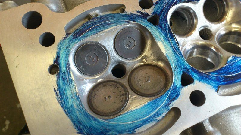

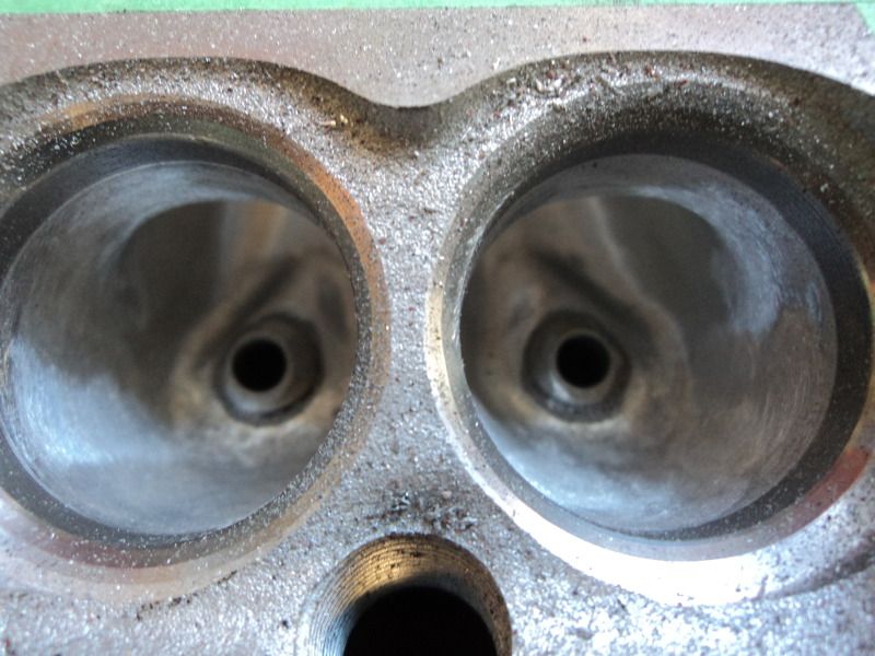

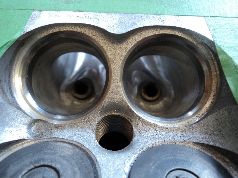

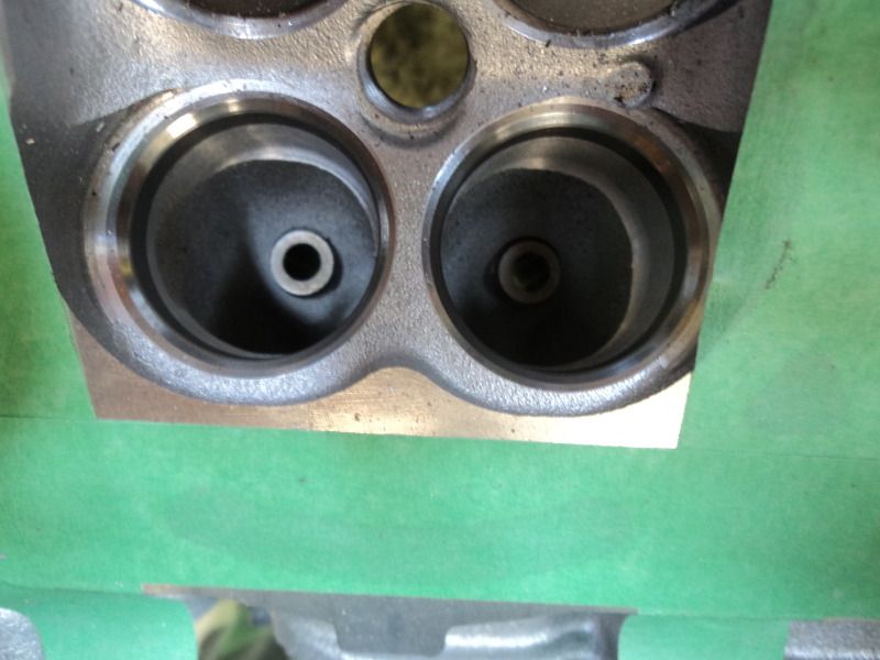

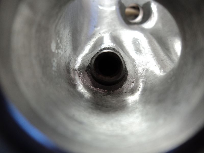

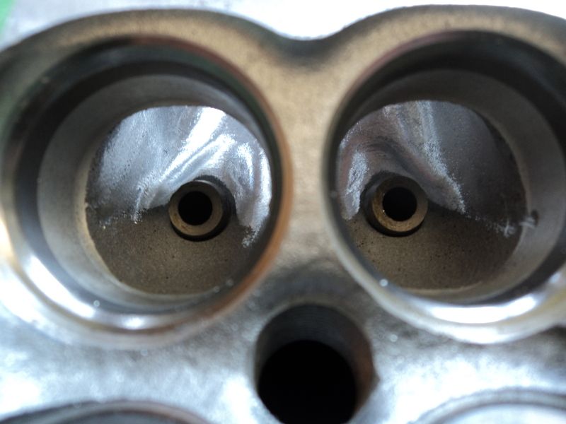

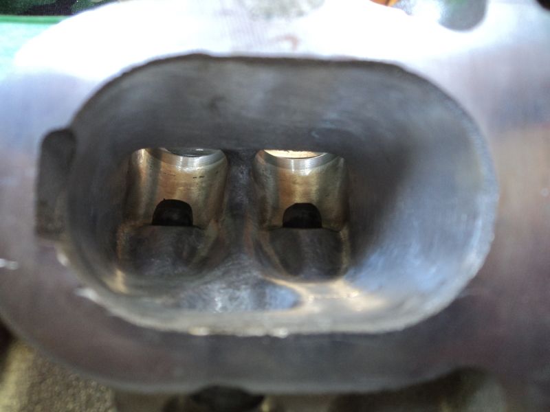

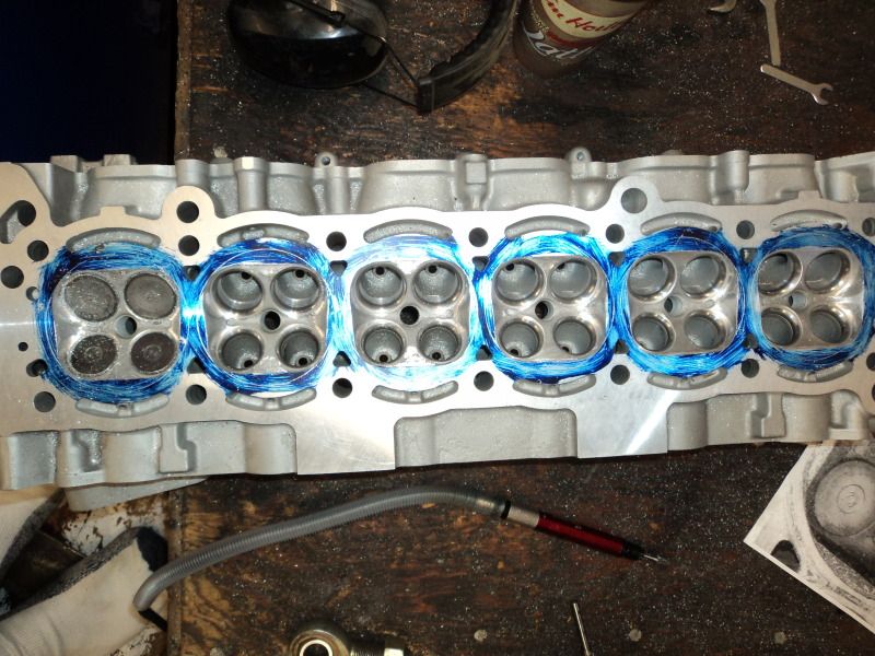

that would be awesome. did you do any combustion chamber work (smoothing and unshrouding valves, etc)?
damn i feel like an ass I forgot
Well i gt the machine shop to plunge cut the vavle seat's
and took it from there
I even have porting job that uses custom pistons the head will be for sale coming up heads off a 92 as well good for about 9k rpm
and be some what a copy of the group A race head that I have

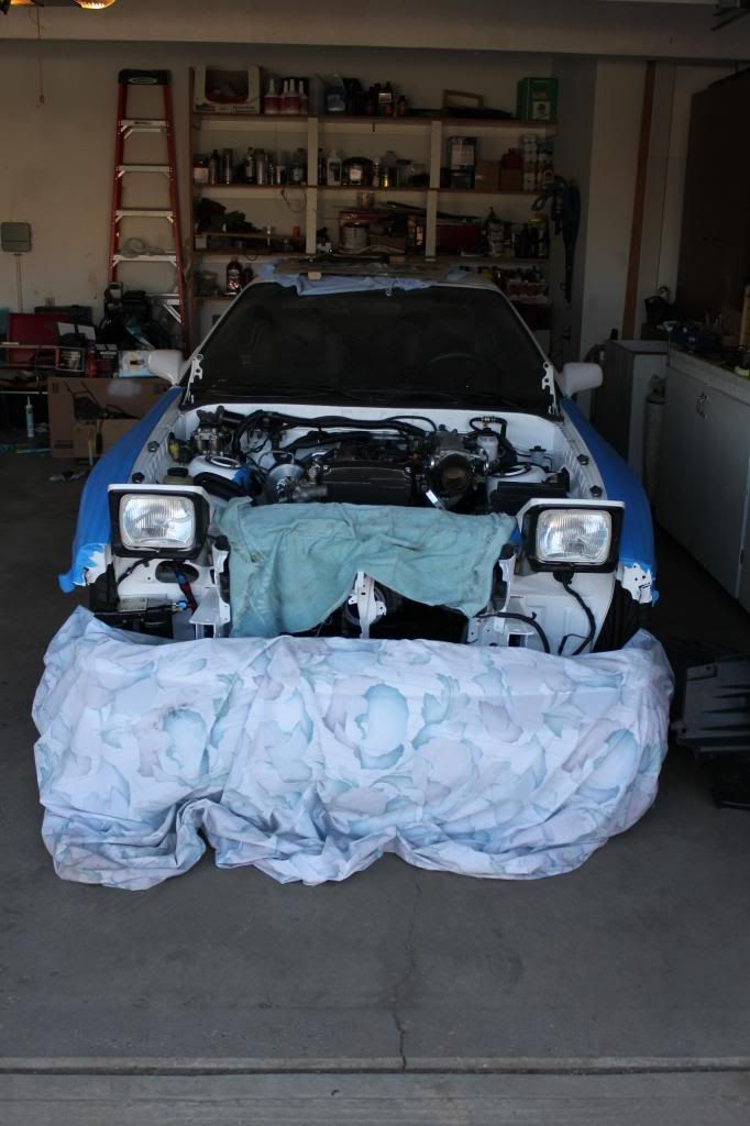

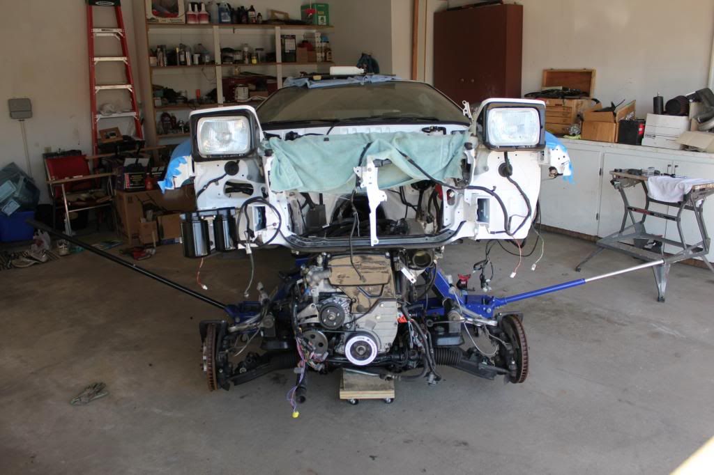

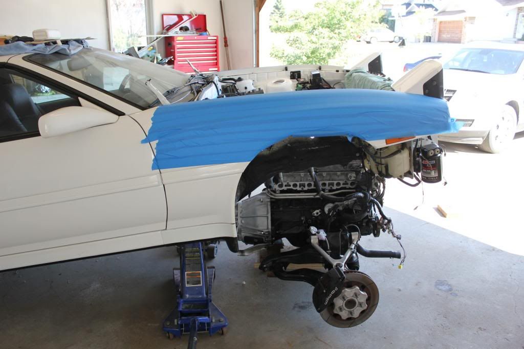

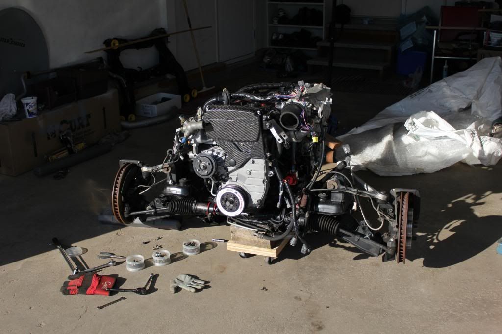

decided to try joining car and engine a bit differently this time. more specifically, dropping the car onto the engine.
Sadly, the turbo and manifold are coming out. Forgot to install the 7/16" studs on the exhaust side of the head and pulled out a few studs. Other than that, this has been the easiest engine install yet thanks to installing the engine, transmission, and subframe from below.

i've pulled helicoiled metric studs out of heads in the past but never the 7/16" ones, so I'm not risking it this time and going straight for the big ones. already have a good stash of 7/16 studs, just need to get a few more inserts.

Nice work, I have always thought it would be easier to reinstall the drive train that way. Especially having a 2 post lift. Solid numbers as well.
