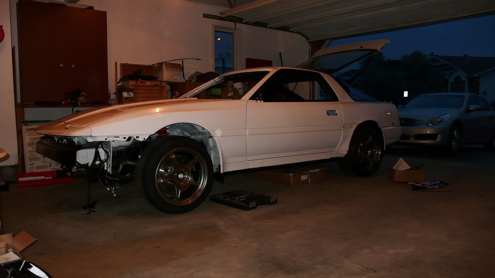

Sorry, I forgot, the last thing I accomplished on the car was installing the MK4 rear brakes (apologies for the shitty camera phone pic)

Michelin Jack FTW!
I got one.
LOOKin nice.
LOVE the wheels.

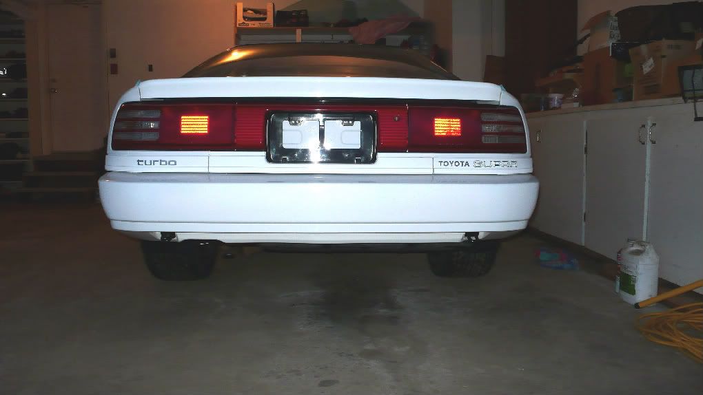

Edmonton

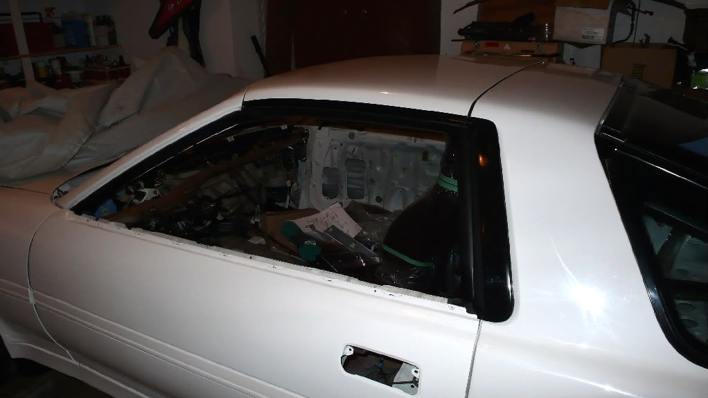

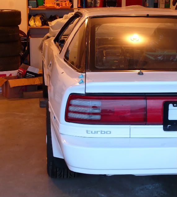

Now more car-like than ever before!
(Recent installations have been the fuel tank, sound deadening and installing the guts in the driver-side door, installation of new roof and door seals)
If anybody has a complete lock cylinder set in excellent condition (with keys) pm me...I need one.
seals:
rear end/fuel tank
side shot:

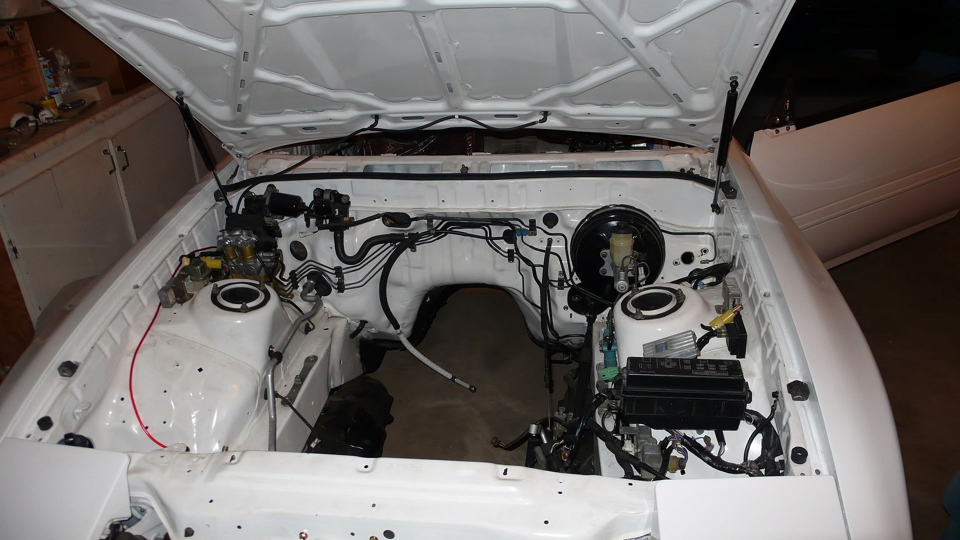

I'm slowly installing the boring things, like door hardware/guts and moldings and such. I'm currently wiring grounding cables from the battery to the back of the car and installing new fuel pump wiring with a kill switch. I should have some new pictures in a week or so once i get some sandblasting/painting of some engine parts finished.
I'm also attempting to shoehorn some JL 0W6 subwoofers into the rear speaker boxes - we'll see how that pans out.

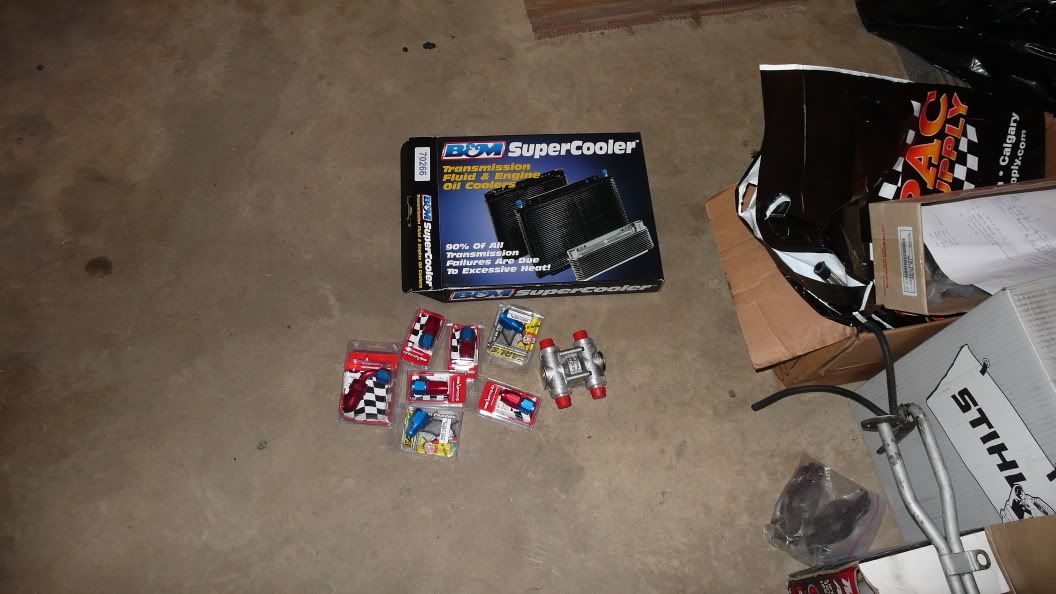

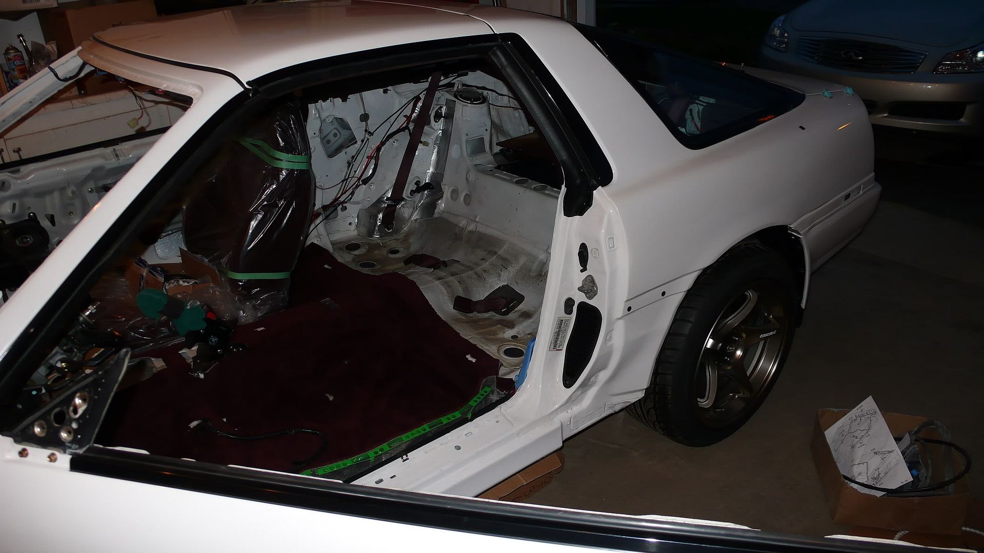

here are a couple of recent pics of my progress. The only thing really holding me up from assembling the interior is the lock cylinder set I am waiting on (apparently still on the boat from japan)
yep, those are new doorjam valves
and part of the oil system...I got my bypass and conventional filters in yesterday and they are HUGE! 4.5" diameter by 6" length for the bypass...not quite sure where I'm going to stuff that.
and yes, 90% of all transmission failures ARE due to excessive heat!

Orion ZyGarian;1047723 said:
90% of automatic transmissons yes. Dont forget to plumb the B&M before the ATF hits the radiator.
Lol, I was just quoting what was on the box.....thats my engine oil cooler - you can see my rebuilt R154 a few pages back - no automatic in this car.
