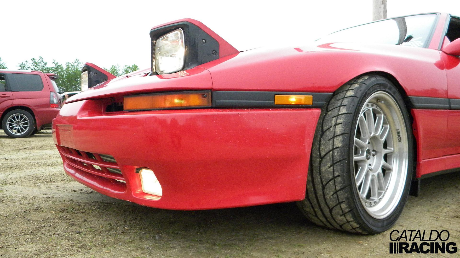

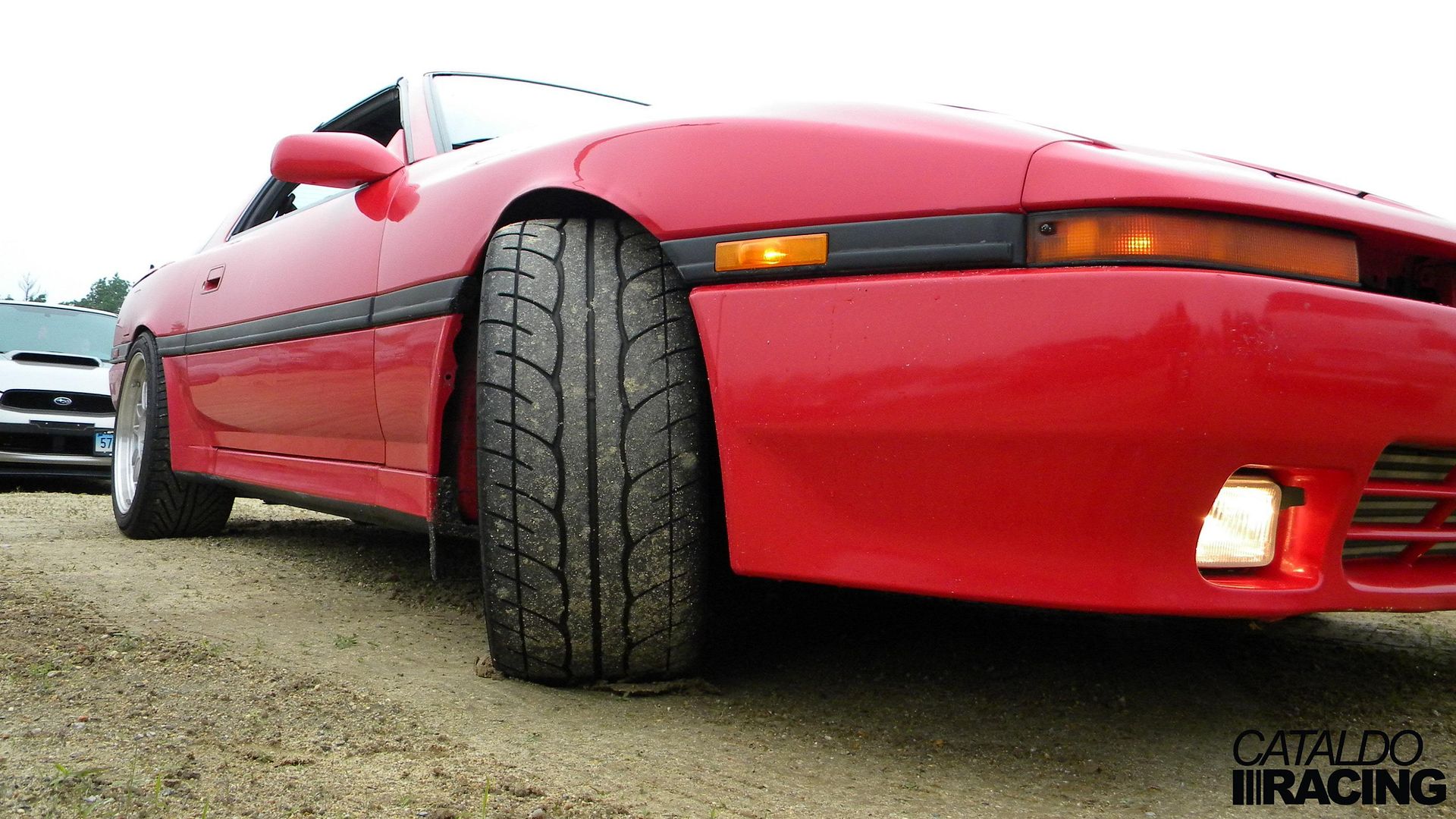

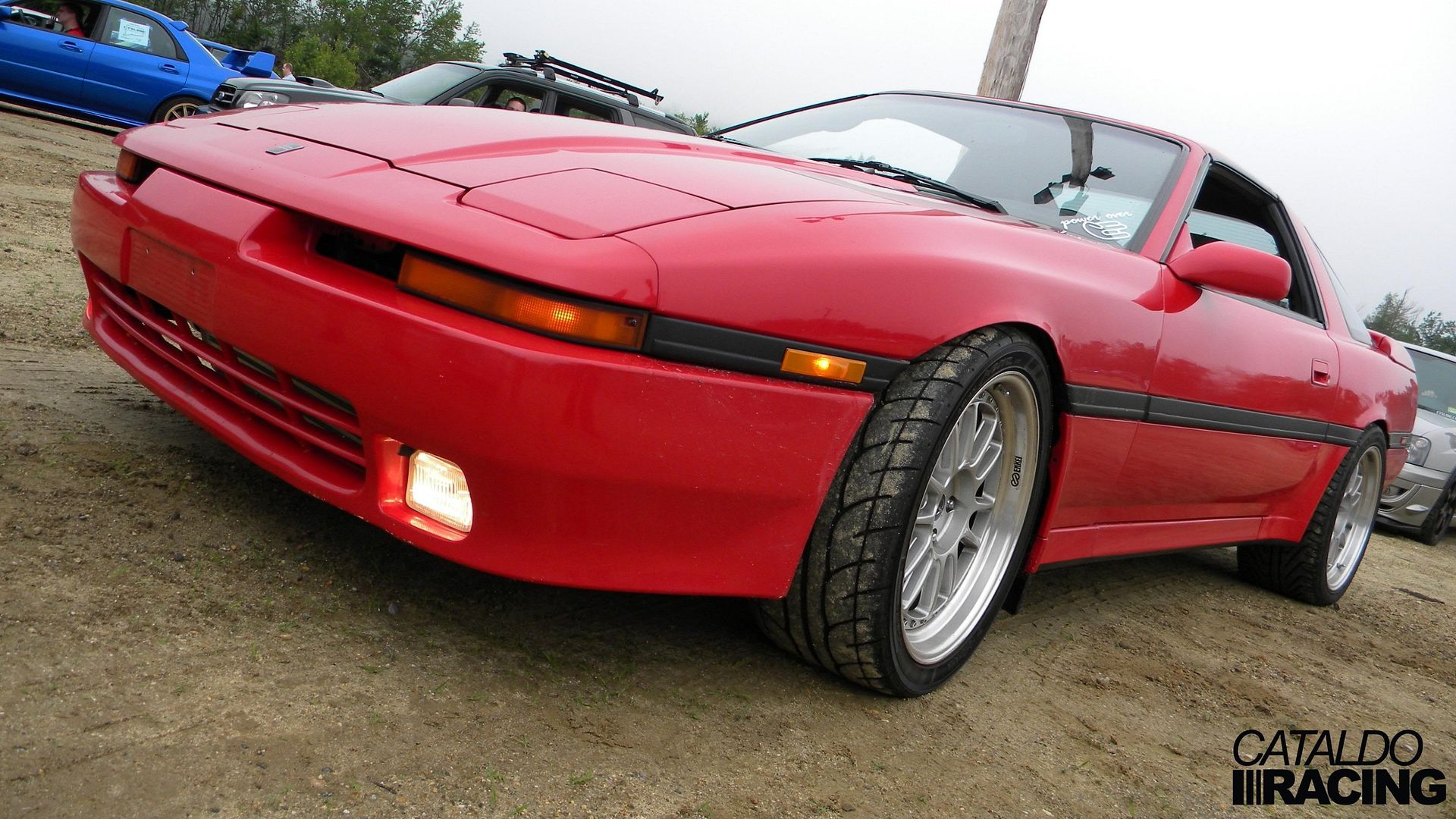

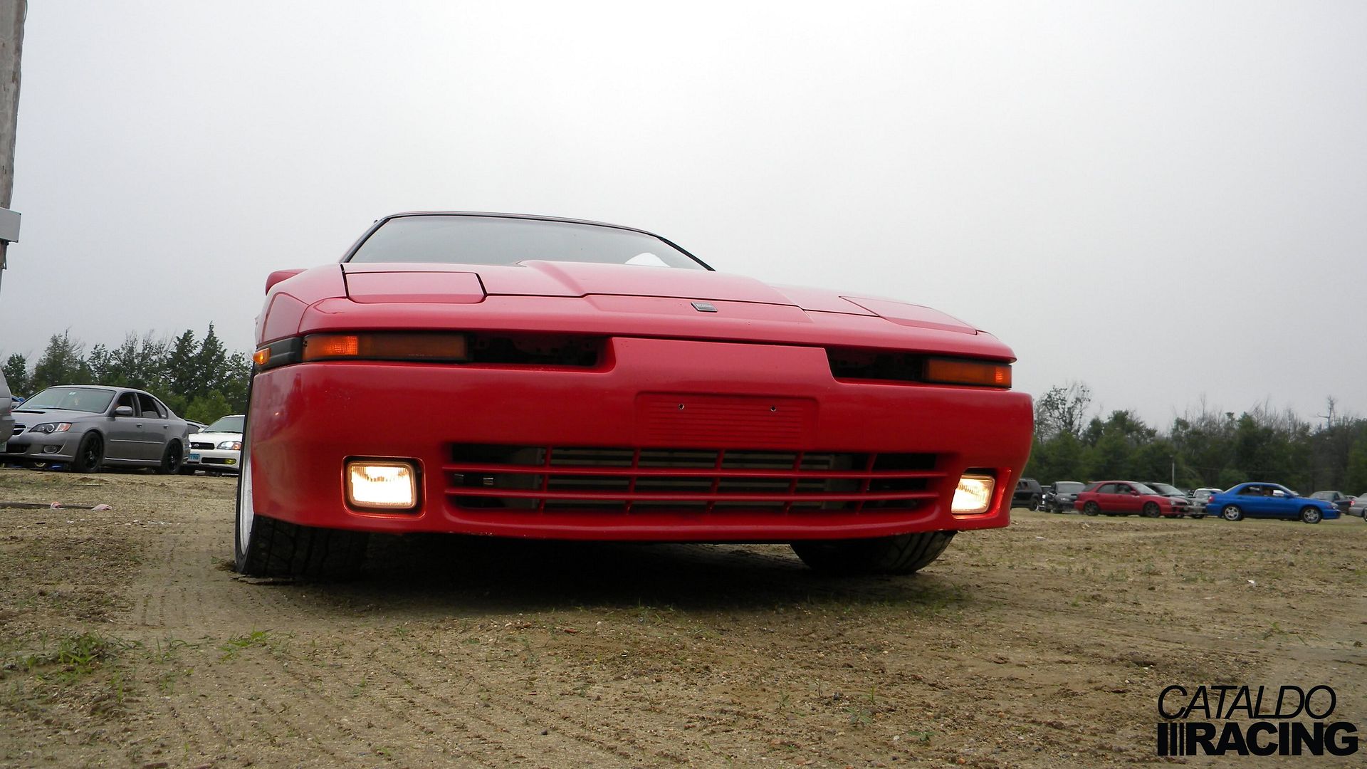

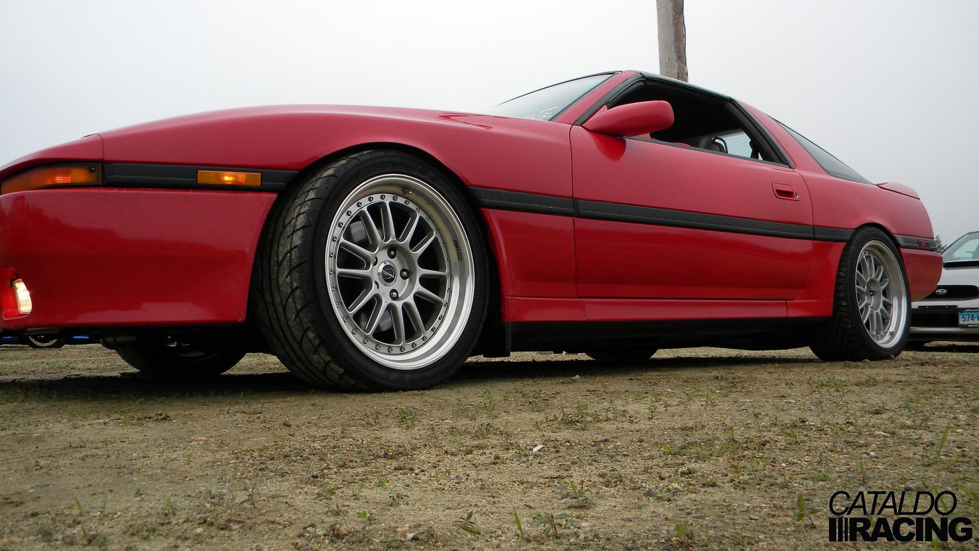

Done, and on the road! Feels really good to be driving a Supra again. It's almost surreal after 5+ years...
Couple pics from this weekend, taken by a friend:
Pics are huge, btw...

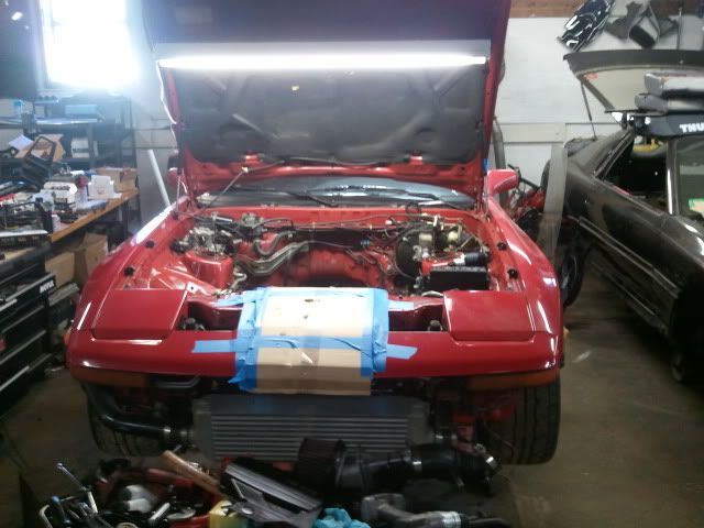

well, that was pretty long winded. thanks for reading, here's a picture to show where I'm at tonight.

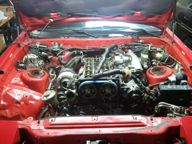

Engine is out. No surprises today, which is good.
I decided I'm going to put my Tomei Cam gears on this engine since I've had them for about 6 years and haven't used them yet, as well as my Comp Cams BBC inner springs on in preparation for future upgrades.
progress pic:

Call me an idiot, but is a t-stat bypass for those who decide to remove the t-stat? And is this a t-stat bypass?

OP; Just read the entire thread, glad you didn't sell this thing. The car looks badass, I really like the stance. If you hadn't mentioned it, you'd get away with saying you have coilovers lol. Do you have any rubbing issues at all while steering or under compression with such width in the fronts? Any rubs in the rears beside the 4" exhaust? Lol
Oh and one more thing, I do not by any means know much about flared fenders, but one of the rears just looks odd (I think it may be the pass side), maybe incorrect is more of an appropriate word. The lining looks "off", maybe it's just me. :dunno:

Supra28: the stock oil cooler system is pressure based, and not thermostatically controlled, which would be the optimal method of cooling, since oil is thicker when it's cold...
Thanks for reading! I'm glad I didn't get rid of it also. I love the stance as well! I have no major rubbing issues, the 4" exhaust drags a bit under the subframe where it's at the lowest, but with the 18's it clears more than I expected, it is quite well made, however, and fits awesome.
The rear tires rub the moldings very slightly, I have some clearancing to do before next season, but I've got the sheetmetal pulled out enough. Stock bodied was hopeless in clearing these tires, so it took quite a bit of work, but it was worthit
I don't see the flare issue you speak of, nor do I understand what you mean by lining...

As for wheel clearance, are you able to fully steer and not have the fronts rub? I ask because my brother had 18's on his Supra and they rubbed when trying to do a full turn on either direction. Specs were 235/40/18.
Disregard my post about the flare lol...

Axle: thanks! :bigthumb:
Supra: very welcome! I can go full lock, haven't found a situation where the fronts rubbed at all. I've been quite pleased thus far!
