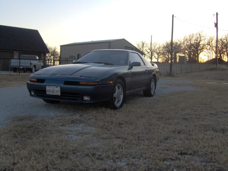

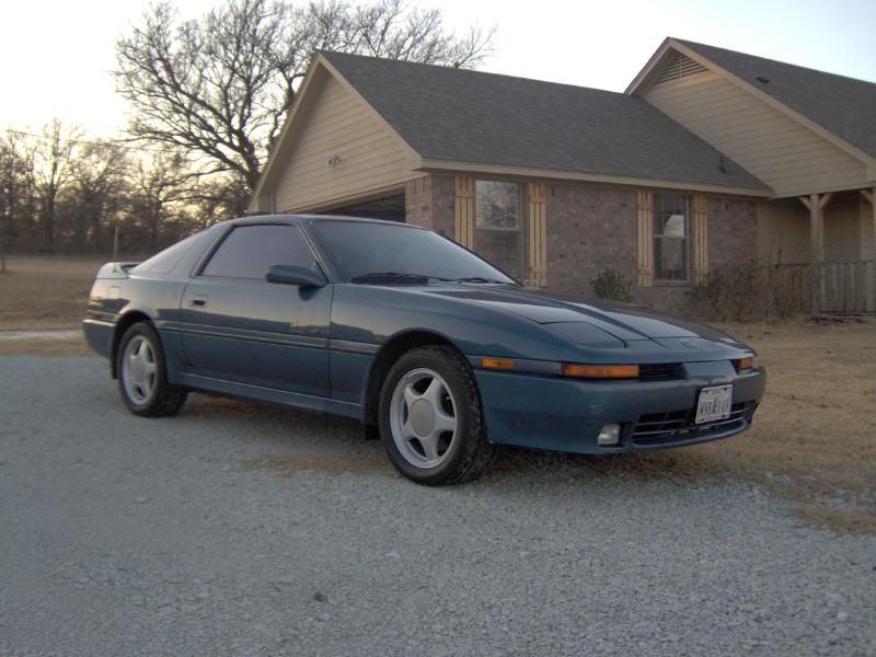

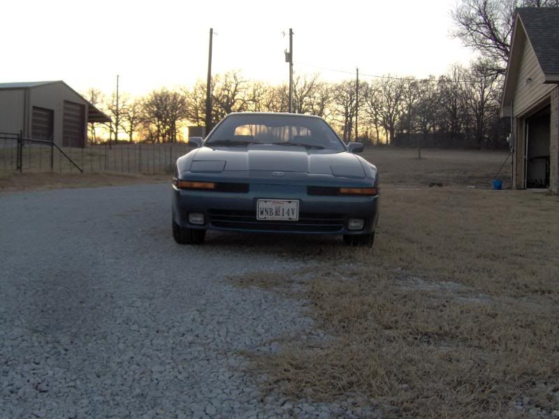

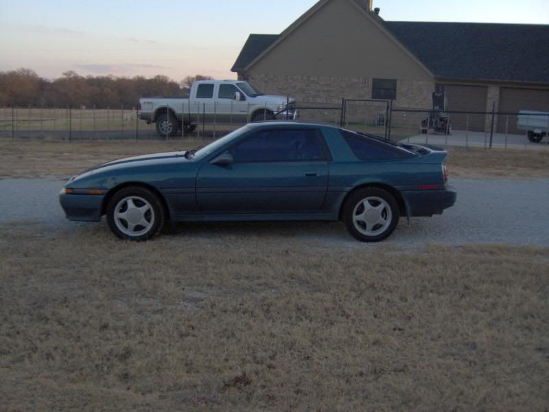

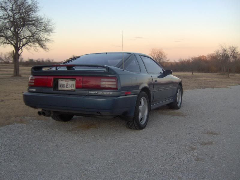

So as you can see in the pic posted above, I don't believe I'm leaking from that hose. In fact today, I could not find a leak at all, nor did I smell any antifreeze. Looks like I have a phantom leak, or I'm so fucking paranoid I can't stand it. I don't know. I put some more coolant in the reservoir and we'll see how the level holds up after driving it for a little while.
While at the house I washed it and took a few photos. It still has a little water on it but it was looking so good.
