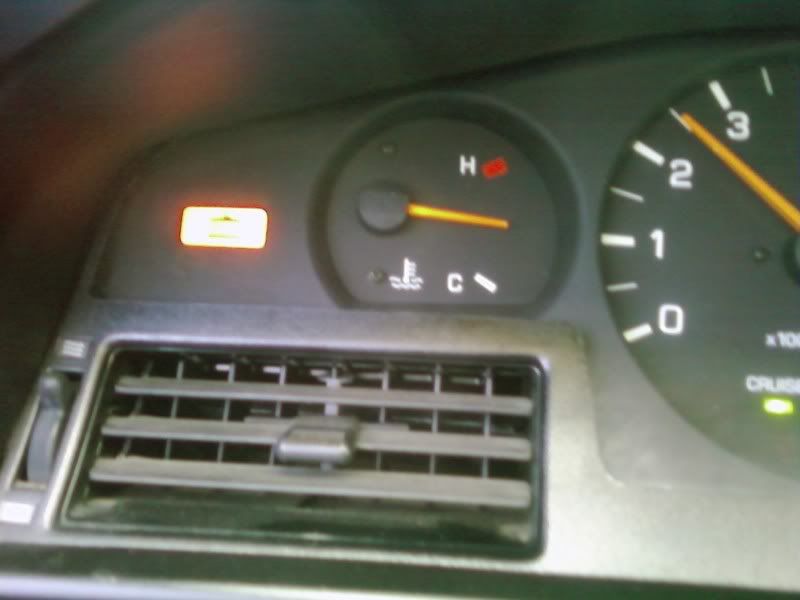

Son of a Bitch!!!!!
ForcedTorque
Join the 92 Owners Group
Jul 11, 2005
6,099
59
Don't panic just yet. I know you have burped it before, but as you leaked and refilled before fixing the problem, you probably gained a little air back in.
Also, how is the pick up on you overflow bottle tube? If it is clogged, you can also get the cage. Your temp level looks about right, but I don't know what the situation was.
