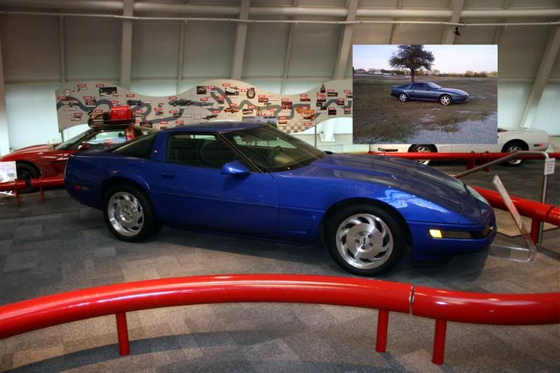

Greetings from Bowling Green Kentucky!
I just took a tour at the National Corvette Museum. I'll have some pics up later on in the week when I'm back home. The plant is closed until March so I couldn't see one assembled but DAMN there were some nice cars there.
It almost made me consider getting rid of the supra. Almost.;)

Went to the Corvette Museum while in Bowling Green KY. More pics at
http://www.supramania.com/forums/showthread.php?t=86424
