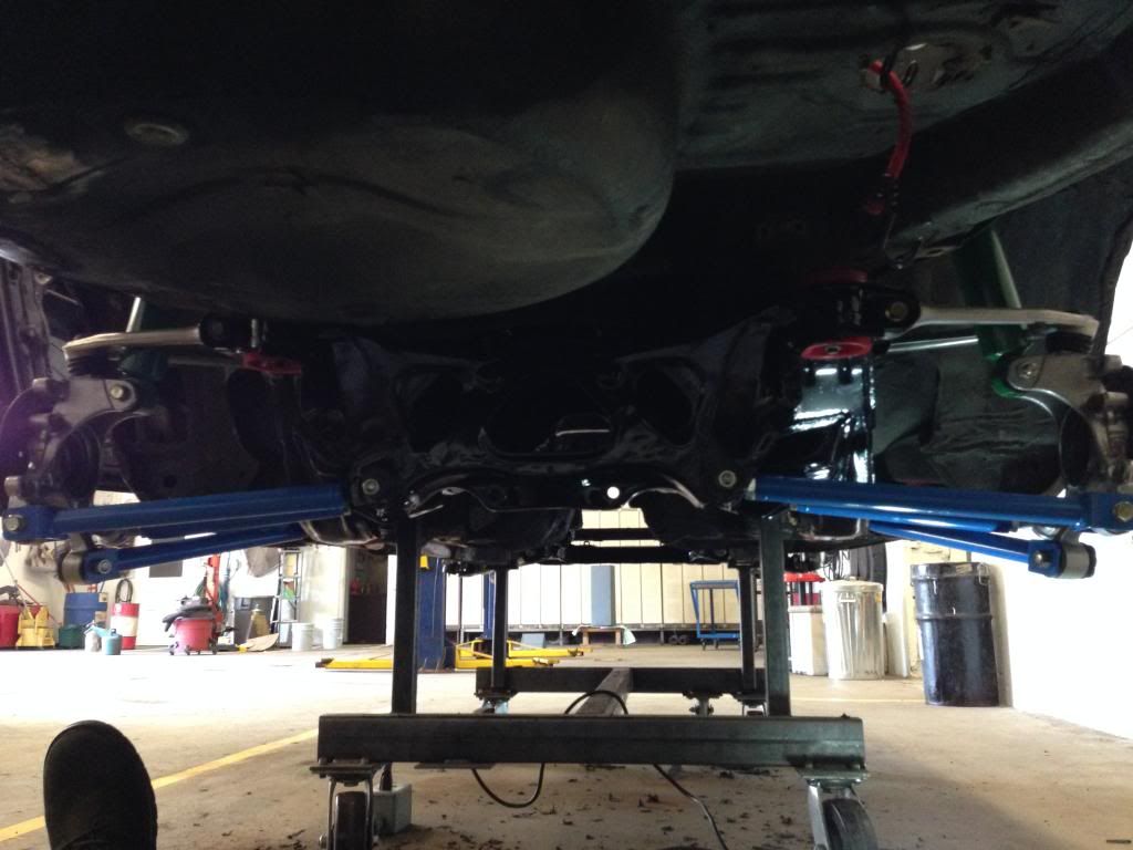

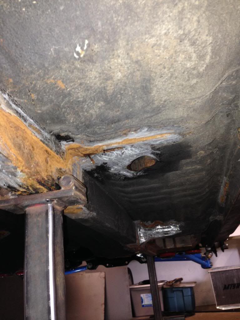

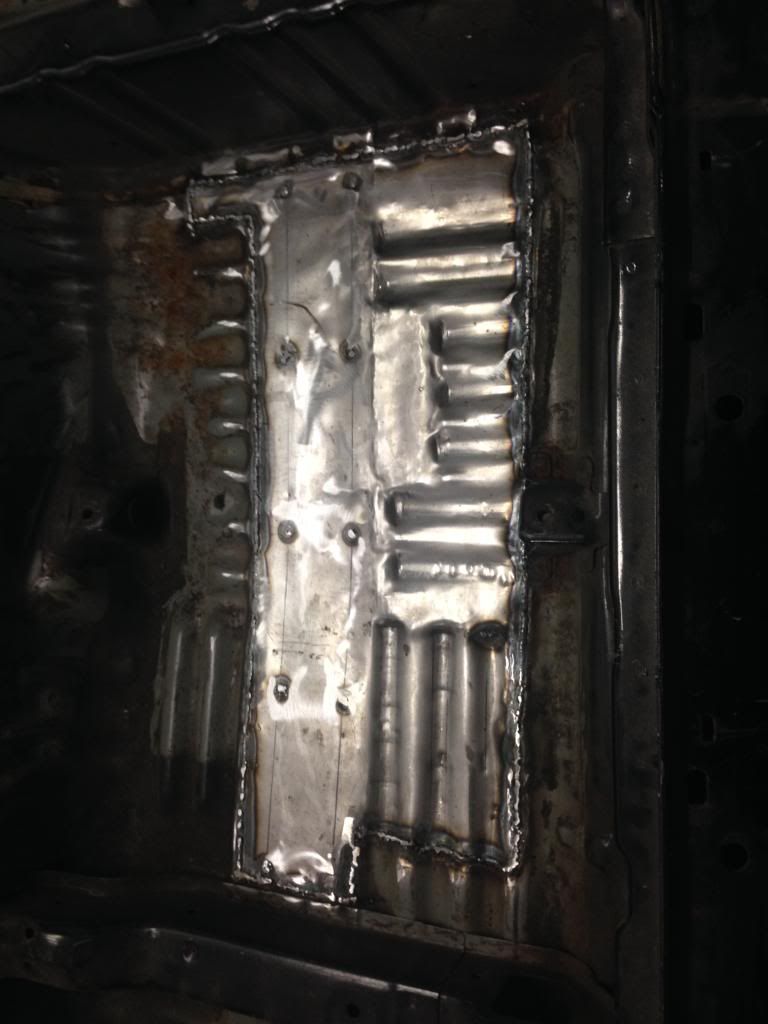

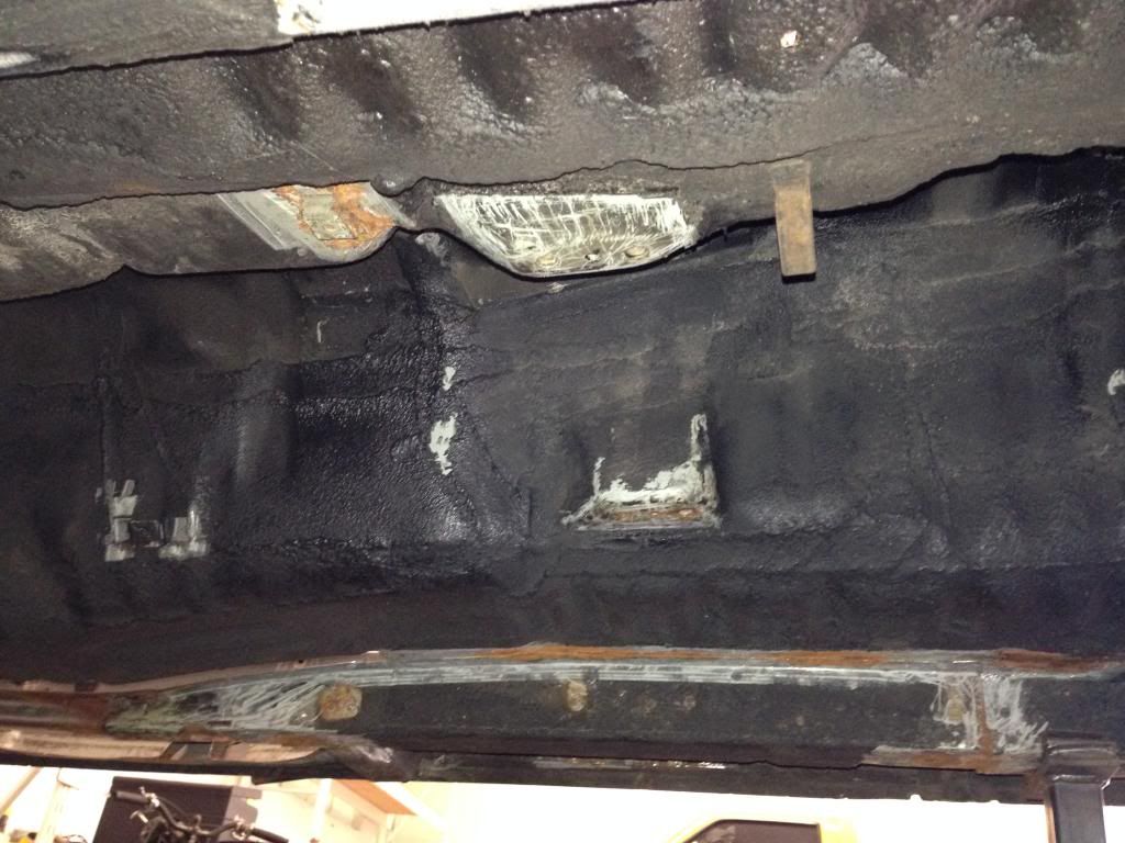

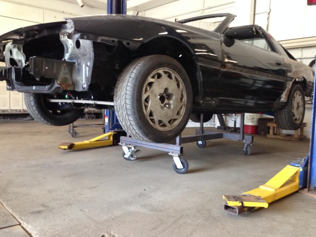

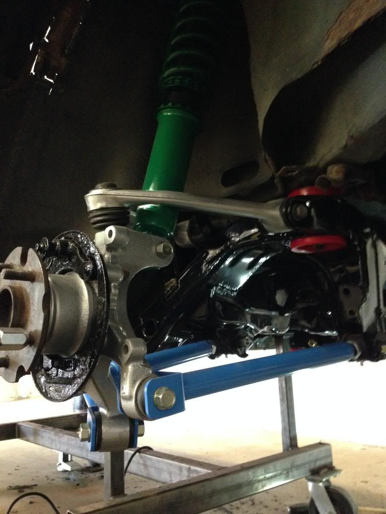

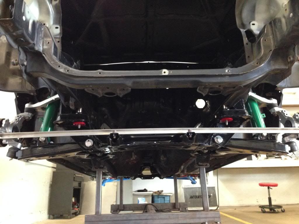

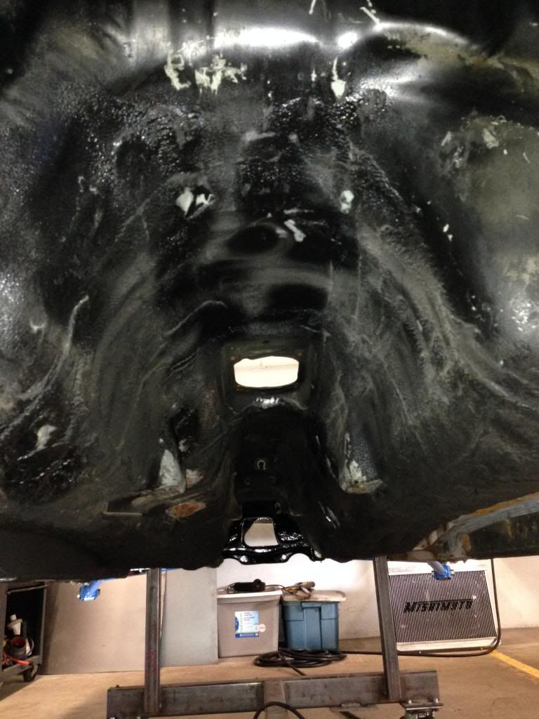

A little update. Did some more scrapping under the car. Couple shots of the condition. It's pretty good. Rockers are solid. Just some minor surface rust in places and a hole In the floor I've fabricated a panel for, just have to weld in. Oh and a couple shots of the front and rear suspension. Like most Supra's from the north, it needs some attention to rear quarters.

Simple curiousity.. When welding like that how much more susceptible to rust are the welds. I'm not a welder bit have heard there is a proper way of welding to reduce rust afterwards, but is it still more prone?
Just wondering because I have a few panels that have been replaced.
I have had a lot of people tell me if I'm worried about rust on my inner panels just coat it with engine oil...
TMMCSupra
Oct 2, 2010
90
Waterloo, Ontario
Well I'm not sure if there's a proper way to weld to prevent rust. I have read and found some products you can put on before you weld though. It's like a weldable paint. I plan on painting with POR15 both on top and underneath before undercoating. I'm afraid anytime you compromise metal by welding in panels or patches you run the risk of rust coming back. I don't think it's more prone. You just have have be sure to prep and treat the metal after.
atmperformance
Sep 17, 2013
757
San jose
argon gas works well for preventing oxidation while welding but after welding it's just a matter of primer and paint, that's the only thing that will really protect it.
atmperformance
Sep 17, 2013
757
San jose
When you melt metal like that all the contaminates come to the surface, if you don't up enough shielding gas you'll see surface rust in 24-48 hours.
