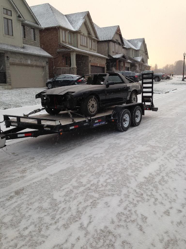

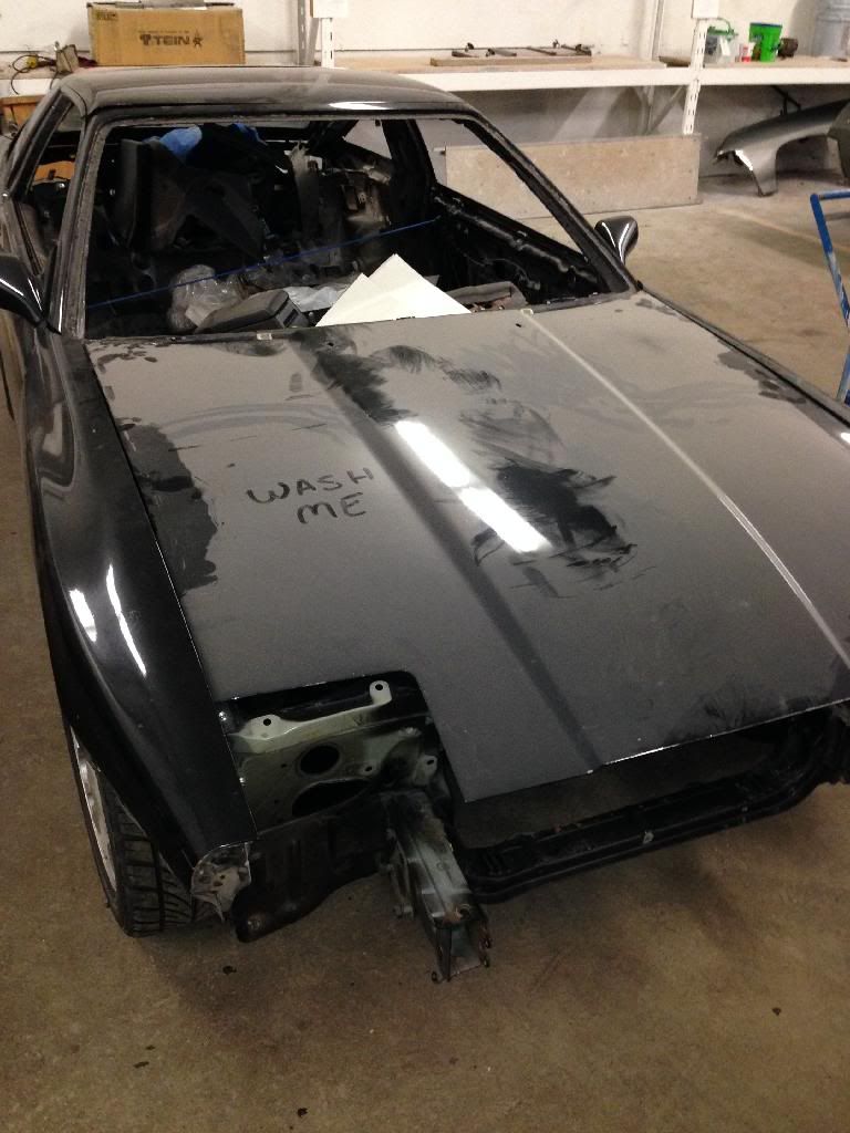

No major updates. Got the hood back on and the car home for the winter. I'll be working in things over the winter, then taking the car back to the shop to finish all the body work.
