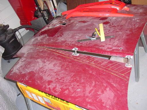

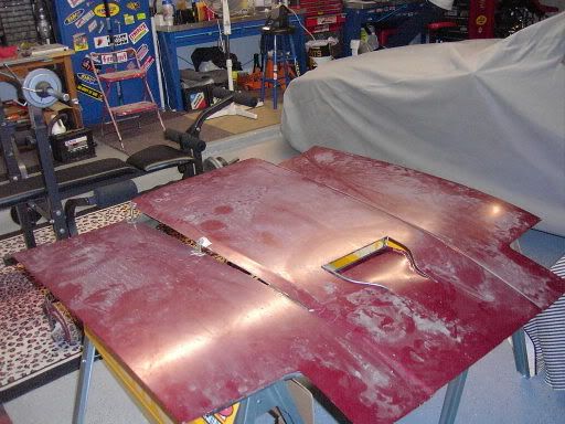

On a more positive note I made some nice progress on my hood today. I got the support structure modified to account for the lift, and was able to get one side mostly completed. Here are a couple pics of the progress.
I cut at the bottom of the cowl from the back to about 9" short of the front.
I then raised the hood 2 inches in the back and 1.5 in the middle. I used sheet metal to brace it in position. Note the right side I already started to bend down the cowl side so the angle would be right.
After making a cardboard template and cutting out the sheetmetal to the shape I wanted, I simply tacked it in position.
A different angle showing how much higher the cowl is.
Another angle.
On my parts car just to see what I think of it. I likey, but I still need to add the extension to the back. Im going to extend the back lip out over the windshield wipers a little.
Its supposed to rain tomorrow so I dont know if I will make much progress tomorrow. But I should at least be able to get the other side tacked in place.
