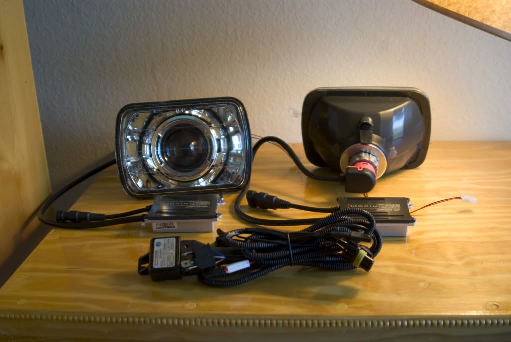

nerfkhat;1769721 said:
Rodel and i believe nick have low profiles. I myself have same setup(hella 90mm). I havent driven car yet so couldnt tell you difference between stock and the 90's but from what ive seen from testing i think its gonna be pretty nice. Have a hid conversion waiting to go on them too.. I also had flushmounts also (custom cf buckets). It does take some modifications for it to work and look good but if your willing to tackle the project its worth it. The low profiles allow for bigger lighting system so its gets a much better light than the flushmounts. Which dont have mouch room at all. There are a few threads in here that you can look at that have decent amount of pics though. good luck
The 90mm units aren't bad. But if you're going to go HID with them, you need to get the HID version of them, or your performance is going to be subpar. There's far better projectors out there though.

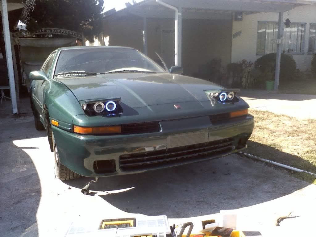

nerfkhat;1769854 said:
Which ones do you have? those are nice and output is nice too. Yea the time put into was well worth it in my opinion.
build them myself as a prototype when i have money to throw ill build a better quality one. but i am very happy with the result :)

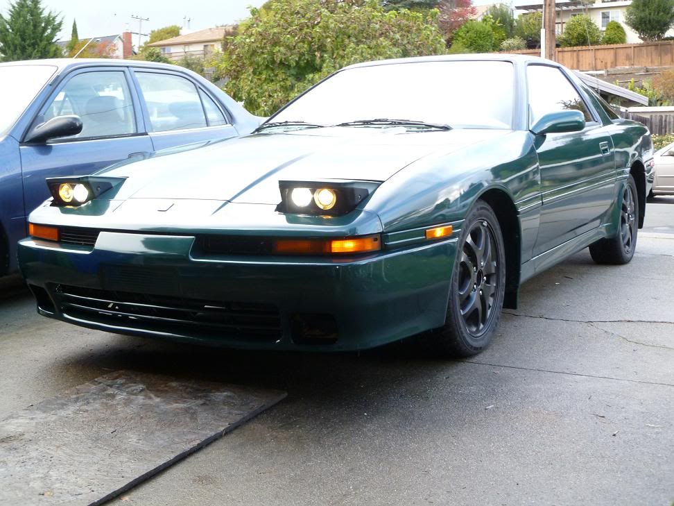

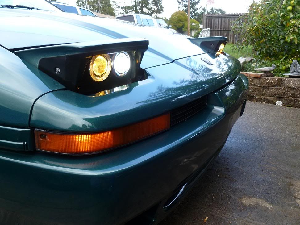

redrocco
QUADCAM
Feb 21, 2007
78
Rochester NY
I used 3 pairs of Hella Optilux 1100 Series Projector Fog Lights. I get tons of light output, much brighter, lower, and wider then the crap stock lights. I did them over a weekend for around $125. there fully adjustable and require some modifcation of the stock parts but I had no trouble doing the rework.
I came up with a formula to calculate the distance from pivot to ball mount required to get the desired hight when it comes time to change them. I will look for where i wrote it down.

nerfkhat;1769828 said:
Actually you can convert them to use d2s and its pretty good output. You can even tune it even more by redoing the shields inside.
take a look.. I have done a fair share of hid mods on my other car by modding projectors and shields..
http://firehawk.jonbroomfield.com/hidinfo/
No, the entire headlight is different. Reflector bowl, sheild, bulb holder... Keep in mind you can buy the D2S version for ~$160 a piece and buy ballasts and bulbs for cheap.

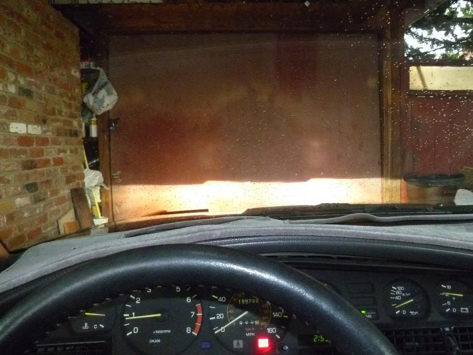

Sorry, but fog lights don't have the throw of headlights. You think it's brighter because your foreground is super bright, but that's great if you're only going 10MPH.
