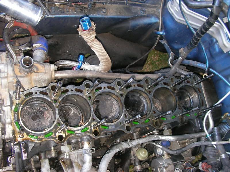

suprahero;1165417 said:
Here's what my car looks like...............AGAIN!!!!!!!
Enough green in that picture to make it look 7M. Good thing it's all in the correct places.
