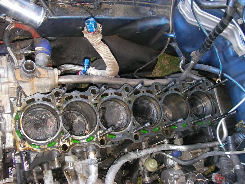

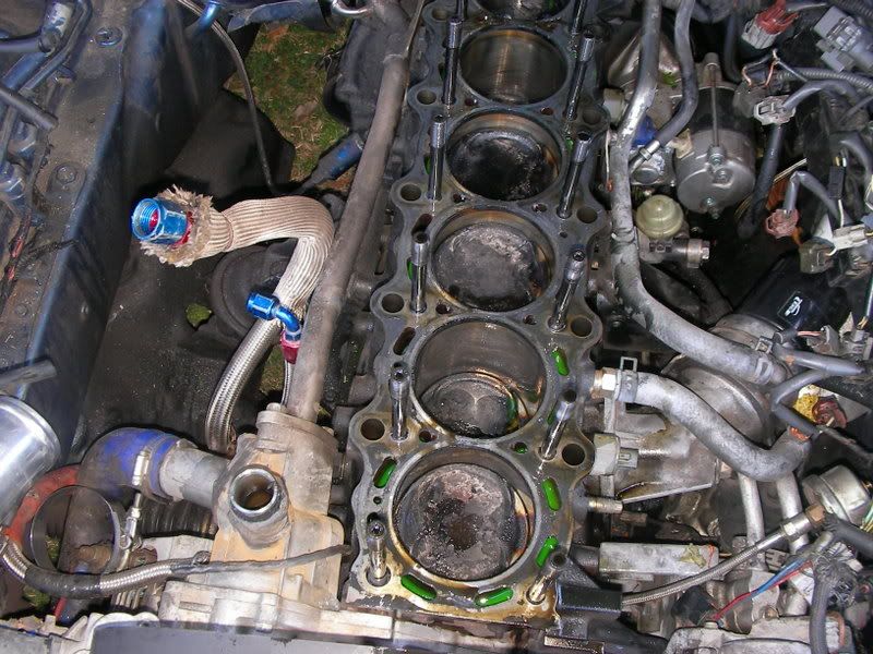

Update
I think I've found my problem. I took my car to a not so local shop (2 hours away) and we put it on the dyno. On the very first pull the guy swears he hears my valves floating or staying open, whatever you want to call it. I have the new pt67 installed and you can definately hear it now. With the 35r I couldn't hear it. The thing showed a constant boost pressure of 13psi which I guess is the magic number for the valves to stay kept open and the air is flowing straight through the intake and out the exhaust..........I dont know how the head works, but that seems to be what is happening and that's where my boost is going. I'm removing the head right now and I"m going to take it and have the seat pressure checked to make sure it's what Crower calls for. I googled it and came up with 1.325" @ 80lbs / open .980" @ 158lbs. coil bind .810
I'm going to go get the numbers off of my Crower box and cross reference it to make sure they're the same for my 1jz springs and retainers.
Just thought I'd let you guys know what's been happening. Hopefully this will fix it and thanks again for all of your help.
P.S......the car made 413rwhp @ 13psi.

sounds good. what are your air fuel ratio's like when the boost is "lost" you should see some result on a wideband at that point if your hypothesis is true...from the fresh charged air going out the exhaust.

IJ.;1165369 said:
How so Steve it's still injecting fuel?
J: Only thing that made sense to me so <fingers crossed>
(called it awhile back but new springs had me doubting my diagnosis)
Yeah, I remembered you mentioning it. That's why I sent you the first pm letting you know that I think I'd found the culprit.

Easy fix if that's the problem J!
(can't understand how they could get it wrong though, only thing that makes sense is the wrong set of springs and they weren't checked for seat pressure before assembly)

Here's what my car looks like...............AGAIN!!!!!!!
I'm taking it to the machine shop tomorrow. I'll be picking it up thursday, but I can't put it back together until my new gasket set arrives. I've reused these cam gears and gaskets for a while now. I think it's time to replace them.
Ian, do you know where the write up is of how to clean the metal head gasket. I remember reading it on here. Someone can just tell me how to clean it if they know. Thanks. If not, I'll look it up. I know it's on here somewhere.
Well, I cross referenced the box that they came in and they're for the 2jz head. I have the 1jz head and I think the valves are different lengths. I ordered them from Zazzn and he sold them to me as 1jz upgraded valves and springs. If the machinist can't make them work then I still have my stock springs and retainers that worked flawlessly on my first build. I can reuse them until I decide I need some stronger ones. I'll let you know what he saids after he looks at it and measures everything.
