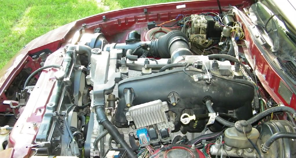

Exhaust is 3" straight through to a magneflow muffler. It is dead quiet at idle and instantly turns into a braaap with any throttle application whatsoever. I guess that's the exhaust cam phaser doing its thing. Not sure how long I can go like this without a ticket.
The transmission had to be pulled again. This entire time, I started with the assumption that my flywheel had the same dimensions as a colorado flywheel. In fact, it was offset by about 19mm from the coly version. This resulted in a lot of trial-and-error. I think I put the trans in 3-4 times and had 3 settings for the slave.

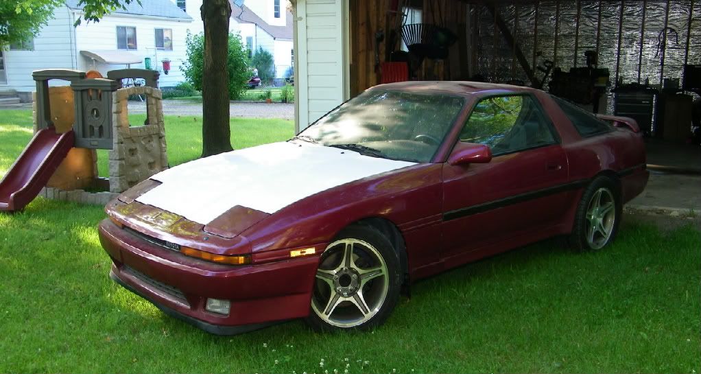

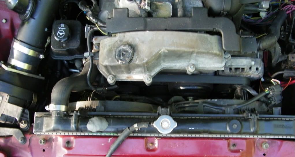

The hood latches! But just barely. To get this far, I removed the intake resonator, removed the MAP sensor mount, shaved my oil cap, trimmed the radiator, lowered the PCM, and removed a support from the hood. I still have up-dings :) You can't see the up-dings in the pics, but you can see that the passenger side of the hood doesn't close flush. At this point, it is hood sheet metal contacting the TB and the cam phaser cover. Not a lot more I can do without a load of custom work.
The video above was literally the second time I've driven it out of the drive way. The first time it fell on it's face trying to shift an automatic trans that wasn't there. This time, I tested the engine a little bit. The torque is impressive, but ultimately, I don't think I will be satisfied without forced induction. More later.

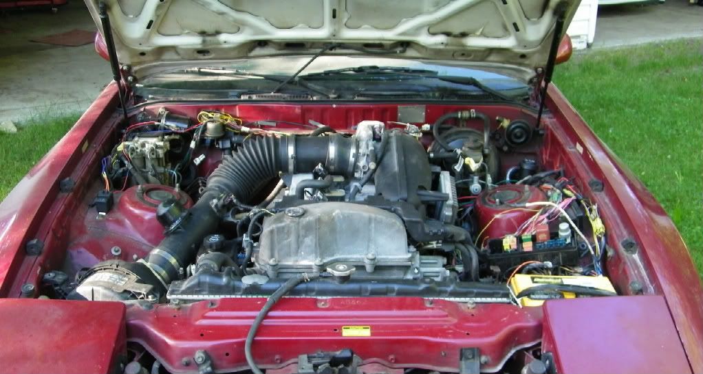

I've been staring at those last engine-bay pictures, and scratching my head as to where in the hell you'll be shoe-horning in the snail. Has any real plan been composed for this yet?

Yep, I have a plan :)
There's tons of room once you pull of the intake tube. The engine isn't much wider than a 7M.
