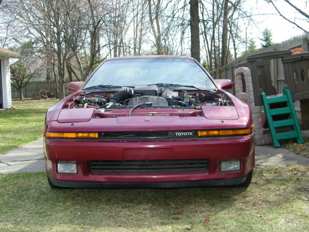

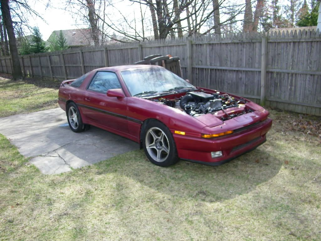

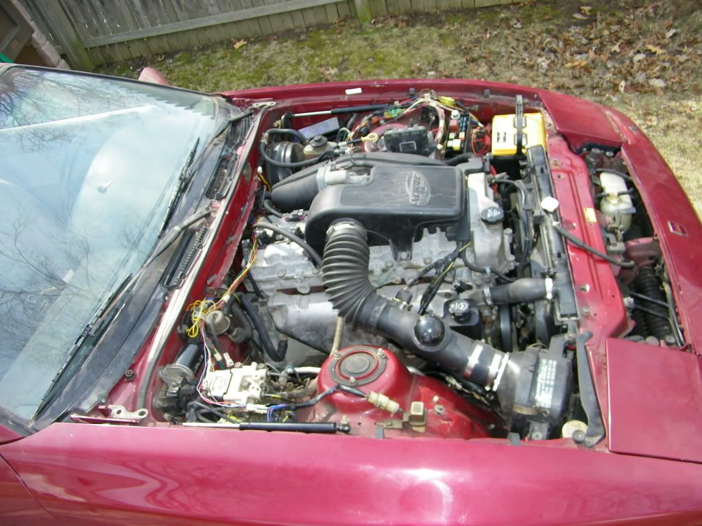

Been a while since I posted. Here's the latest.
Exhaust is hooked up. I swapped springs with the white supra to get the front end off the ground a bit. Maxima radiator and fans are in. The upper radiator hose is a trimmed maxima piece, the lower is a trimmed trailblazer piece. The power steering is hooked up (turns out the stock Supra lines will work with some effort).
Still have a lot of small things to work out. The fan pullley bolts are hitting the fan shroud, making the car sound like a lawn mower with an exhaust leak. Clutch isn't disengaging fully. Hopefully just needs to be bled better.
