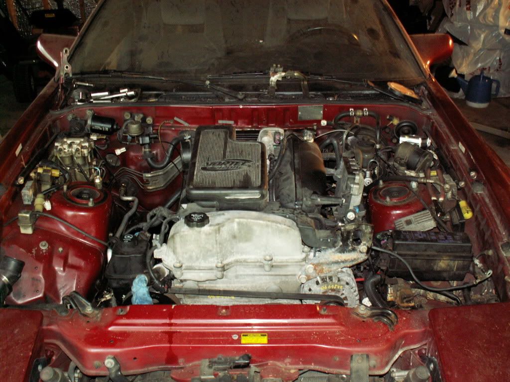

limequat;1575860 said:
Yep, I have a plan :)
There's tons of room once you pull of the intake tube. The engine isn't much wider than a 7M.
Right after I steal one for myself. There's a lowered white one w/black wheels running around here. Looks hot!
---------- Post added at 10:09 AM ---------- Previous post was at 10:09 AM ----------
I'm still curious. If you have one, would you mind tossing up a picture with the intake Tubing pulled?

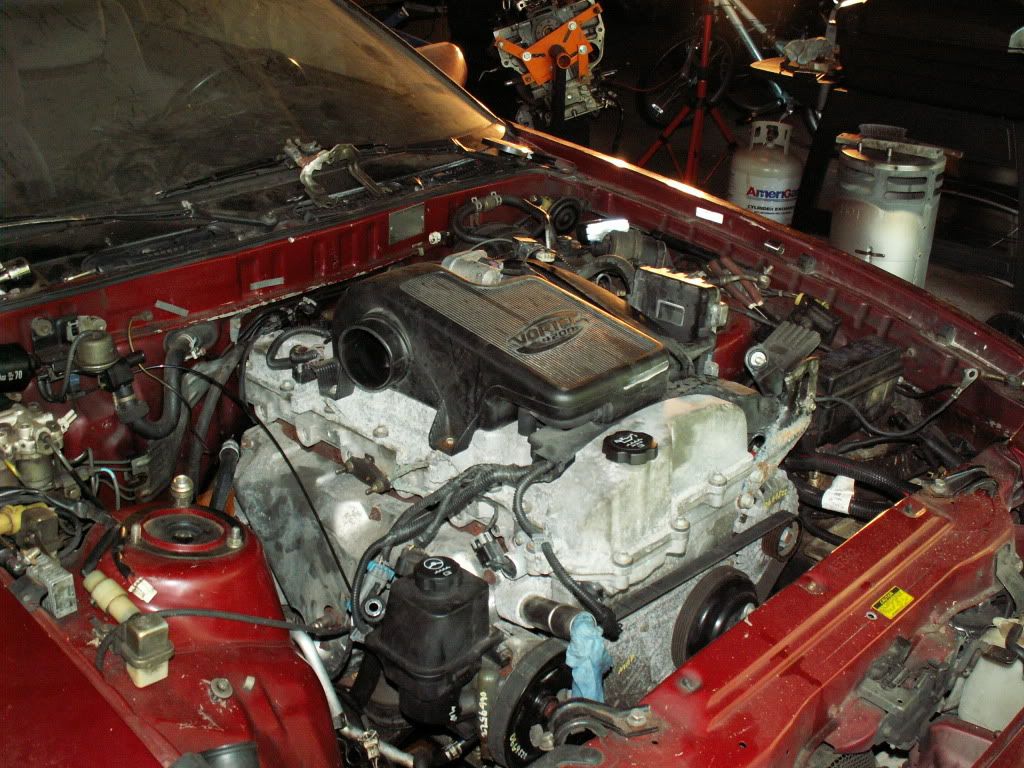

Here's the turbo hole:

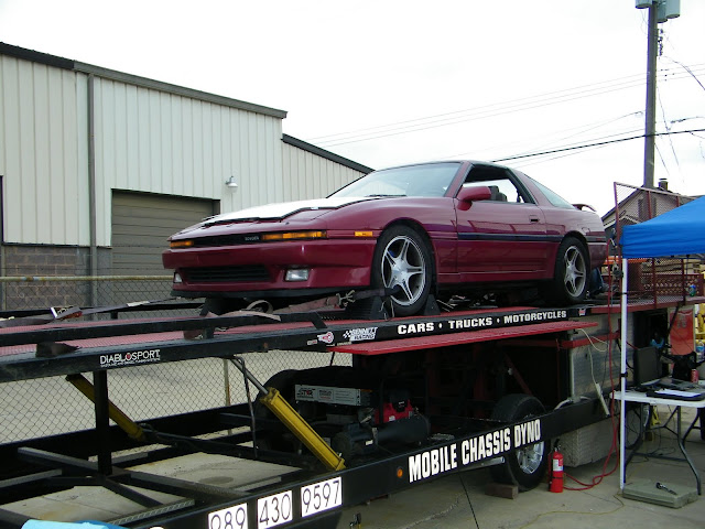

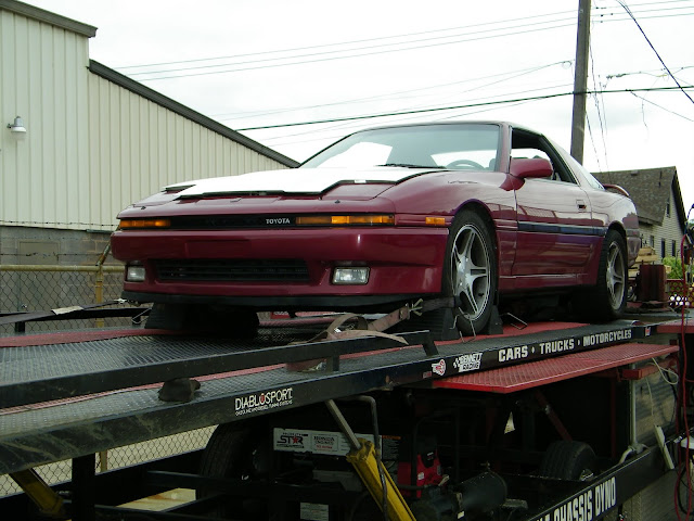

Patience while I get my scanner fired up ;)
I will say that it was significantly more than the stock Trailblazers put down.

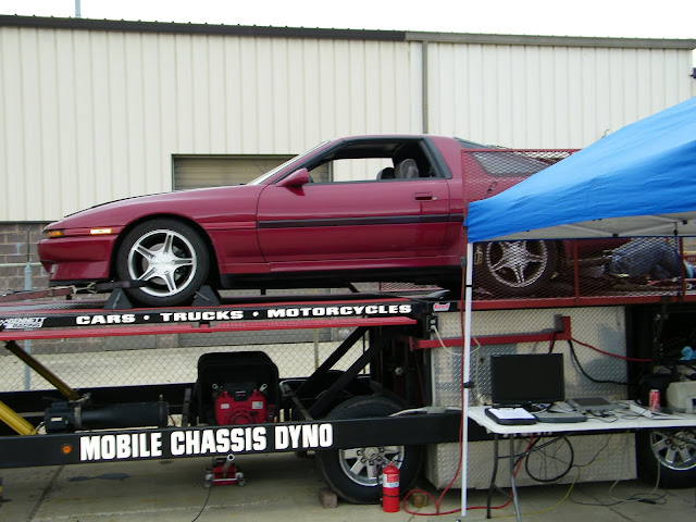

250 HP. I feel pretty good about that since the stock trailblazers put down about 200-220 HP with an automatic transmission.
The red curve is with a stock trailblazer calibration with just enough codes turned off to let it run. Unfortunately, it didn't occur to me that the dyno would run the car into the 98 MPH speed limiter, so I didn't get a full baseline.
