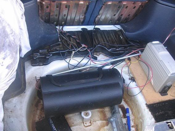

here is the setup I got going on
The sub enclosure is made from Sewer pipe (25" OD 23.75" ID PVC)
Top and bottom are made from 3/4 MDF
its a 4"X~12" port
12" dual voicecoil @2 Ohms in series
