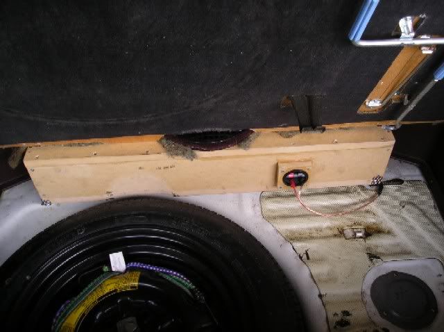

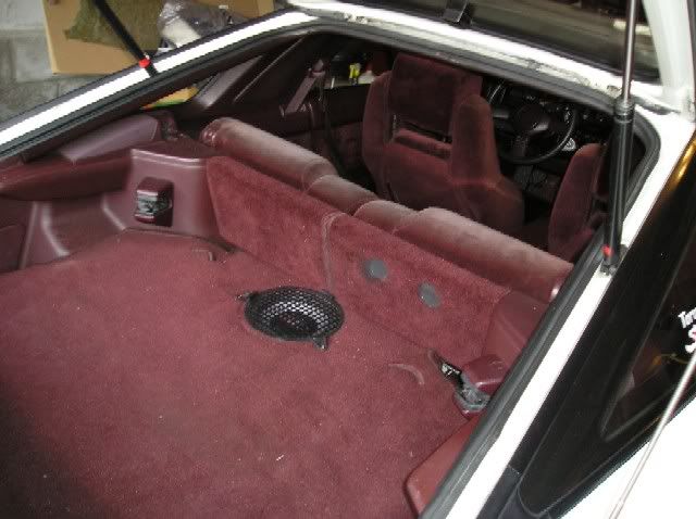

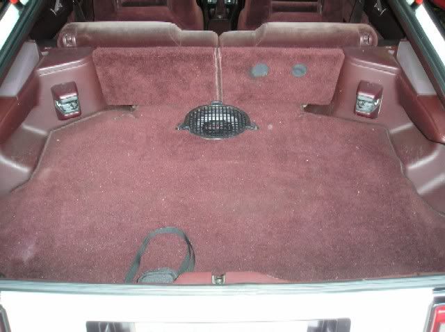

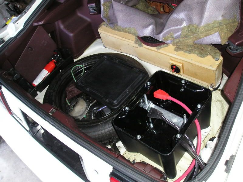

Small woofer -8"-, but everything fits like stock. Spare, targa, tire change tools and all that jazz. It won't push your head intot he windshield, but gives a nice bump that fills the low end nicely. The amp, xover and a relay arrangement are mounted behind the seats in those enclosures. The 2 black spots are a couple of fans to help cool things as they are pretty tightly contained.
Some pics before the battery relocation, some after. You get the idea...
