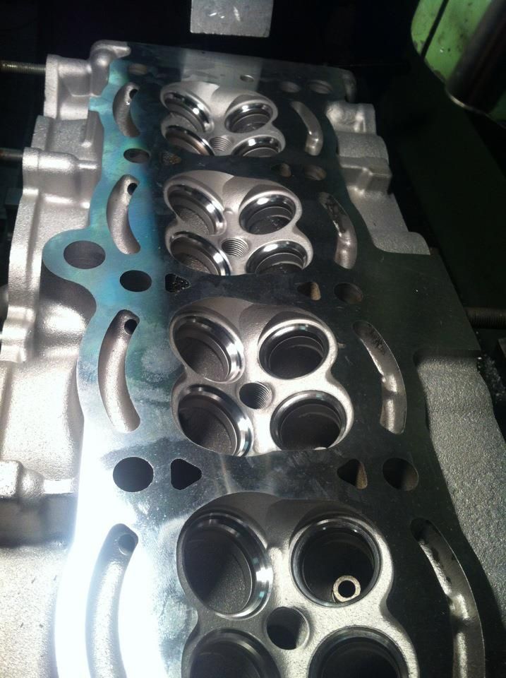

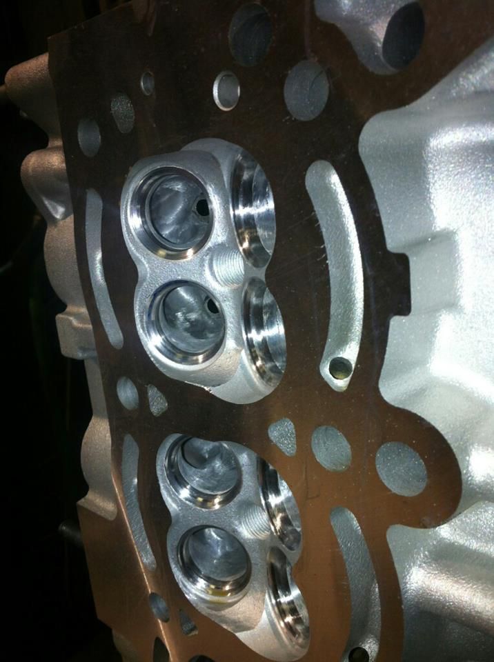

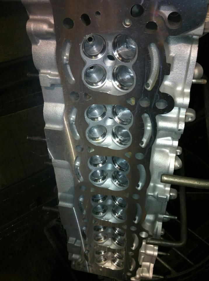

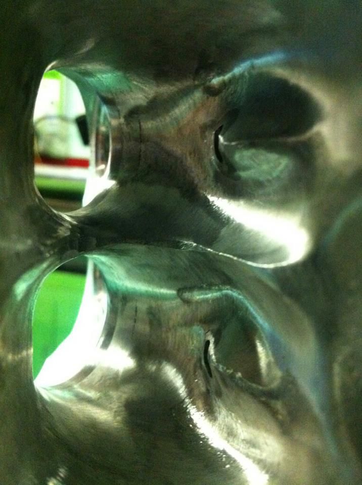

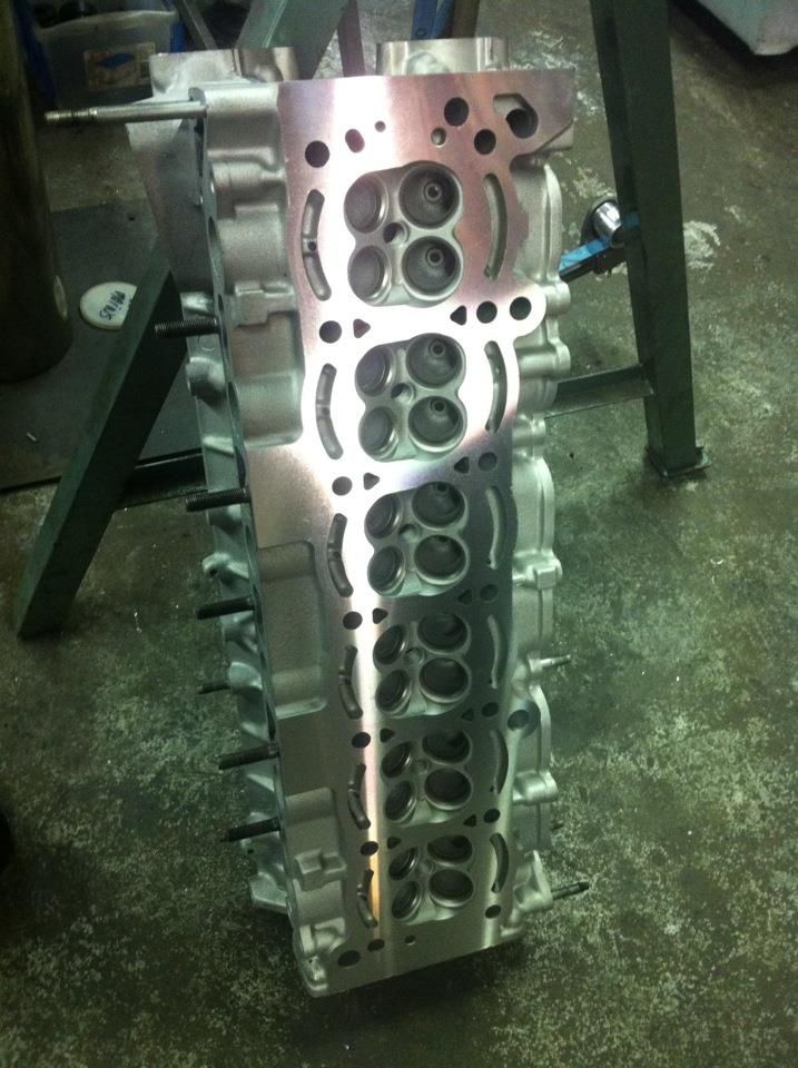

So my head is almost done
Getting the following:
Milled
Wicked port job(by a friend with 1k hp 2j who built his motor lol)
3 angle exhaust cut
5 angle intake cut
Comp cam valve springs(BBC inner springs)

BoostMonger;1891132 said:
Can I have? I made a mess in my pants
Why yes you can. For a price :)
It started out as a simple valve job, mill and reshim.
He has since decided he wants to do some major work on porting it.
He estimates 80-100hrs in it just for porting lol.
Now i may have to go for more hp :)

Thanks rx7nut for explaining my choice.
I don't want to pull a motor for a metal head gasket if I'm going to be keeping a stock bottom end for now with no extra money for a rebuild.
If it blows again then I will replace it until I'm ready for a complete rebuild
I will say the headwork that I got done. Really helped with low end torque

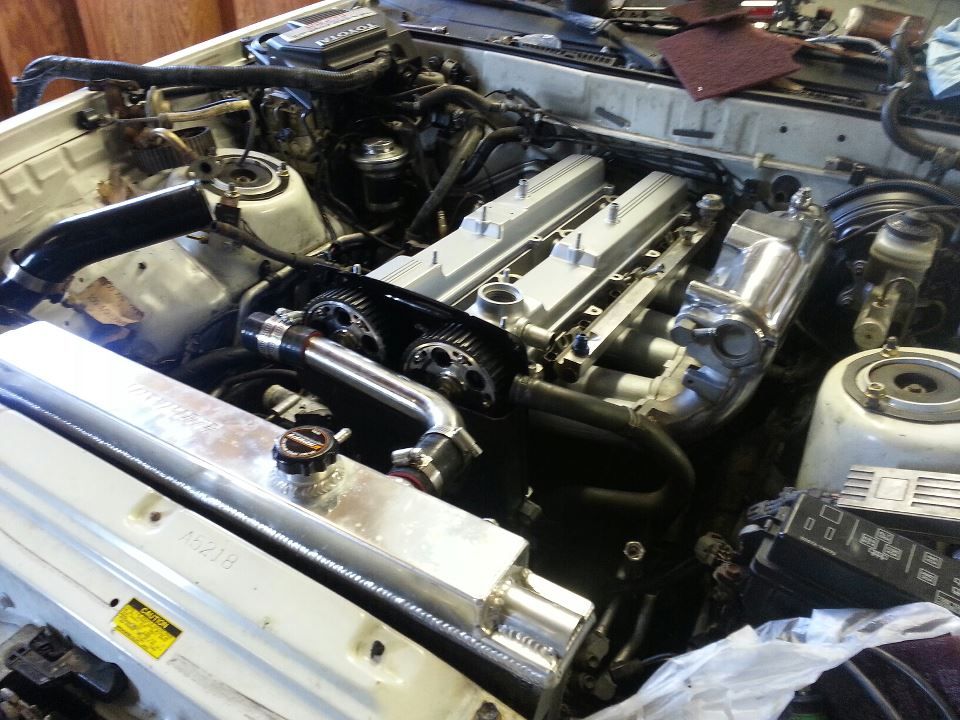

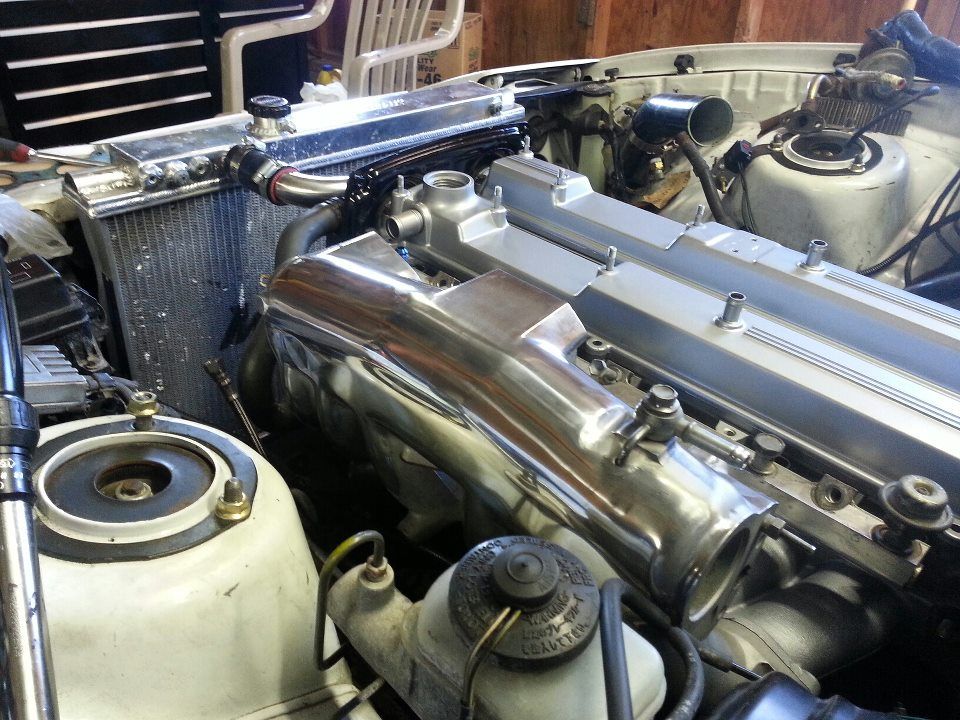

Ok so here are some update pics

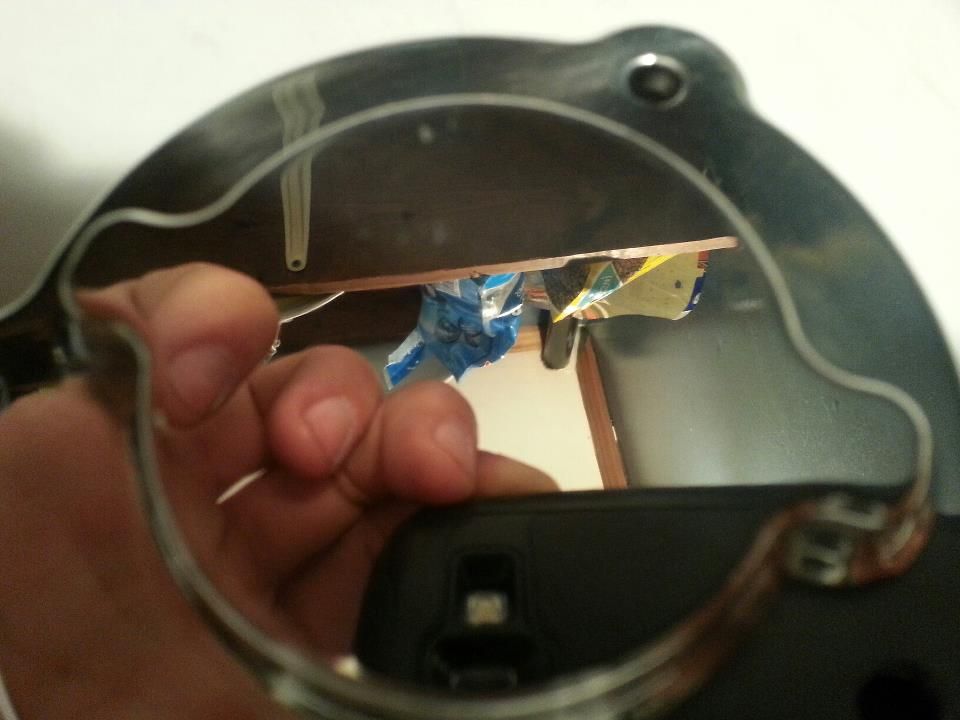

My billet cps cover that i polished up:

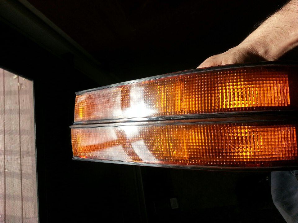

My turn signals that i polished up:

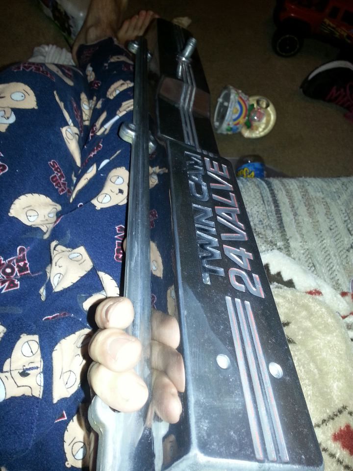

My n/a valve cover that i polished up(will be installed once i get jz coils and possible ffim)

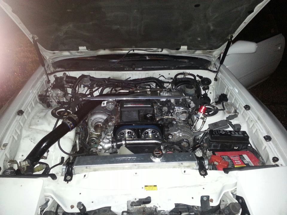

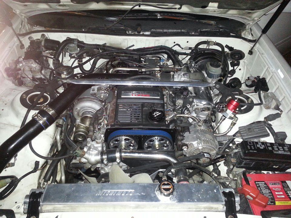

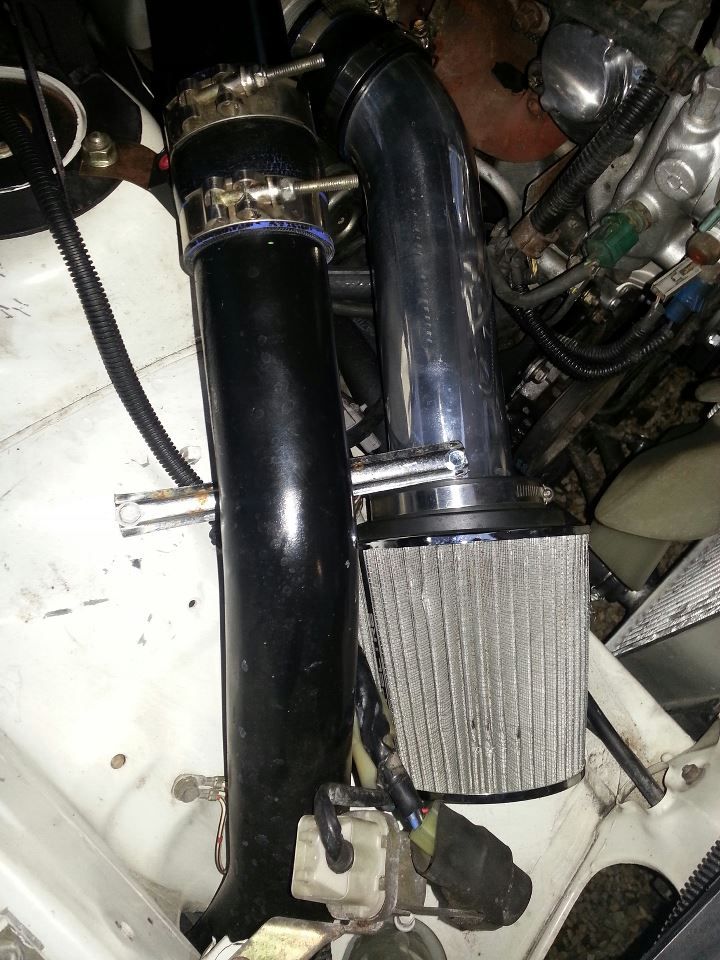

Now for assembly. My fan shroud was cracked and would cause harm if it broke so i kept it off til i buy new. Mounted air filter so it wouldnt hit fan blades
