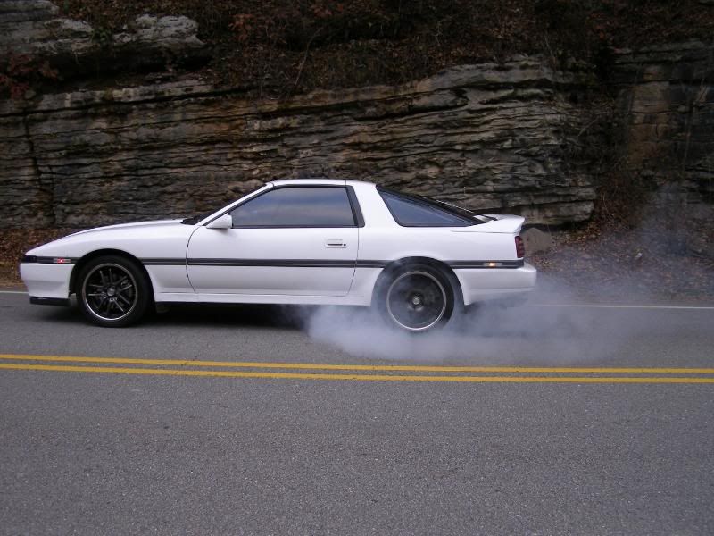

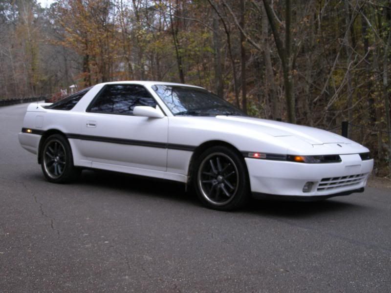

I took Vonda's car out for one last drive before I tear out the old turbo. The new turbo should start going on sometime tomorrow if I get through with work in time.

Should be quite fun with that turbo Jay.
Great pics what kind of camera you using?:icon_razz
Did you hit your head on the steering wheel when you came out of boost? It's your camera silly and you took most of the pictures. I knew getting old was going to be tough, but you're scaring me now...........:biglaugh:
53
Thanks for the other comments as well, and Jeff, I'll take pictures as I go. They probably won't be as good as the one's George's camera took, but hopefully they won't be in black and white.
