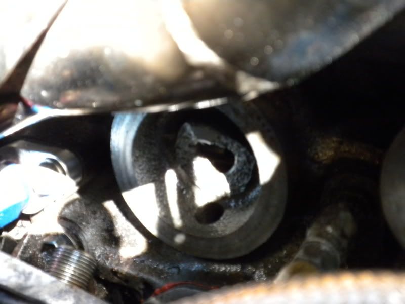

I'm not going to Texas. My car is in the shop being painted, it was suppose to be done by now, but it's not. Vonda's broke today while putting it on the dyno. We noticed the bolt that threads into the block was stripped and the threads have broke off inside the oil filter location. I don't know how this happened or why, but this car is truly posessed. It doesn't like me not even a little bit for some reason. Now I'm either going to find another block to build or install the 1jz that I have. I'm not sure what I want to do yet. I've given the 7m many many chances, and it keeps failing miserably. This isn't a mechanical issue technically, but it is an issue and I've spent soooo much money on Vonda's car trying to make it run faster than our local LS1's and musclestangs.

WOW, thats a didferent way to kill it! Did it leak out the oil or what killed it exactly?

That sucks..So the threads in the block are broken where the oil filter screws to? It could have been overtightened at some point.
A JZ swap is probably going to cost you more in the long run than finding a new block and putting it together. Not to mention you could have the same problems with the 1j as well.
Take some pics of whats broken. There could be a chance it's repairable.

I'll take some pictures of it once it's out of the car. I don't really want to try and "fix" it. It's way beyond repairing and I would be a nervous wreck thinking it was going to come off again and lose all of her oil while driving it.
Reaper.....the motor isn't hurt. The oil was pumping out, but we were just idling. We never even strapped it down. The internals are fine, but now I need to find another block.

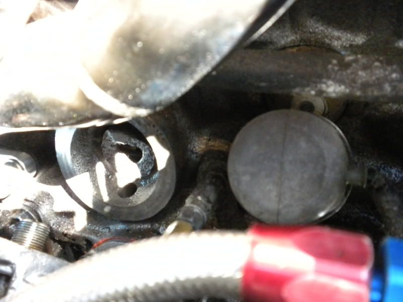

Here are a couple pictures of the carnage with the engine still in the car. If you look closely, you can see where the cast broke off.
I'm in the process of removing the engine now. I'll probably end up getting a 7mge and having it rebult with these parts from her gte.

This is the fifth time I've seen that failure on a 7M in the last 20 years. Once during assembly after a rebuild, twice in the car shortly after a rebuild, last one was months later and now yours. How long has this motor been in the car? Was the block hot tanked before assembly? I'm trying to figure out if there's anything that these five incidents all have in common...

The blocks been in the car for about a year and a half Mike. In that year and a half, it only has a few hundred miles tops. The dreaded code 52 had it parked for most of that time. Vonda would drive it on pretty days but we just didn't get into boost with it very often since it had no power. I finally got the code 52 fixed and decided to put the 35r on it. That started about three months ago, but I kept having trouble with the manifolds. Finally got everything together and decided to take it to get tuned. I only drove it for about five miles around the house before towing it to the dyno........in case something went wrong.
When it was rebuilt, the machinist put the block in a vat and he cleaned it twice. I guess that is the same as hot tanking it, but I'm not sure. Unfortunately for me, I can't find a gte block anywhere locally, but I have five ge blocks to choose from. I'm hoping that I can make one of those work without too much extra work.
