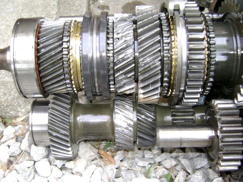

Alright gang, Ive posted some of the pictures of the failiure that happend in a little bit more depth then stretch did.
Basically the low down of what happend. I turned on US 31 about a mile from the kroger parking lot, with fresh 110 octane and new tune provided by Mr. Scott Hennessey and eased in 3rd gear, hit full boost (might i add this was only at 22lbs not 28) and then just MASHED 3rd gear to, obviously pieces.
Got it put back together and running now but this would be the reason i didnt make it to the indy meet :(
PS: 1st picture - close up on mashed gears.
2nd picture - those mashed gears teeth falling out of the gear housing when taken apart lol
3rd picture - another close up on gears.
4th picture - cleaned and good set of gears to go back together.
5th picture - ready to rock.....a day and few hours to late though :(
Is it a w58 cuz there are known to rip all the teeth off 3 and yuo usaly slam 4th thinking your spinning and kill 4th also. Hense why i went r154
mkiiSupraMan18
Needs a new username...
Apr 1, 2005
2,161
United States
It's deff a r154... I doubt anyone makes a triple plate clutch for a w58. LOL
Seriously matt, you'll go through trannies like oil changes... Some squaregears may help IF anyone even makes them...

How much power are you making that your tearing r154's up like that? And how hard do you shift or powershit it?

mkiiSupraMan18
Apr 1, 2005
2,161
United States
His clutch is either full engage or full disengage... There's no slipping it, so you have to rev the engine to prepare to move the car, then it jerks like a mother as you let the clutch pedal up the full 1/8" to disengage... The old rear subframe should be hint enough. One the trans prob is fixed that's going to come back.
All that said, it's a sweet car, but unless he starts buying these in bulk it's gonna be a 700hp lawn ornament waiting for the next trans to get shipped in.
You should be able to get a single disk a: a beefy pressure plate that will give you a little clutch pedal and take the shock out of your drivetrain.
Yea i know i know, quad disc is BRUTAL...Im still thinking and deciding what i wanna do...I doubt theres anyone out there that would wanna buy a OS-g Quad disc. lol. Thats gonna be the only way i can afford to get built R154 from marlin Crawler ((spelling)) and another clutch ect.
I just cant make up my mind, 3rd transmission has got me thinking though lol. Im not bent outta shape either i saw it coming, but no need to baby and postPWN something thats GOING to happen, so why not just have some fun lol.
It is for sure the clutch though rippin through rear ends and transmissions, i do know that. But to compensate im going to also drive it less.
Thanks Steve for the suggestion i spent a good 30-45 minuites on the phone with Aaron at Drift motion about that option. Just gotta make up my mind and SOON. lol
