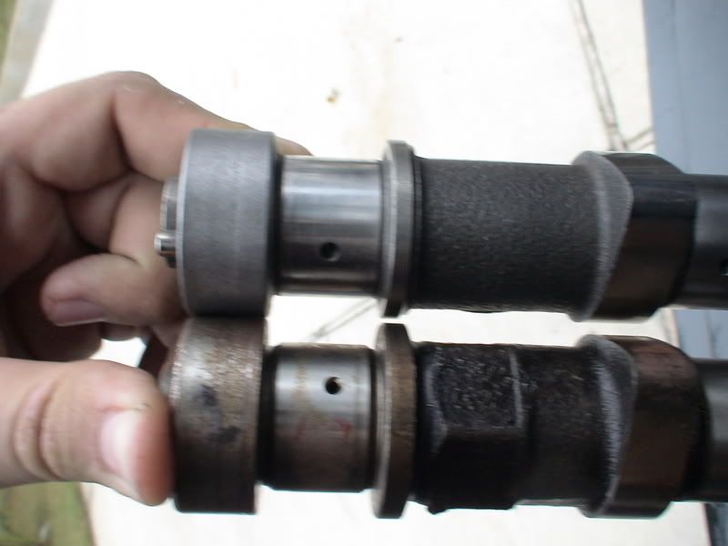

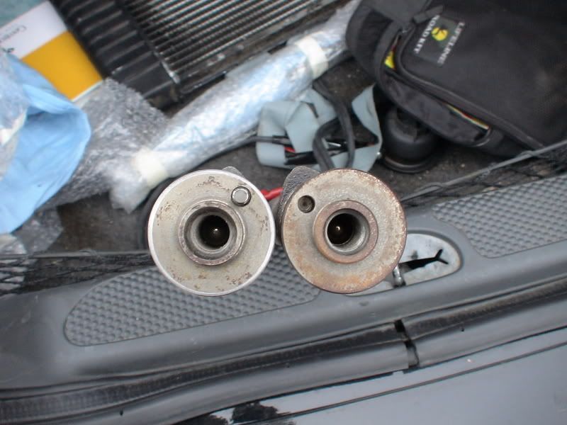

cams will be out to you today man heres two pics i snapped before boxing them back up
1JZ cam right, 2JZ cam left
2JZ top, 1JZ bottom
2JZ top, 1JZ bottom
You Da man :icon_bigg I just got the Stinger from Arron as well so now i just have to start puttin it ALL together.
