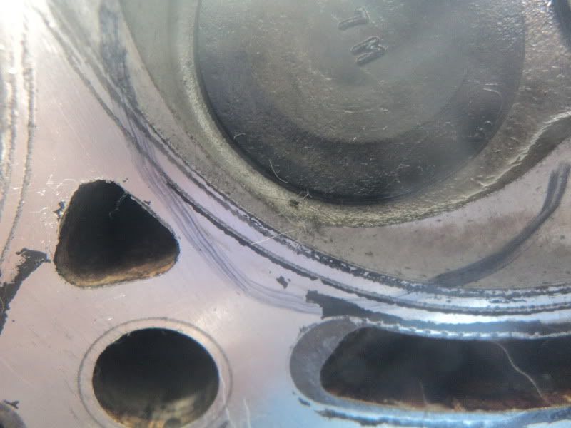

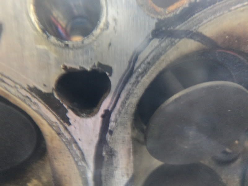

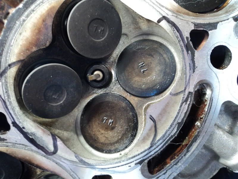

cleaned my head found this
pretty much knew what happen now
biggest question now is this head now junk ?
kinda bumbed right now since it will mot likly get replaced or all ground away and reweled
tig321
Mar 13, 2006
151
Edmonton/Victoria
Is this the same head you already had repaired? I'd forget about another attempt at another fix. find good used head, that ones just going to do it again, don't you think?
