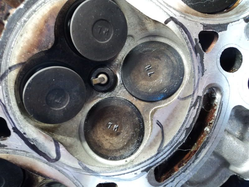

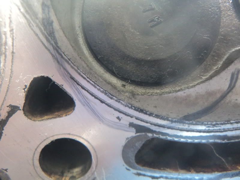

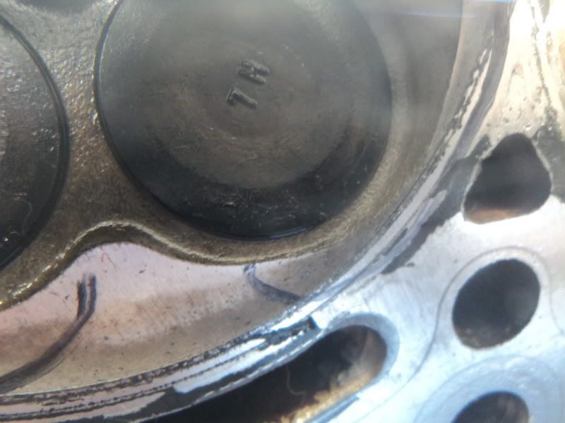

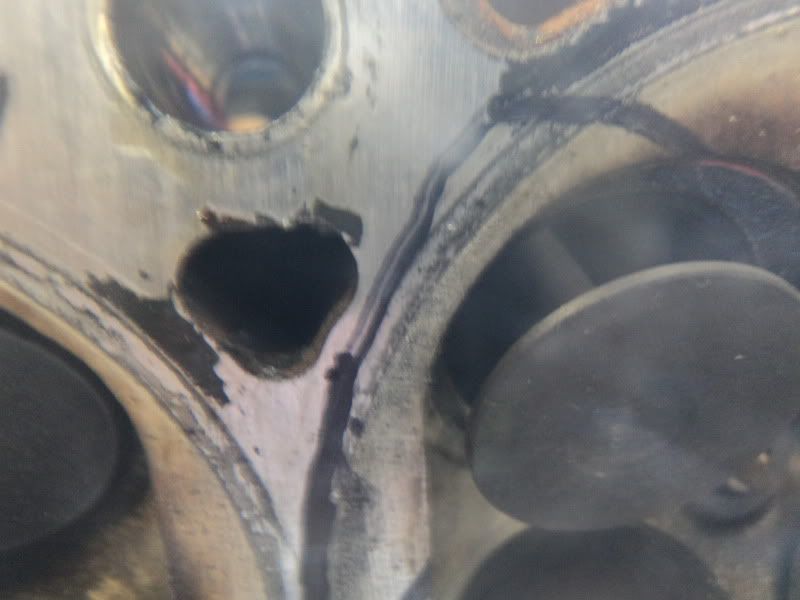

NashMan;1752715 said:
cleaned my head found this
pretty much knew what happen now
biggest question now is this head now junk ?
kinda bumbed right now since it will mot likly get replaced or all ground away and reweled
Can someone explain to me what I'm looking for? Was it the sharp edges that helped detonate it?
NashMan
WTF did he just wright ?
Aug 5, 2005
4,940
17
Victoria BC
^ No it was not, you don't wana touch the pads in less using custom fitted pistons to match what ever you are doing
thous rough marks are from detonation
