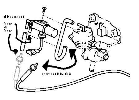

Try this....
That bypasses the VSV so it should stay open, If you get heat after you change those lines your VSV is dead.

Lol I know I know. Ur just a busy man. I just tried that tho and it didn't work
