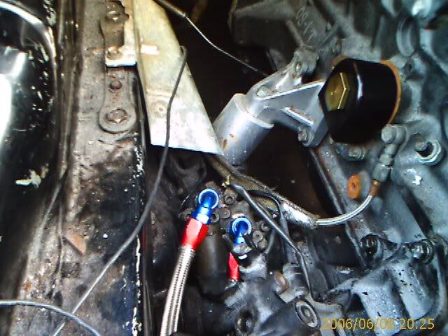

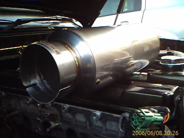

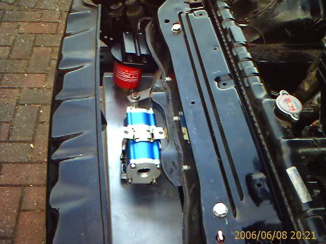

ordered oil system parts as i need to ensure they fit before i weld up the manifold and realise there is no room for a filter remote cause at that i would be pissed
so today i have ordered a burns muffler 4"
http://www.burnsstainless.com/UltraliteMuffler/ultralitemuffler.html
and some canton parts oil rmote adaptor for the block and billet black filter mount + thermostat unit
http://www.cantonracing.com/oil_cooler_thermostats/oil_cooler_thermostats.html
http://www.cantonracingproducts.com/adapters/remote_filter.html
more to be ordered tommorrow andd got my welder back from the welder hospital today cost $230
total cost today so far $1500 approx doh

Hmm, your oil thermo is set to 215...
Isn't that a bit warm, I've always figgured 180 was the "magic" temp for fluids...
group a supra
SPAWNING AN INTERCEPTOR
180 bit low for oil in my eyes 215 is 100c dead and well for oil 90-100c i always thought was a good operating temp 110+ well getting a bit warm chances are it wont get that warm all the time
reason
different car i know but my mother has a volvo 440 turbo now that runs about 80-90c oil temp on general runs but sit it at120mph for a while oil temp runs 99-101c all the time and thats a standard er well slightly modded car
chance are jake it will only get to the cooler when it is havin a caining and once going round it proabaly wont get any hotter but it is somethin i will monitor when up and running and if i feel a threat i will make changes accordingly
but i do appreciate your concern best pal :icon_bigg

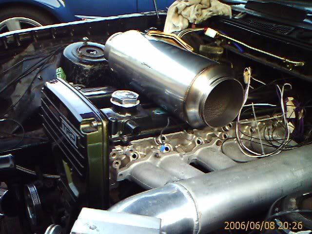

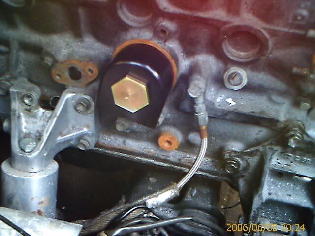

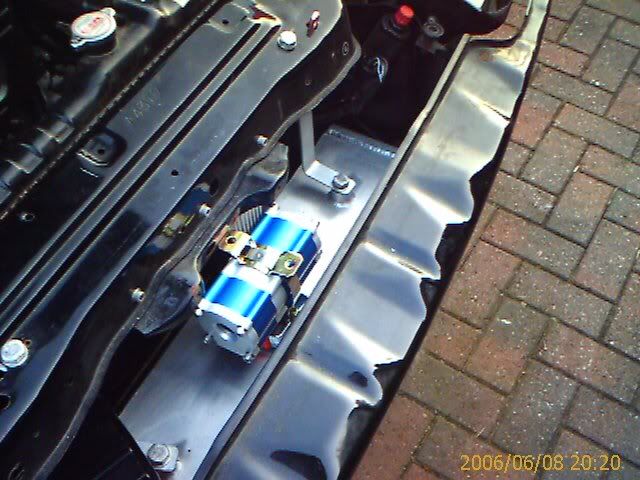

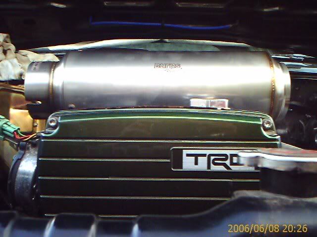

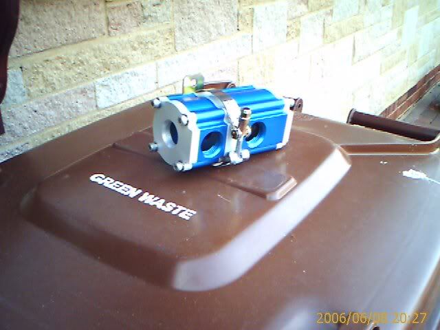

new stuff today wwhhhhhhhooooooooooooooooooooooooooo
burns stainless 4" muffler:)
canton racing oil filter relocator
canton racing thermostat and oil filter housing with trd oil filter i like these :)
and new 304 stainless flanges instead of mild steel ;)

Nice!!! Good stuff man, good to see you're doing some progress again. Couple of questions on your new gear; did you buy your TRD oil filter locally in the U.K. and how much was that?
Also how come you went for the Canton oil thermostat and not for a good ol' britt mocal unit that is like 3 times cheapper? Any particular reason? I now there must be something...:naughty:
