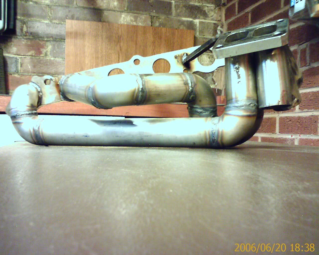

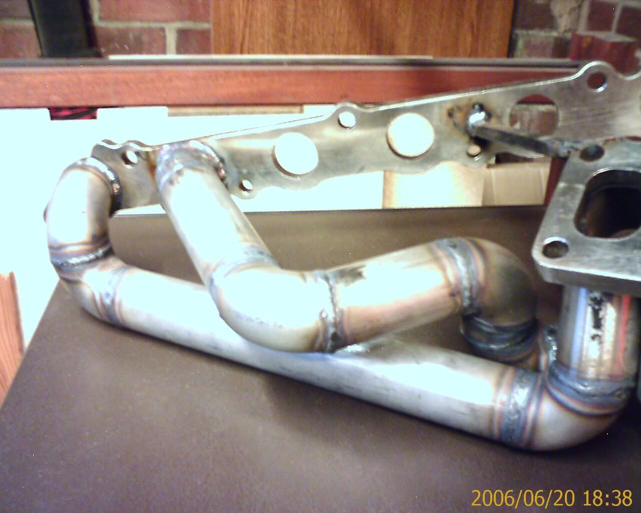

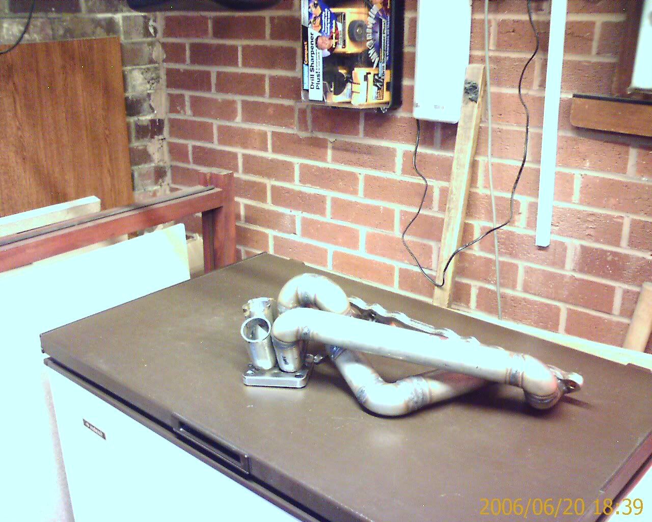

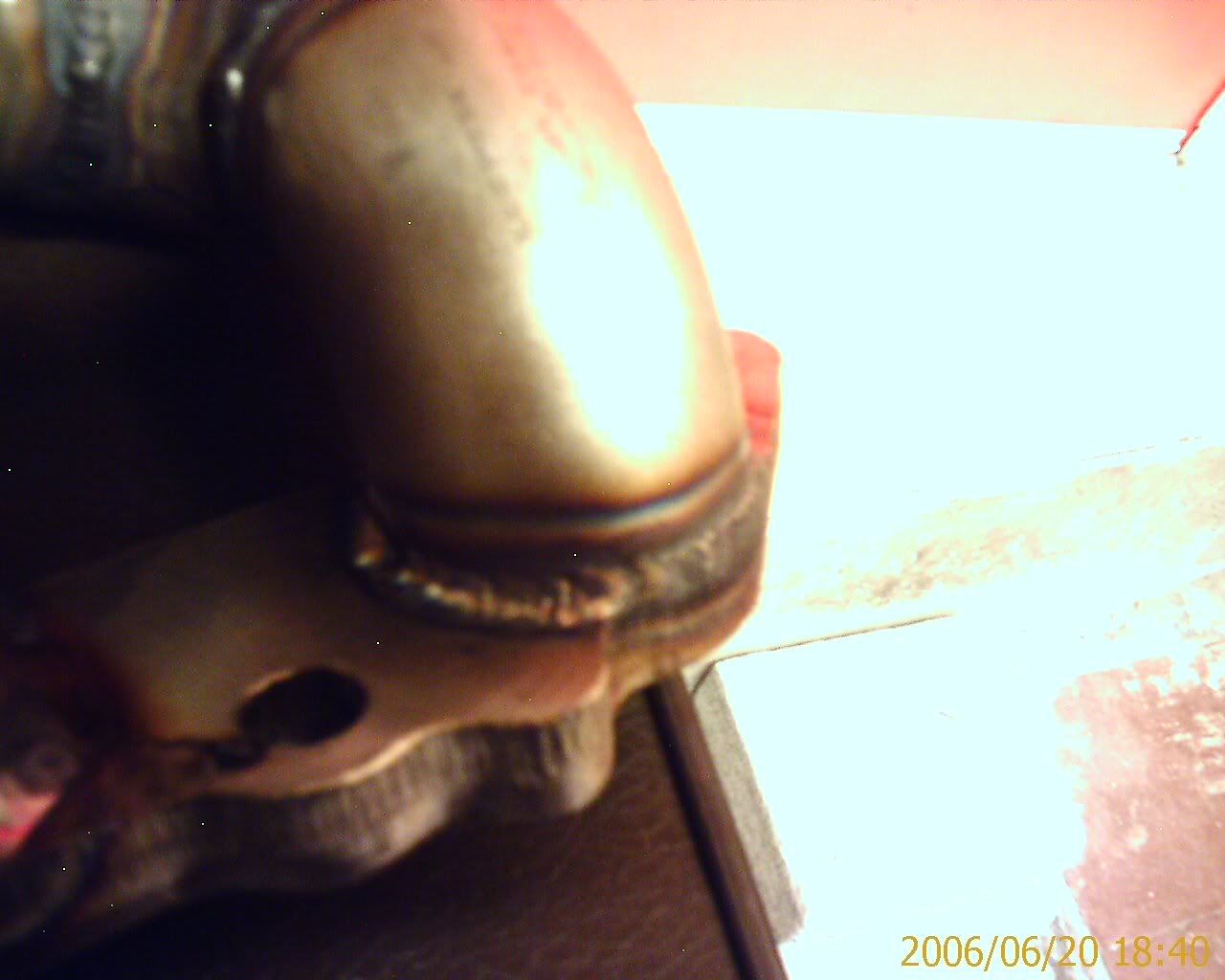

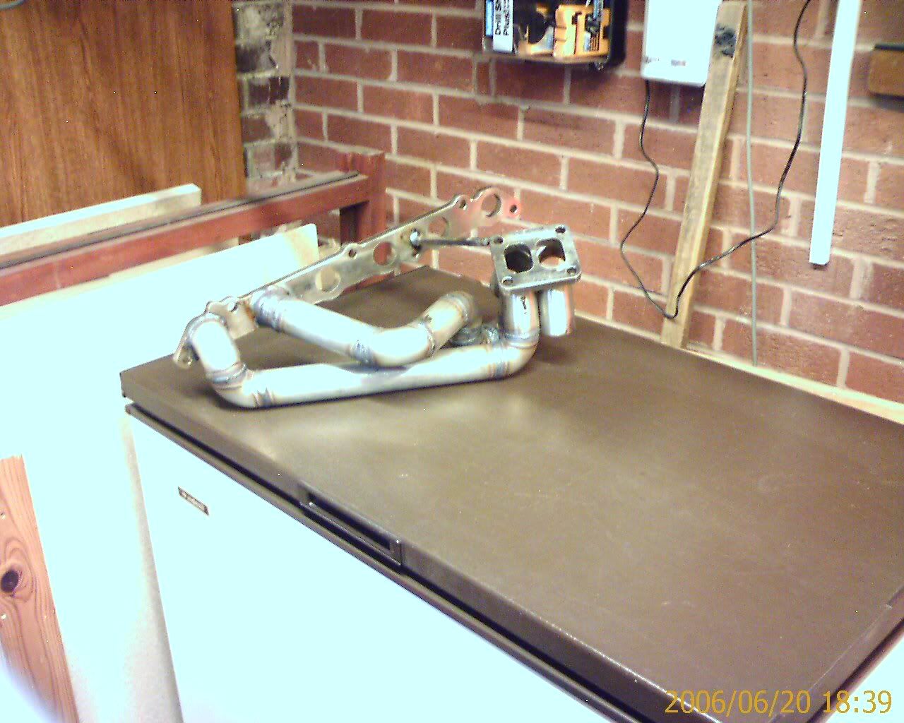

well progress today at last hhhooooooorrrrrrrraaaaaaa
the loveley kate came round to help me today on her day off she had booked not really a day as she was in charge of welding today as with the mocked up manifold i wasn't happy with a couple of small issues like hacing to move the power steering and as jake (ihi) pointed out the cps was never going to be cold either so we have readjusted the turbo flange a little and have made some improvments to the runners well we had to i couldnt get the oilf filter relocator in (doh)
so the first 2 runners are now not only mocked but finished and welded up and yes i did mock it all up first ;) ian :)
so a couple of pics for you all
