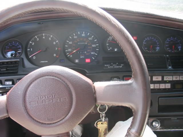

I used a light coat of oem super red II touch up paint. Comes in a little eye makeup type brush bottle.
Guyana00;1058443 said:
^ What purple gauges are those?
They're 60mm amber/white premium pro sport gauges. Camera makes them look not quite white.
