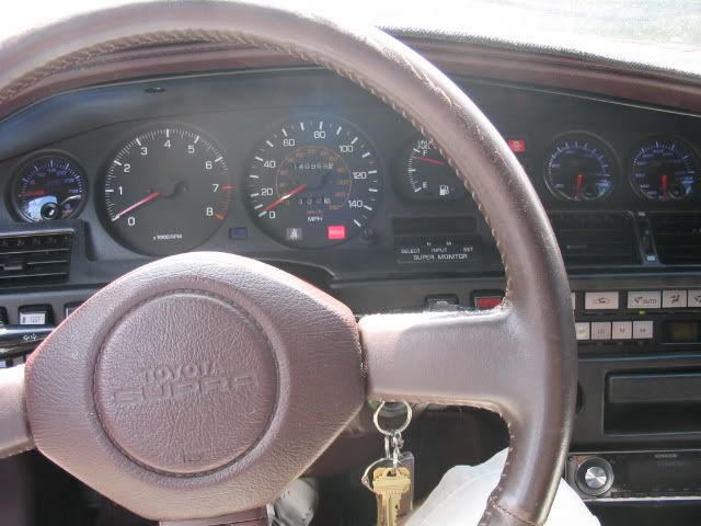

The Dude;1058438 said:
I used a light coat of oem super red II touch up paint. Comes in a little eye makeup type brush bottle.
They're 60mm amber/white premium pro sport gauges. Camera makes them look not quite white.

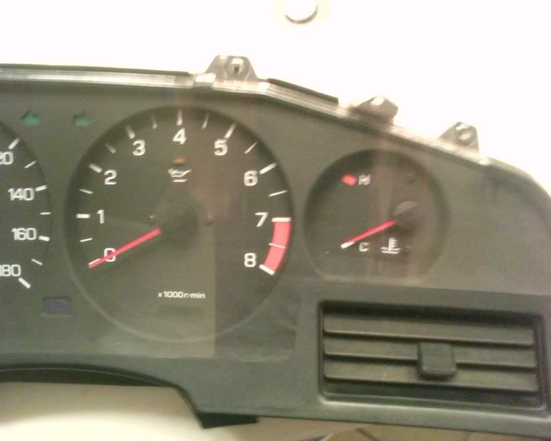

The cluster is completely stock. But there is a huge difference to me at least. I messed around at work a little bit on it and it turned out great.

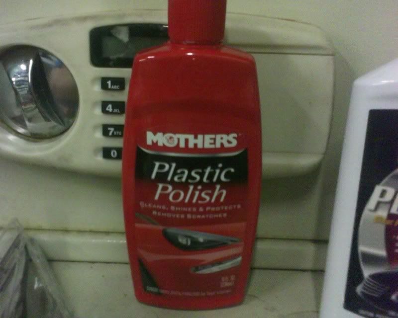

After I scraped all the orange paint off with a razor blade I put this stuff on with a microfiber cloth. It worked awesome to get it to a clear finish.

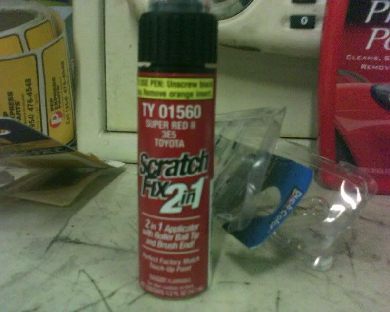

Then I put some of this paint on (Like The Dude recommended)

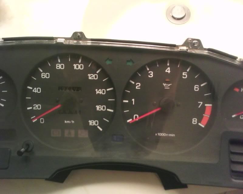

And it came out like this, (Sorry about the cell phone pics, my g/f has my camera) PS - I know the speedo and tach are a little bit off.
You can see on this one, I spray painted the middle pieces of the needles with a satin black spray paint because I couldn't get to the orange in the center.
