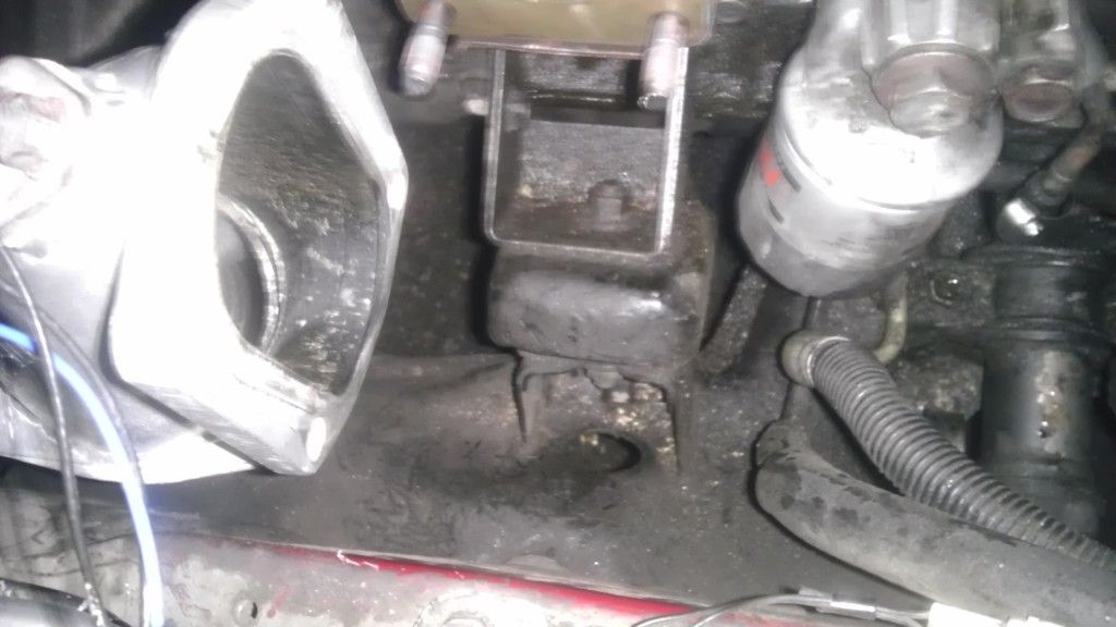

Yes it has square mounts

If I were you, get some solid mounts unless you want to change the subframe to a 89+ so you can use those MKIV mounts. I am sure you can get a front subframe for cheap. If not, maybe you can ask Albert to make you a set of solid mounts?

Driftmotion sells solid mounts I think for pre 89 so does bic ill get some.
How unlikely is it to end up with post 89 harness and pre 89 mounts?

89 bastard year. i had a similar issue with mine (not really an issue) had an early gray harness but round mounts

I have some solid mounts I can sell you. I thought I had the round mounts (because it is the 89 bastard year) while my car was getting rebuilt ( so I couldn't verify), so I had albert make me some. Found out I need the square mounts. Let me know if you are interested.

Thanks but I also need square mounts.
