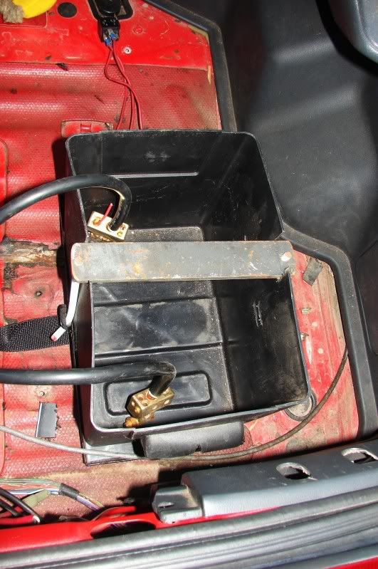

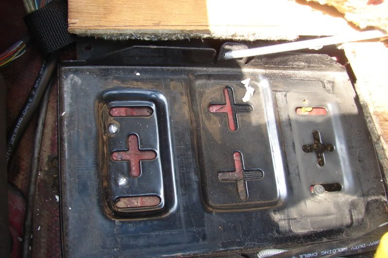

This is the under tray of the battery relocation. I am somewhat concerned about those wires running out from underneath to the 12Volt relay. I finally decided I would trust my life with this. The tray is metal, but coated with rubber. The bucket for the battery goes on top of this, and is thick plastic. Where the wires run, there is a little room (finger tip), and the wires don't get pinched.

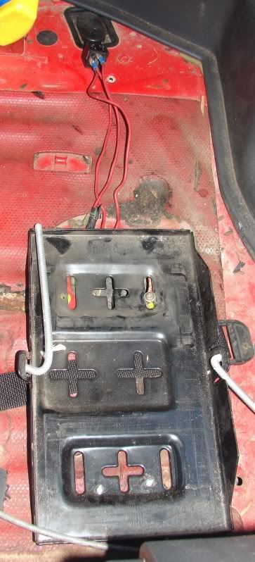

Here it is again, but with the trunk board I cut out for it. It previously didn't have a trunk floor. I am going to try to get a custom carpet made to work around the battery.
Here's a shot of the whole thing (without the board). Tomorrow, I am going to get the battery in there, and see if I can burn this car down. I might ought to at least cover some of the cut wires with e-tape.

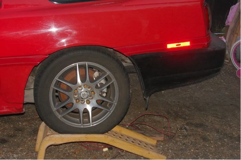

This is how the car will look for quite a while. It is only missing the front mud flaps, and putting together of the front bumper and related parts. I'm waiting until the motor is in for the front end, so I can snatch it off and use the extra room.

I definitely think it is going to be too damn low once the motor gets in it. I lowered the car down off the ramps with my jack under the rear end, and I had to break out the tiny jack to lift the car off the jack to get it out. There's no way that my low hanging exhaust is going to work under that.
