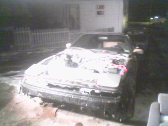

first supra, 3am freezing weather snow on the ground, me and my friend Jon are putting a motor in :naughty::naughty:
Scott snow is something that makes working on your car really difficult, but you should never stop working on what you love :evil2:

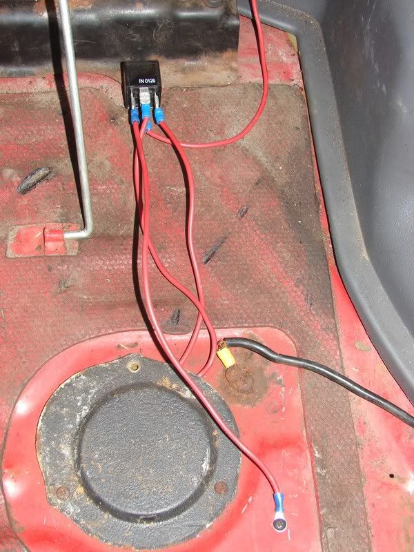

Here's a picture of how I mounted my fuel pump relay. I think I'm going to have this area painted when the car gets painted.
Scott, I would be concerned about the 2 wire coming from the fuel pump rubbing on that cover plate and creating a short,and you might want to sand the area around the ground to make a longer lasting ground. Just my 2 cents. John

i don't ever see pics of people working on their cars in the snow.
maybe in the garage while it snows outside.
This is at 3am in the morning, :icon_razz that white stuff on the ground is snow...
hell my red one, again me and Jon worked on in the rain! when i first brought it home engine was disassembled and i wanted to hear it work :) ... So you guys should have NO excuse for not having updates and pics.... except maybe having a life than your forgiven :sarcasm:
Id get that ground fixed up as well, maybe remove some of that rust.
55
Scott, to hell with them.........if you want your car to catch on fire, that's your business.
noah89t;884873 said:
i agree with suprahooked, and possibly remake that other ground
buckshotglass;884885 said:
Yep, what they said. That's a fire hazard. I would protect the relay a little too. The carpet will pull those connectors off someday.
LEAVE SCOTT ALONE!!!

agreed. You might be better off to drill another hole close to the cover and use a hole grommet so there is no danger of those sheaths on the wires rubbing through.
that'd be too much work for me id just drill a hole in the cover it self.

John.......Thanks for noticing what yoiu did! I think that's the point of a build thread, so we can all look out for each other. I have been busy writing my how to, and editing pics for it. And then I had to figure out how to get it posted. I'll finish it tonight, and hopefully it will all be there by tomorrow.
