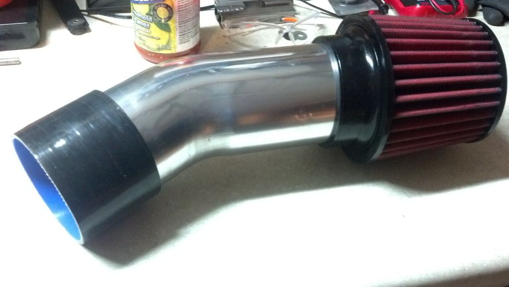

I'm not sure you guys have the room but i am using a Napa 6637 dry filter. its large but is thick and reasonably priced.
cross referenced the part numbers too in case you have connections through other avenues
ACDELCO A1474C
AIR REFINER ARM08-5011
BALDWIN FILTERS PA2818
BIG A 94637
CATERPILLAR 3I0003
CARQUEST 88637
CUMMINS 2912986
CUMMINS 3912020
DONALDSON B085011 H
DONALDSON ECBO85011 H
DONALDSON ECB085011 H
FLEETGUARD AH1141
FLEETRITE AHR81141
FRAM CA6818
GFF AF359214
GENERAL MOTORS CORP. 25177209
HASTINGS PREMIUM FILTERS AF2329
HERCULES B085008
KRALINATOR LA1458
LUBER-FINER LAF2533
here is a picture of mine, this was mach up before making my mounting brackets but you get the idea on the size
