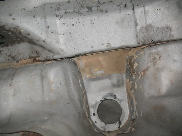

The rust I have found ...rear right
...rear left

Found a bit more rust

Marked some rust to cut away
Removed the fuel tank
Cut away some rust

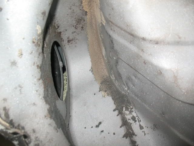

The rear right wheel house is alot cleaner

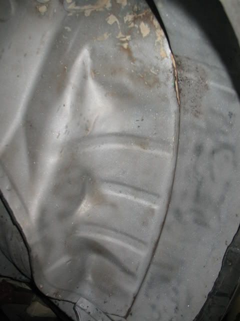

Found some more rust
Label off work done on the right and still working on the left side

This time it was time to do some in the rear left wheel house.
I started with a heat gun and something to scrape with, then I use the grinder with a wirewheel.
Pictures:
One of my favorite tools
The rear left wheel house looks a bit better now

Today I worked some more on the rear left wheelhouse, most of the undercoating is gone there.
I also cut away some rust that I will weld the next time I'm there.
