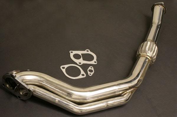

I decided to go ahead and be the guinea pig for the eBay DDP... For those of you who don't have patience to read / look further, I advise AGAINST purchasing one of those $199+$73 shipping ones (or similar).
First off, I purchased mine from optionautoimports. I believe he has another user name as well, but I could be mistaken... Either way watch out.
This was the image he had in his auction:
Looks familiar doesn't it? If not, check out the 935 Motorsports homepage, it's the exact image they used...

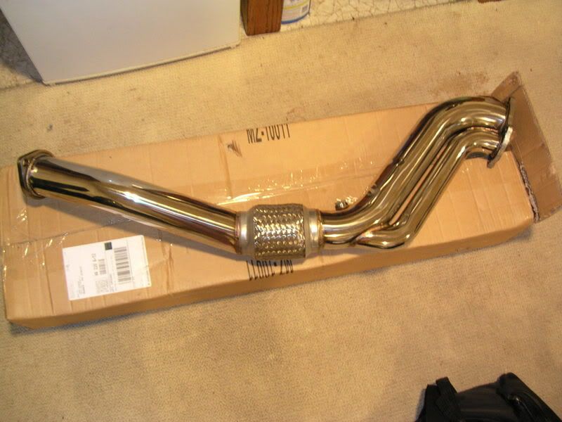

Well, here's what I got:

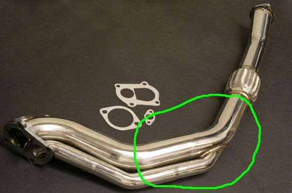

Here's what I didn't get:
See the difference?
Yeah... The angle is wrong and it's around 8" too short to reach the cat in stock location... I believe the angle is workable if one really wanted, but it requires removing the plate covering the speedo cable and relocating the cable itself up into the channel beside the transmission... But even if you solve that, it's still useless unless you do custom piping back...
Fortunately the dude who sold it to me seems like a legit fellow... I called him up and explained the situation and he seemed genuinely surprised and offered to take it back and refund me in full. I saw that he had sold a few others previously and had positive feedback from them, so I am wondering if this was a legit mistake or if the people who purchased them either didn't have the balls to step up or managed to modify their exhaust to make it work...
Moral: Just spend the extra $60 and do it right the first time... I'm about to order a new one from 935.

I can't see the images you posted, but I probably know what happened. There is an MK2 version of this downpipe. It is much shorter to compensate.
You probably received that one. The thing is the seller tends to not know the difference and assume that they are all the same.
I am basically selling what is on eBay, so I don't want to mislead you that I have something different. I am just making sure that people get the proper item and offer warranty. I'm glad the eBay guy took care of you because that usually doesn't happen.
I am getting more this week and will make sure they are all correct.

935, I understand you are selling what is on eBay, that is no problem and I am not mislead. I am a bit confused why a MKII pipe would have a divorced wastegate section when the MKII did not have a turbo though... but that's a different issue. The images are linked from Photobucket, so per haps your office filters that site?
It's obviously the wrong pipe, but I wonder what it is for... It ALMOST fit angle wise, but was still a no-go.
The eBay seller, to his bahalf, IS going to refund me my complete purchase price, including the $73 shipping, so I'm only out the $13 it's costing me to ship it back. $272, even with that shipping, was an unbeatable price, but this wrong item cost me a lot of wasted time and effort... I also layed into him pretty hard to get this refund (although I remained polite and polished).
