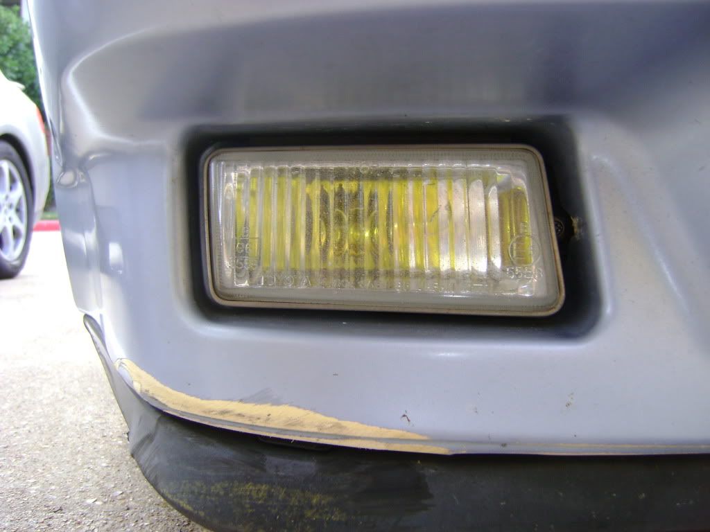

JDMMA70;1617566 said:
Here are my Pre89 Fogs.
[thumb]http://img.photobucket.com/albums/v436/Cobra281s/JDM%20Supra%20Foglamps/DSC01921.jpg[/thumb]
What's causing the yellow? Doesn't look like it's the bulb itself but I haven't looked inside these so i can't tell.
Either way, what bulb are you using?

Fog Insert Capsule. Its basically a bulb ballon that incases the bulb. The capsule itself is yellow. You can fit them in Pre89 lamps, my particular set are JDM

Just use inserts from a Lexus..
I had those bulbs in my 89 and they're no where near as yellow as my Lexus inserts
you can buy some off of me, or find some in the junk yard, ES250s and LS400's should have them..

yup lexus fog light capsules, thats what im using too, they are pretty much plug and play IIRC, even if not i remember it was really easy to install

for 89+ they screw right in, you just need to ground them (I wrap a wire around one of the screws and use a spade connector to plug into the stock ground)
or pre 89 you cut out the capsule from the cage, pop off the back of the foglight housing, slip it in and close it up..

With a 89+ Bumper and Fogs like RazoE said they screw right in. You also have the option of making them Euro Spec or JDM Spec easier. Simple difference one has the Blinder Shield on it the other doesn't. 89+ have the shields on the insert itself. Pre89 Lamps are riveted in place on the inside of the lamp.
