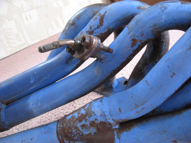

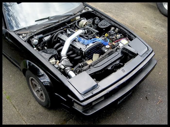

Someone in WA should bring their piggy over here and test fit my TRUST header and see if it fits the 7MGE w/o issue. They're still being made by TRUST, but are expensive at $500.
They look the best though IMO :)

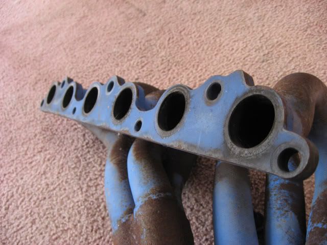

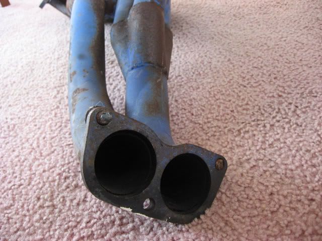

It was a little bit, but worth it. It has 1 5/8" primaries, larger than the Pacesetter I know that.

DegreE;1062981 said:
^^ That looks like a pain in the ass to install.
^^^wimp. :icon_razz

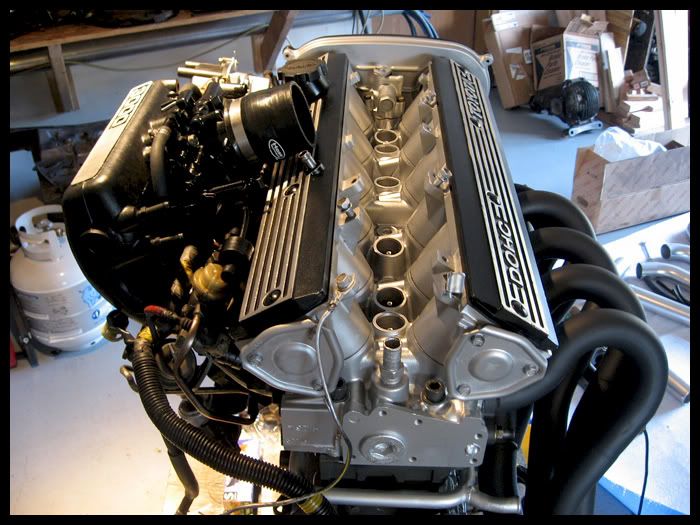

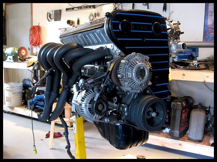

My question about that particular header would be is there a collector for it that would bolt up and end anywhere near the MKIII's cat?
EDIT: Hell, will it clear our distributor? I can't tell from any of the 7M-GE pics I have.

CRE, yeah that's one of the potential issues w/ this header, is the dizzy. I have no experience with 7Ms at all so I don't have a clue.
Also, the whole exhaust would probably need to be redone for the collector to work. I have heard of some mk2 peeps running mk3 exhausts, but no idea wtf they did to make it fit.

To me it looks like it would clear the distributor. I think the O-2 bungs look a little too close to the head though. I think they should be moved to the collectors farther down stream.

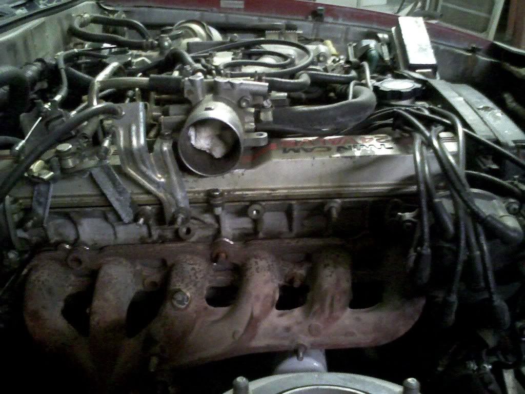

found a good exhaust/dizzy shot of the 7M,
from this pic it doesn't look like the TRUST header would be an issue,
the #1 primary stays pretty low
edit*
AJ, yep. Look at the first pic I posted again. You'll see an addition on the first set of collectors, an O2 bung has been added for future wideband use. I have been using the original O2 bung though... was getting O2 sensor codes under hard acceleration UNTIL I changed from the 5M ECU to the 6M ECU

Yeah I seen that Tanya, I would still think it should be even farther down then that. Those tube get HOT. :)

Trust's site says steel, but doesn't specify if it is mild or not, I assume it is though. Although it is a bit heavier than the Pacesetters I believe. I was always under the impression that you want the O2 sensor fairly close to the heat source, not too close or far away, which is why I chose the location for the wideband bung.
Here's some pics of it when we first got it:
